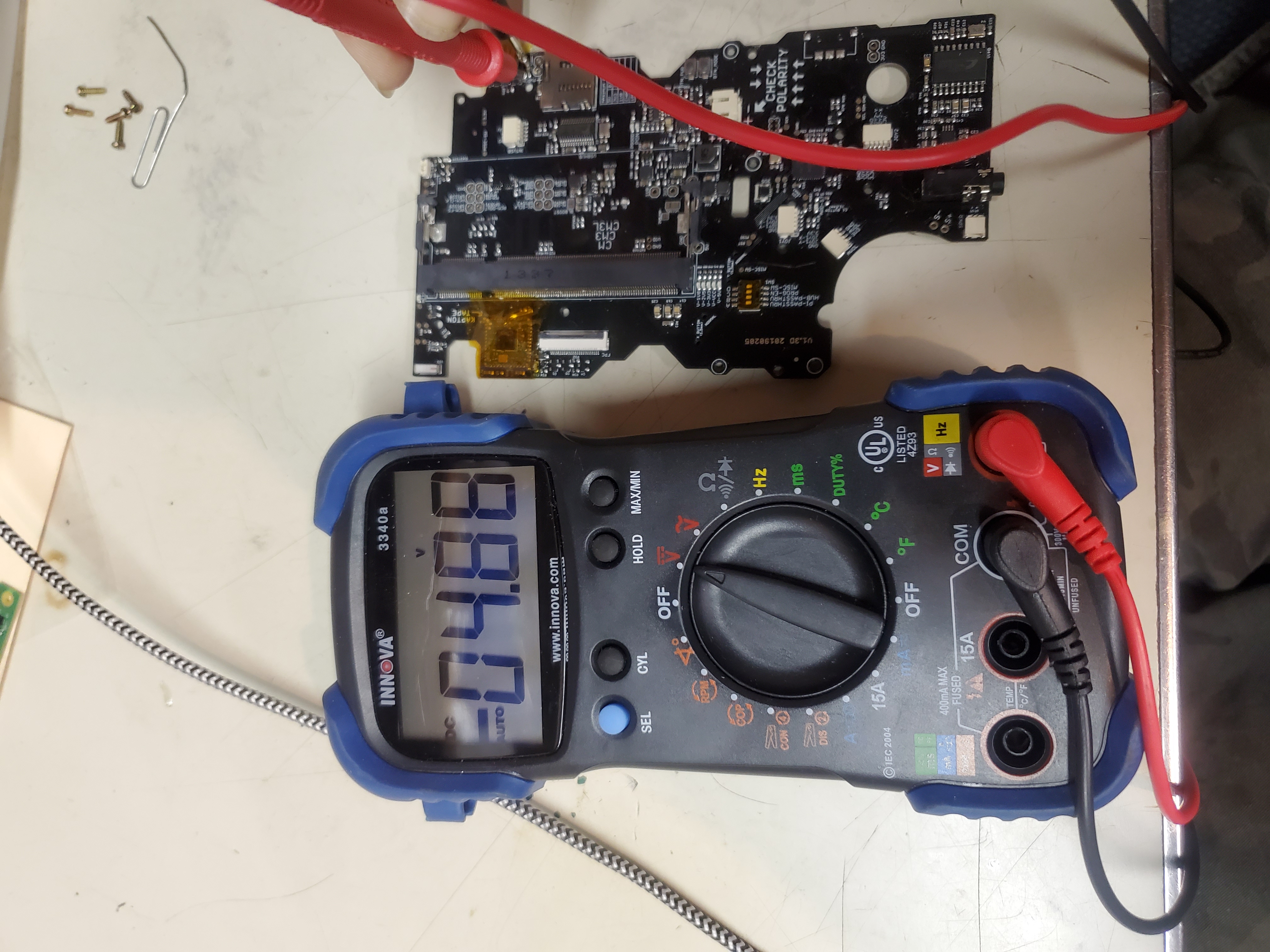

Hi could you show a picture with it plugged in? Do you have a multimeter/voltmeter and are able to measure the voltage at the capacitor right next to the USB C connector?

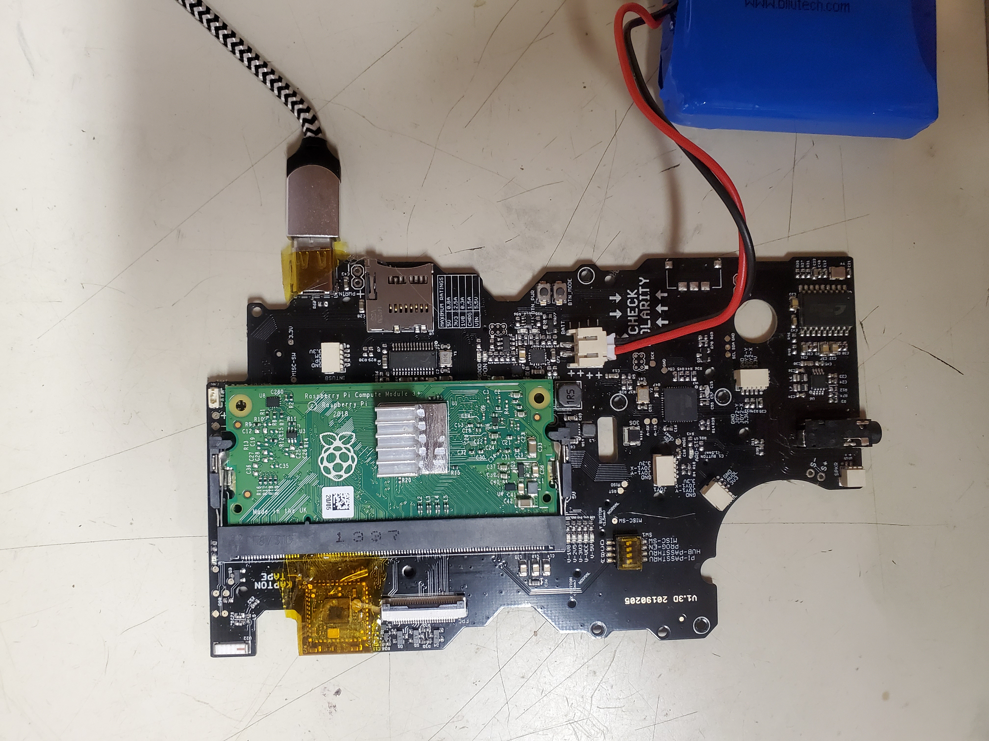

First picture (these may be posted backwards mind you) is the bare board plugged in. Second picture is with the battery added just in case, but 0 change to the board. I have plugged it into my laptop, and still no change nor did the laptop even notice anything plugged in. Also pic added with the meter testing the capacitor.

Re: No power/No charge
Hm, nothing obvious wrong and it's getting power in as you have shown. The magic all happens in the charge IC which also passes the power through to the rest of the board.. i imagine that is gone.. if you send me an email, i'll repair it for you
