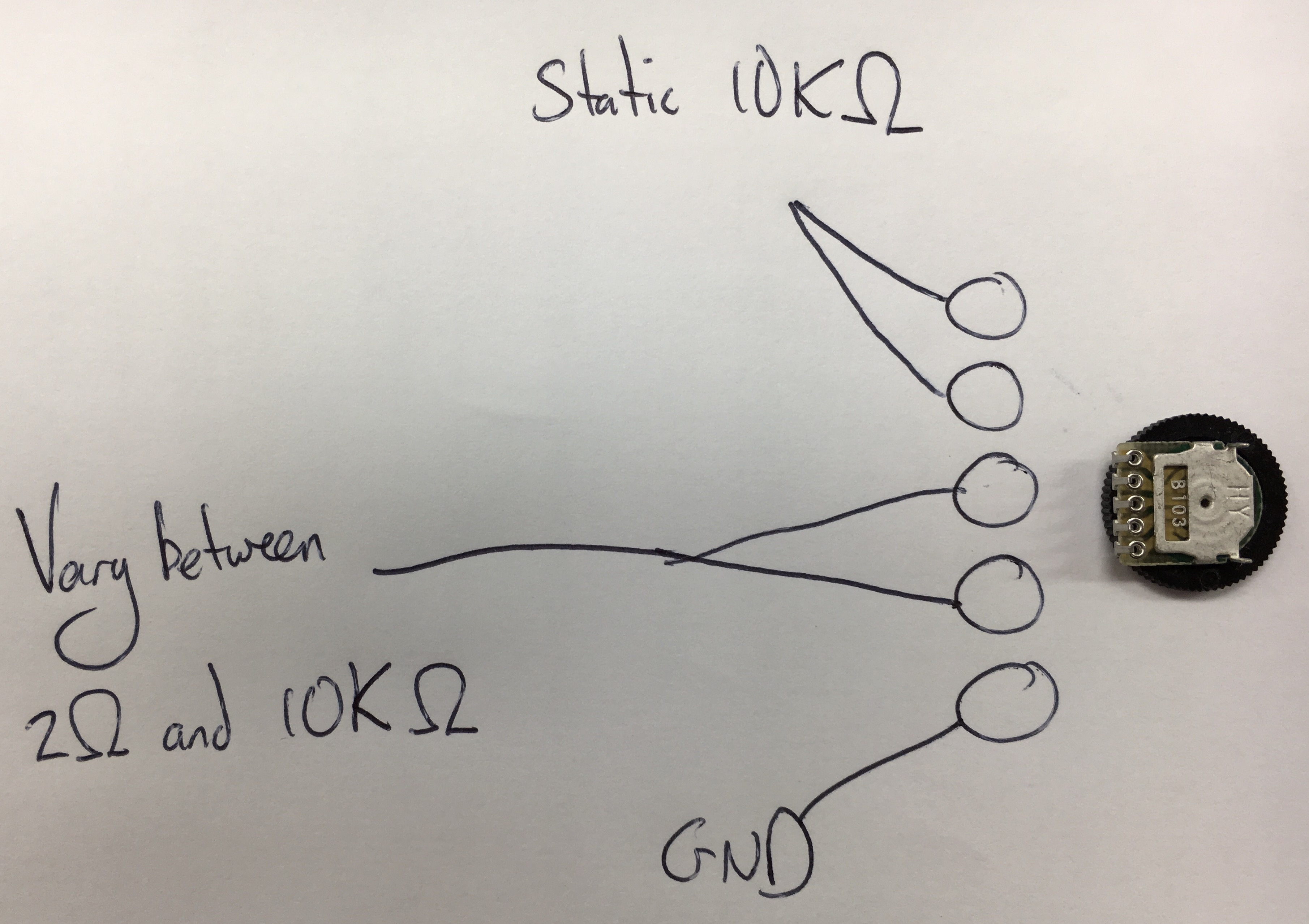

I've tested a new one today. It's just a cheapie pack of 5 from china so there's no data sheet. I've attached an image of the results, I'm sure ground is in the right place as I took it apart, are the in's and out's in the opposite place?
Edit, jesus, what a rookie mistake. Even though I thought I rewired 1 pin at a time, I did it completely backwards. Works fine now, oops!
