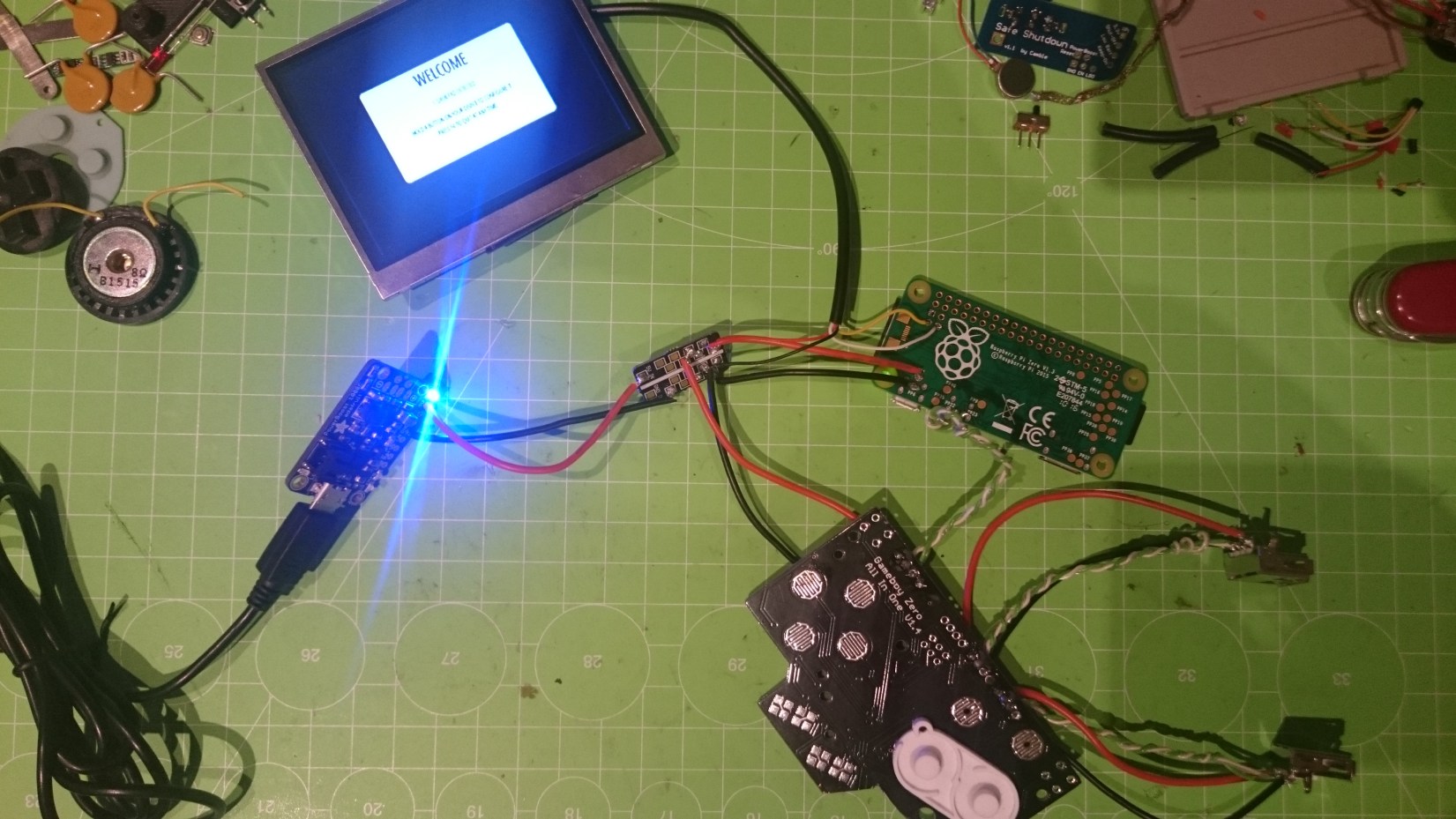

So I started seriously my build and wired :
PB1000C to Power Strip
Screen to PowerStrip (and video to Pi 0)
Pi 0 to Power Strip
AIO to Power Strip and to Pi 0
twisted all the usb white/green wires from AIO.
I turn it on, it runs, get to the Welcome Screen asking me to config my stuff :
Turn off, plug in a usb keyboard, turn back on, screen gets all weird and glitchy (like in movies with hackers cliché), and endless reboots.
Keyboard is not detected.
And when I also have the wifi usb key with keyboard, it doesn't reboot, doesn't glitch, but nothing happens, keyboard still not detected.
Any advices ?
Thanks a lot !!

Post by Helder » Sun Oct 02, 2016 4:53 pm
First post explained how to get wifi working but just solder a wire to each of the 22 ohm resistors. They are the located right above the atmega32U4 chip on the far right of the components there.

No that was not for you. the 5V shows the hot and black is ground. The diagram was to completely bypass the USB hub all together. This would render your other usb ports inoperable since they won't have the data wires going to it. Things would power but not do anything else. This diagram is for people not wanting to use the other usb ports on the board.
