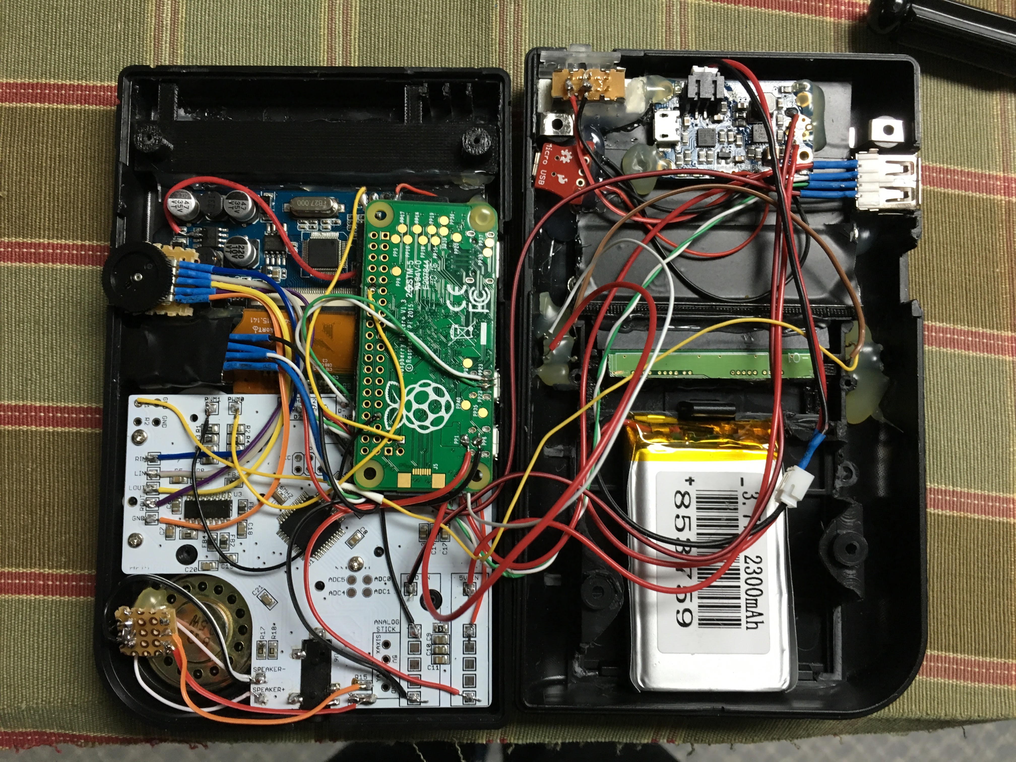

@Helder I've got everything working now, thanks to your help. I bought some shielded wire and used it for the PWM0 and 1 connections. This change, in combination with the new resistors did the trick.
The sound out of the speaker and headphone are good and consistent, just like my first GBZ build. GBZ number 2 is now complete!

Hi Xfcrowman - Do you mind sharing a picture that shows the final layout of your wiring and resistors in the working configuration? Thanks!xfcrowman wrote:@Helder I've got everything working now, thanks to your help. I bought some shielded wire and used it for the PWM0 and 1 connections. This change, in combination with the new resistors did the trick.

I'm at work now, but I did take a photo of the GBZ before closing it up last night. You can't see the resistors well (they're right on top of the speaker, unfortunately), but the mini-board I made was pretty basic.144TECH wrote:I like to see that too, or a video from it.
I soldered the two resistors to the perfboard - one side of the resistor went to R15 or R16. I used solder to combine the other two sides, and then ran a wire from there to "Speaker -". Hopefully this makes sense. I will try to take another photo later tonight, but then I will be giving the GBZ to my brother-in-law: it's a gift from my sister to him
- IMG_1419.jpg (2.59 MiB) Viewed 9626 times

Makes sense. I'll give it a shot and report on how it works out.xfcrowman wrote:I'm at work now, but I did take a photo of the GBZ before closing it up last night. You can't see the resistors well (they're right on top of the speaker, unfortunately), but the mini-board I made was pretty basic.144TECH wrote:I like to see that too, or a video from it.
Also, I noticed your pic shows power supply to the Pi comes from the row of power pads at very bottom of the AIO. Is there a benefit to using those pads instead of how it's shown on Helders wiring diagram, using the pads further up?
