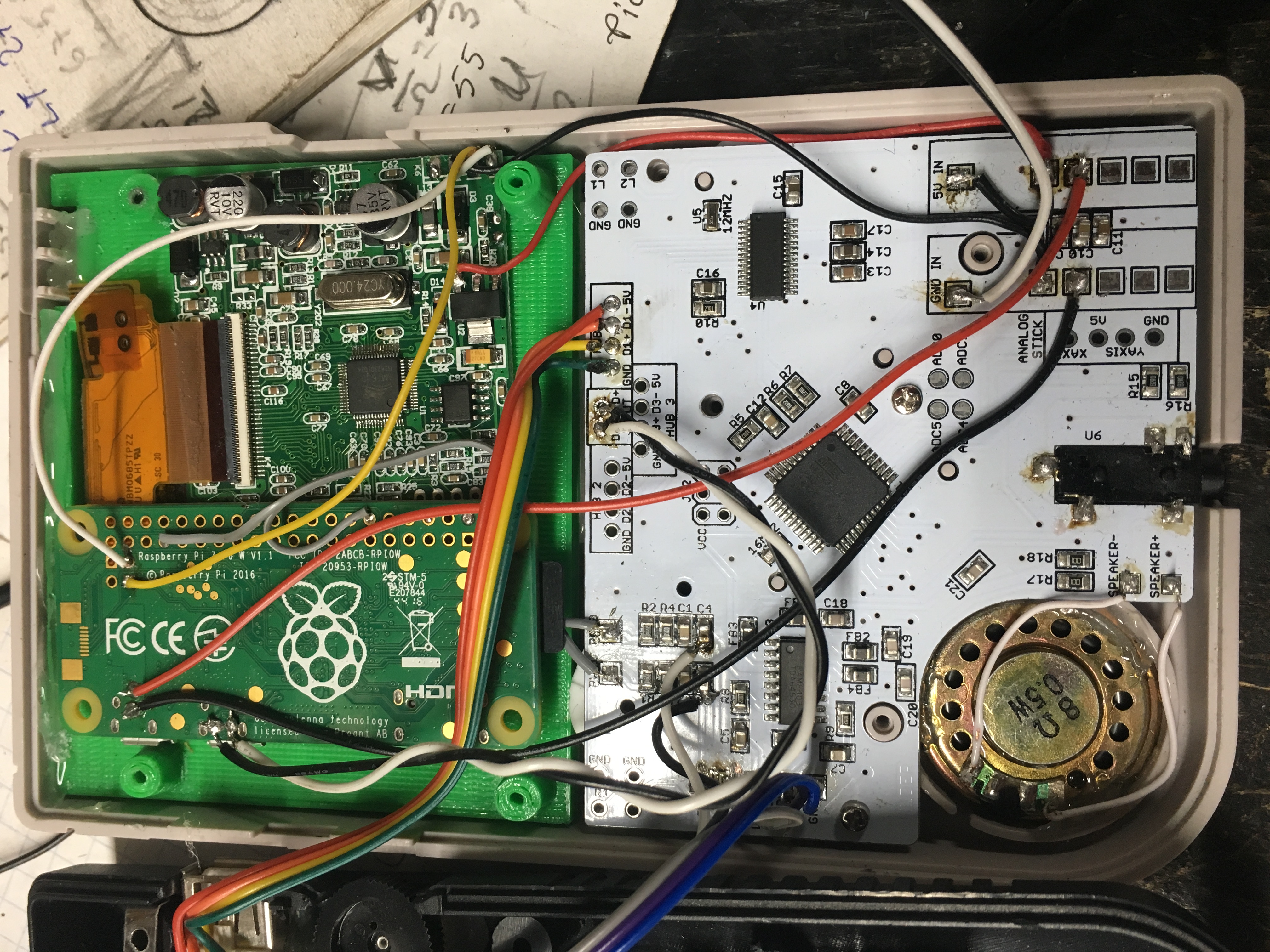

Hey I'm having some trouble getting the gamepad to connect checked all my wiring and have a fresh download on my sd I'm using a pi 0w please help me if you can I know it's been explained before on this forum but I am having trouble navigating the feed with all the different pages and all the different versions of the board hopefully I don't make myself look to stupid...
I did resolder the d+\- cause it didn't look like a good weld

Default answer is going to be to hook the board up to a computer. It should show up as a gamepad. You can cut up an old usb cable. Hook the green and white wires up to the main data lines and the red and black from the usb to the power strip on the board.

are you sure you've checked your solder joints..... the connections at the pi zero end looks a little suspect (could be the view)
id make sure nothing is being bridged there
Yeah it's just the angle there is a visible gap but since you said it a checked with the meter no bridge :(

Yeah I did that and it didn't show up on my computer

First and foremost is to hook it up to a PC as mentioned above and see if there is an Arduino controller in the Devices screen where normally printers are.
Second I notice you have burned a pad or 2 which I circled in RED which I suspect (you will have to check) that you might have burned the annular ring circled in BLUE. The thing with this ring is that the trace to the USB gub is on the back end of the PCB and if that ring is burned off on that side there is effectively no USB connection being made. I've seen another user with a similar situation (if this is your situation) that the back annular ring was missing, so check that also.
If the second paragraph is your issue then you can solder a wire to whichever ring is burned to the following traces:
