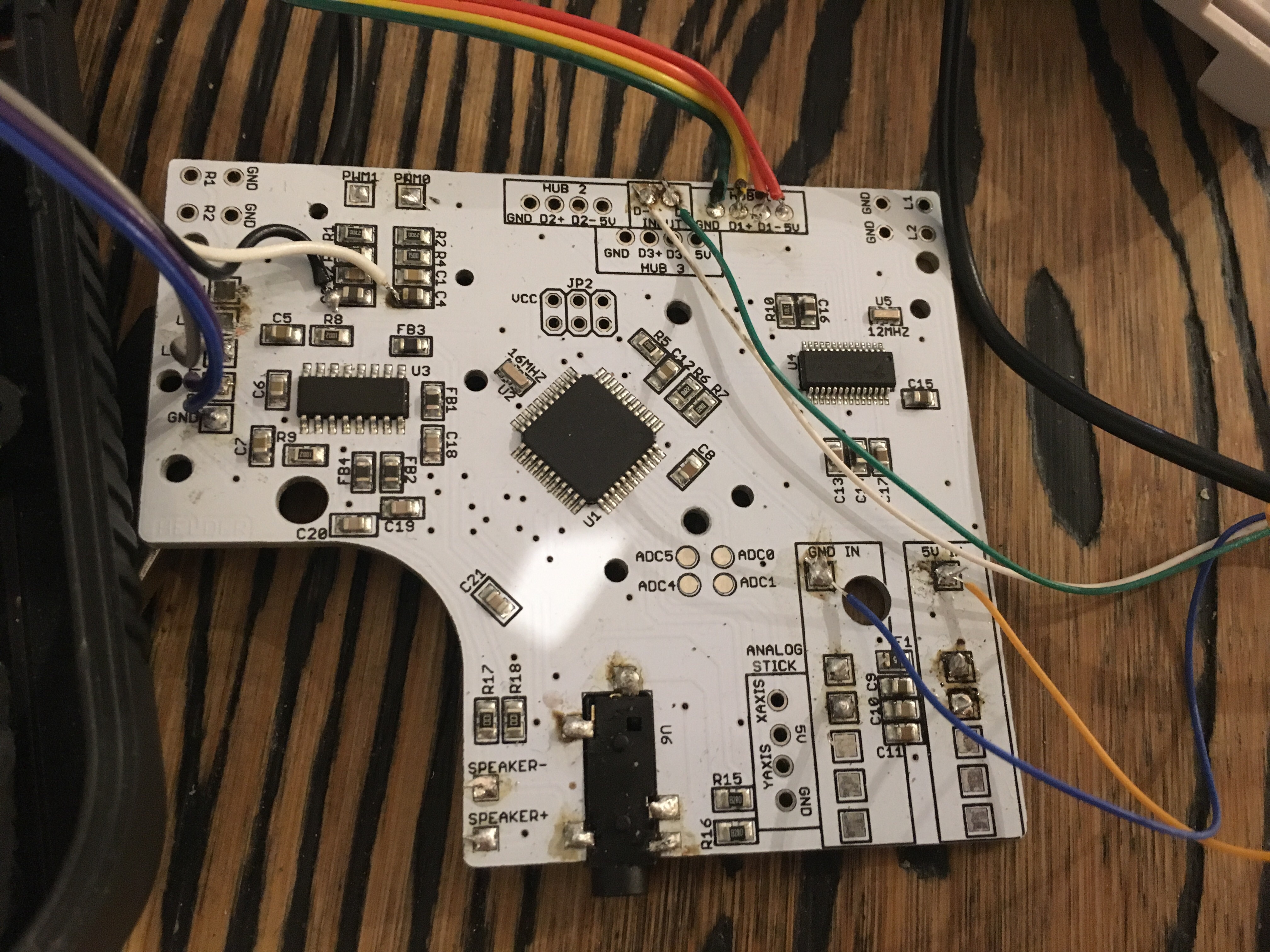

Helder wrote:
Wed Apr 26, 2017 4:38 pm
Jmags1700 wrote:
Wed Apr 26, 2017 2:18 pm
Yeah it's just the angle there is a visible gap but since you said it a checked with the meter no bridge :(
First and foremost is to hook it up to a PC as mentioned above and see if there is an Arduino controller in the Devices screen where normally printers are.
Second I notice you have burned a pad or 2 which I circled in RED which I suspect (you will have to check) that you might have burned the annular ring circled in BLUE. The thing with this ring is that the trace to the USB gub is on the back end of the PCB and if that ring is burned off on that side there is effectively no USB connection being made. I've seen another user with a similar situation (if this is your situation) that the back annular ring was missing, so check that also.
If the second paragraph is your issue then you can solder a wire to whichever ring is burned to the following traces:
Yeah your right i used a soldering iron that was cheap but after I burned two pads I stopped and got some lessons from a friend and got an adjustable soldering iron I did a continuity test and D+/- are still good is there anything else I could test it on maybe I did something wrong when I tested via USB with the computer
Here's how I set up the USB
Post by Helder » Wed Apr 26, 2017 5:29 pm
When you plug it into a PC it should detect new hardware, if it gives an error try swapping the green and white wires. If no devices show up (it should have detected atleast the usb hub) then we can discuss a fix or replacement over a PM. If it does detect both the usb hub and controller then all should be fine.

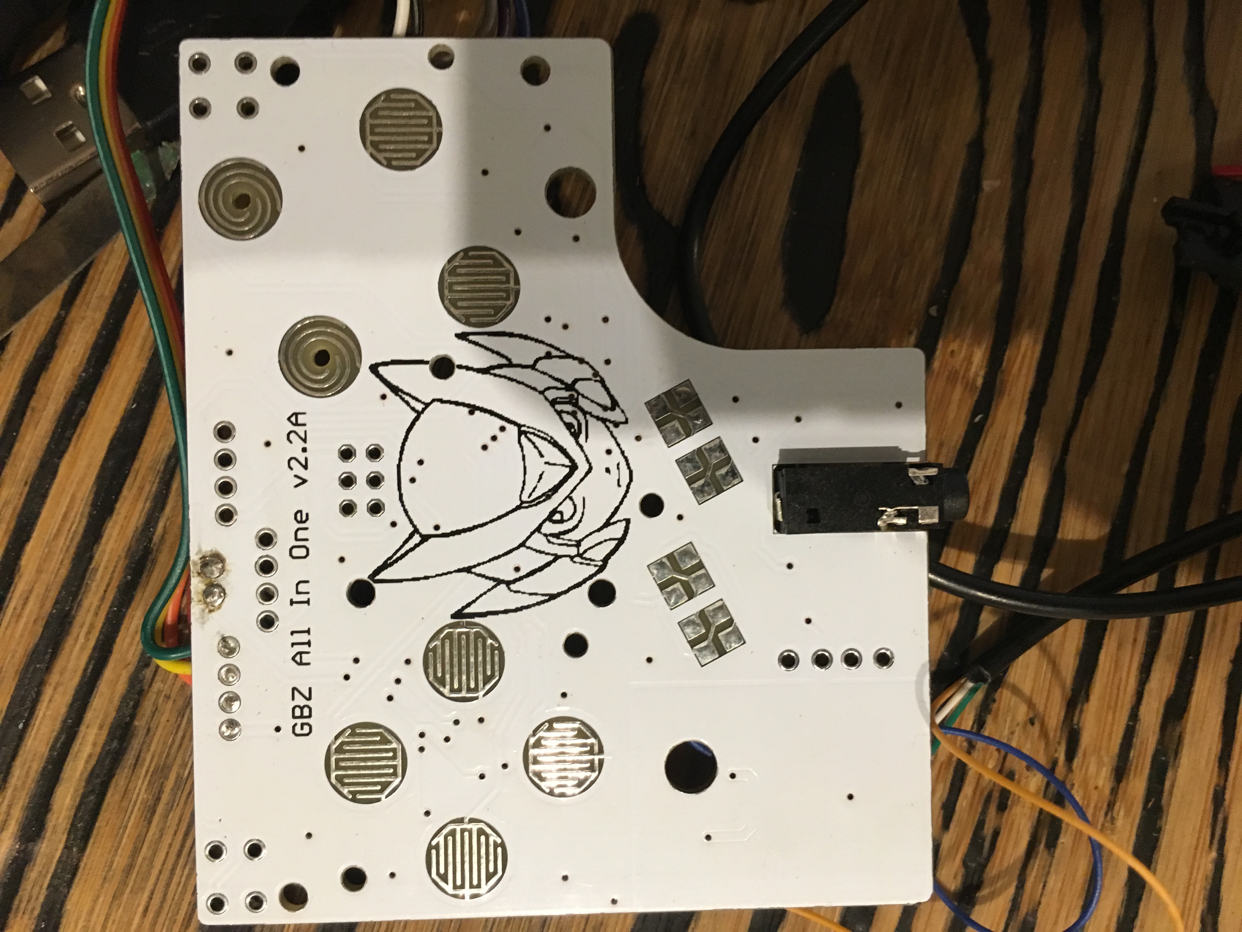

Can you take a photo of the other side of the board where the usb solder holes are?

Post by Jmags1700 » Wed Apr 26, 2017 5:53 pm
still nothing not even the USB hub is but I didn't get any error code or anything either
Here's the back
