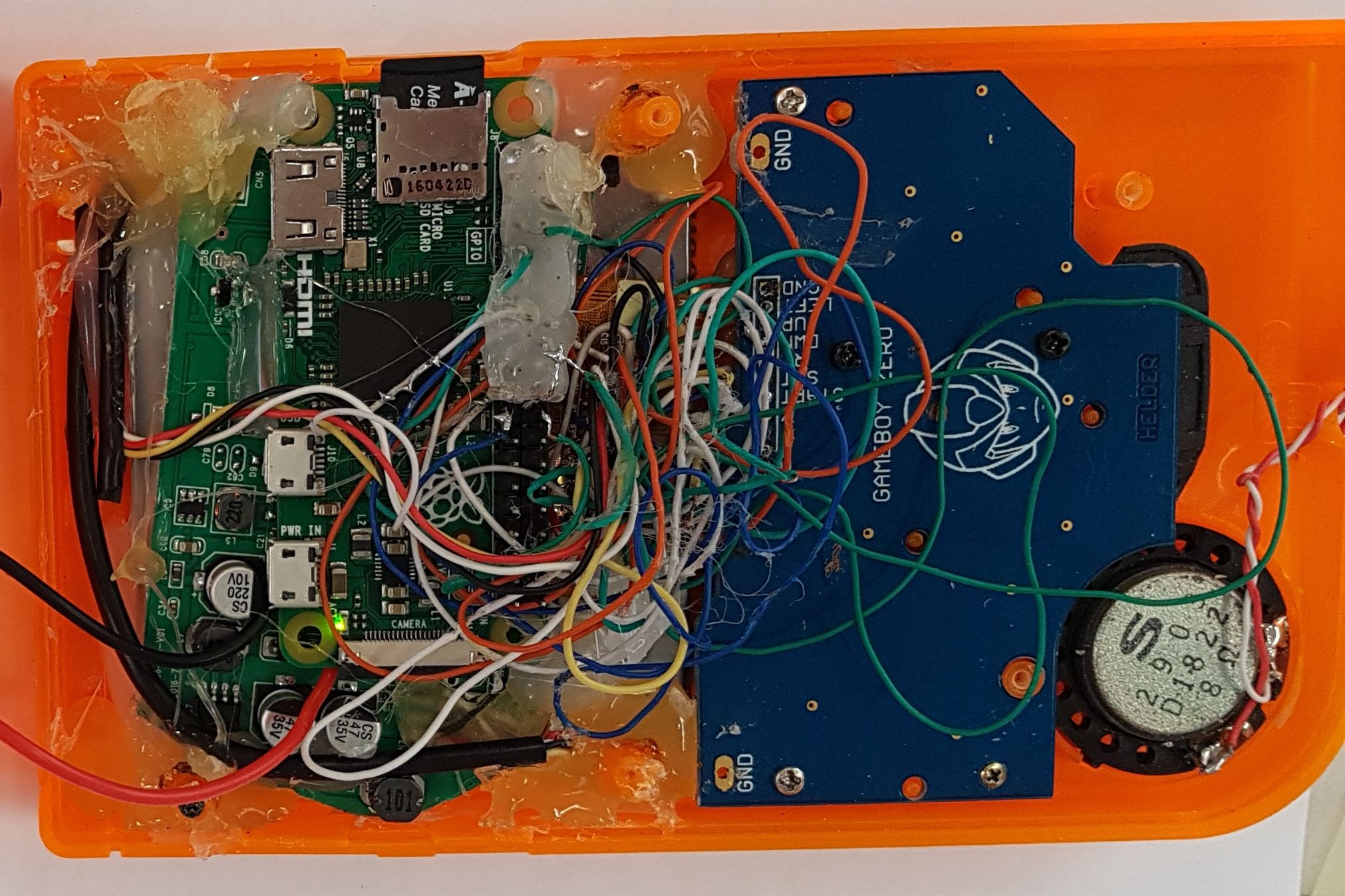

Hi there, i buyed a Gameboy Zero - Set on Ebay. The Seller uses the first PCB from Helder.
Everything works fine, but i miss the shoulder-triggers for snes-games an there is no speaker.
Is it possible to do something against the problems with pcb 1.0?

F****. It was a cheap Buy, too cheap. It was very bad soldered. The Gamepadwire for (UP) loss conection. Do you have an "PCB to GPIO" wiring-Picture? I don't know where to solder.

Both relatively easy fixes in their own right, however skeptical that there is no speaker ...any headphone jack?
Do you have any pics you can post?

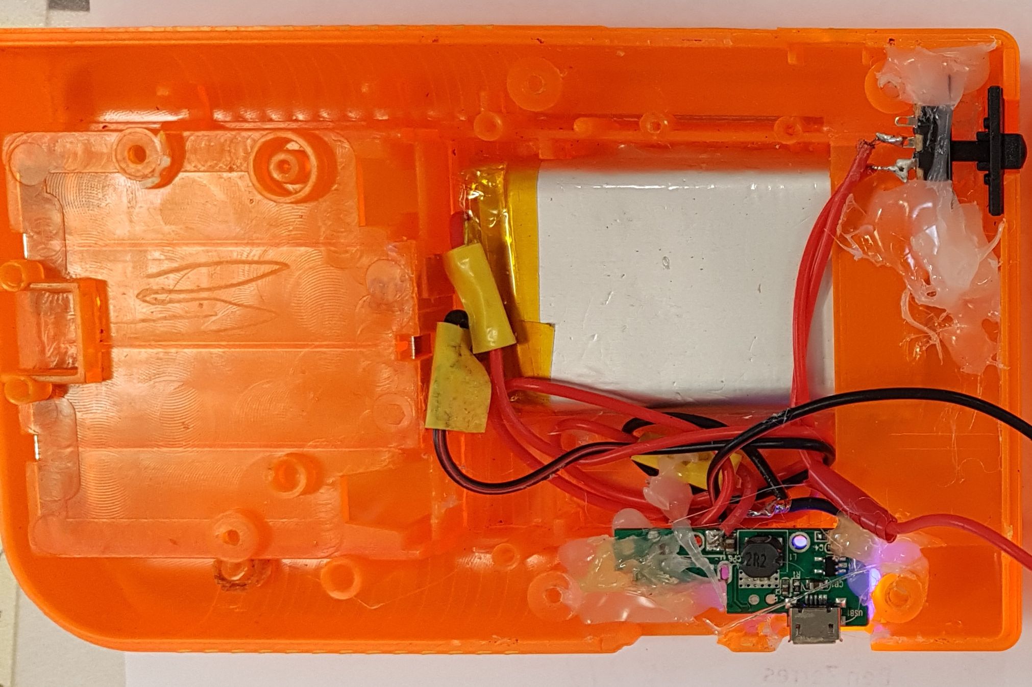

As you can see- no headphone jack, just an unwired speaker.
- 02.jpg (334.33 KiB) Viewed 20336 times
- 01.jpg (436.78 KiB) Viewed 20336 times
