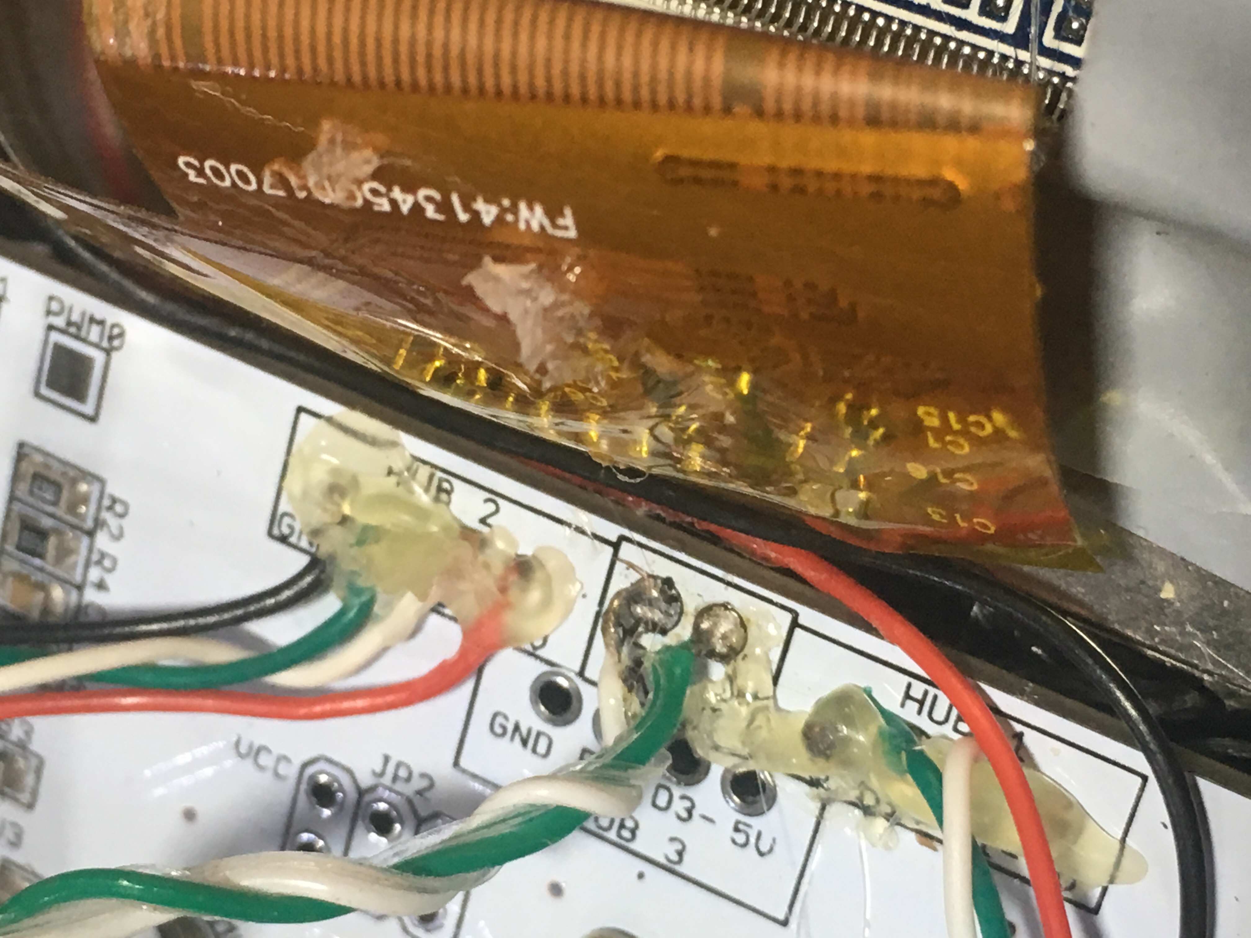

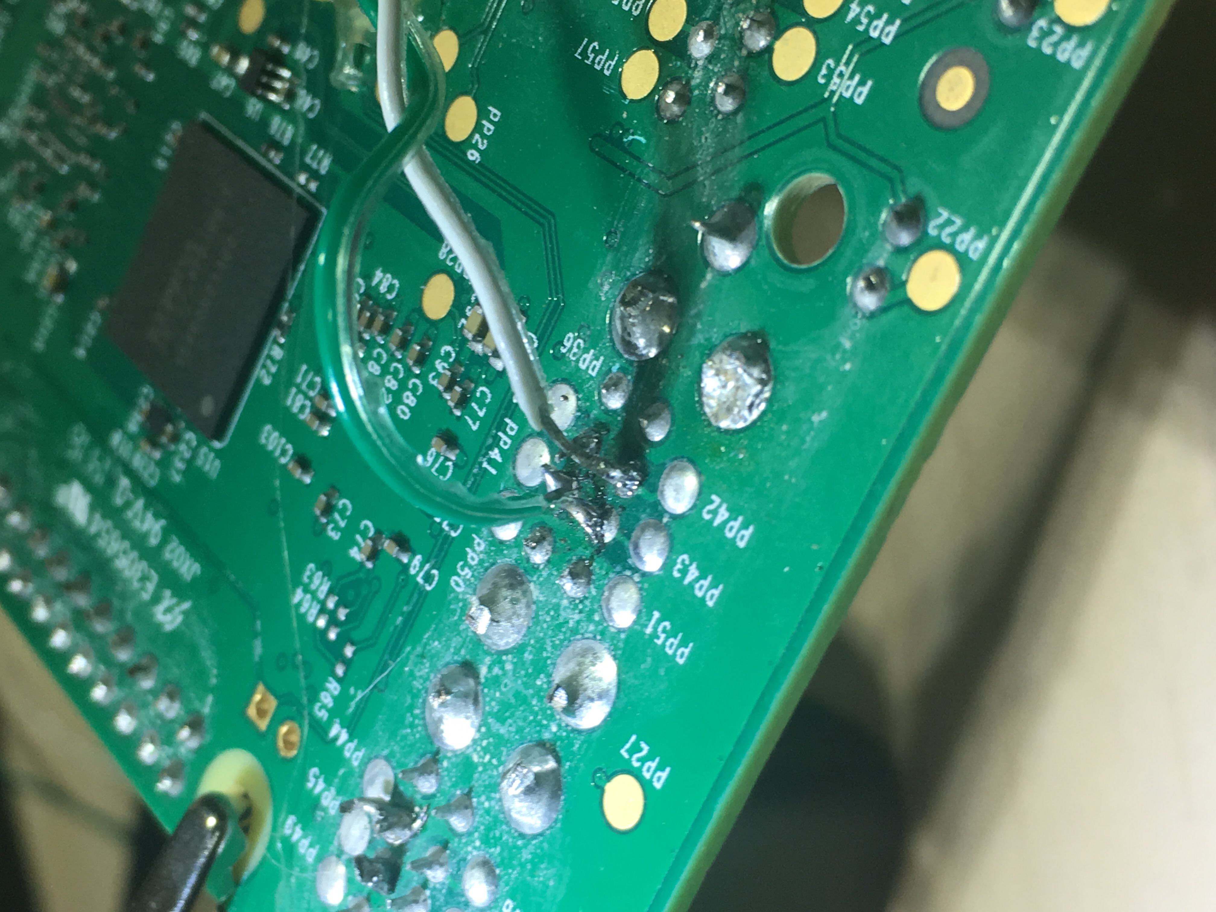

So I’ve almost finished a Pi3 build of a gbz yet I can’t get the game pad to be recognised and USB for the keyboard isn’t working so its the data wires between the pi and the board. I’ve got great solder points and on the pi and I’ve tried multiple ports on the pi yet it still doesn’t work.
If someone could help it would be greatly appreciated!

Do you have pics of you wiring of the data lines? That will help a bit.

Here’s the connections.
The should be fine as nothing has bridges and I’ve checked with a multimeter.
- image.jpg (1.36 MiB) Viewed 16857 times
- image.jpg (1.57 MiB) Viewed 16857 times

For anyone who has this issue.
I managed to find this forum post by Helder thanks toVoxrsfzzisf on the Sudomod discord.
If it doesn’t work check your wiring.
https://sudomod.com/forum/viewtopic.php?f=25&p=12203
