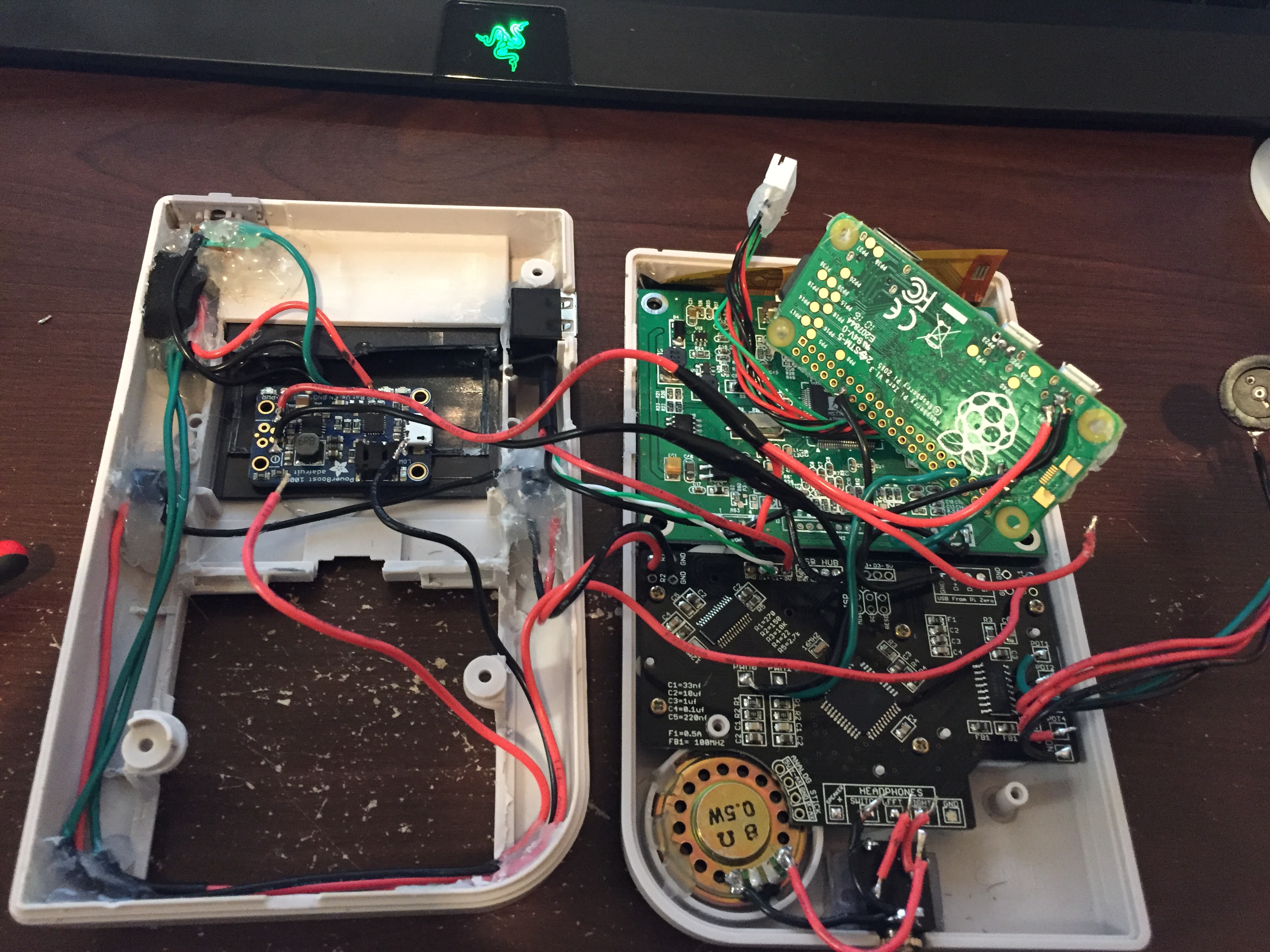

Anyone else having issues with the AIO that went out this week? I cant seem to get the USB hub to work. The PI is picking up the buttons fine but nothing I plug into the usb ports will work. I have it wired just like the diagram.

It's been mentioned a few pages back on what to do and also try to move the PWM wires away from the Hub chip (it's the one on the upper left side of the board).lookitsneil wrote:Anyone else having issues with the AIO that went out this week? I cant seem to get the USB hub to work. The PI is picking up the buttons fine but nothing I plug into the usb ports will work. I have it wired just like the diagram.

Ive tried twisting the wires, and setting the code to the USB 1.0 version. Im not using a power strip so Im wondering if thats where the issue is coming from. Im currently rewiring the whole thing to see if I made a mistake somewhere.Helder wrote:It's been mentioned a few pages back on what to do and also try to move the PWM wires away from the Hub chip (it's the one on the upper left side of the board).lookitsneil wrote:Anyone else having issues with the AIO that went out this week? I cant seem to get the USB hub to work. The PI is picking up the buttons fine but nothing I plug into the usb ports will work. I have it wired just like the diagram.

You need power to the AIO board from the powerboost or similar power supply. You can't power everything from the Pi as that can't handle the AIO itself and a screen.

Helder wrote:You need power to the AIO board from the powerboost or similar power supply. You can't power everything from the Pi as that can't handle the AIO itself and a screen.
right now I have everything powered from the power boost. I have the pi, the screen and the usb hub twisted together, than thats wired to the powerboost. The pictures a little ratty but maybe it will give you an idea of what Im doing. There are also data wires missing because Im rewiring the date off the AIO to the PI

First off you need to add power to the port on the far right that says USB from Pi Zero as well as GND although any GND point can be used but that one on the right has filtering that is needed.lookitsneil wrote:Helder wrote:You need power to the AIO board from the powerboost or similar power supply. You can't power everything from the Pi as that can't handle the AIO itself and a screen.
Second I don't see the D+ and D- on the far right labeled USB From Pi Zero connected to anything so of course there will be nothing working if it's not connected.
