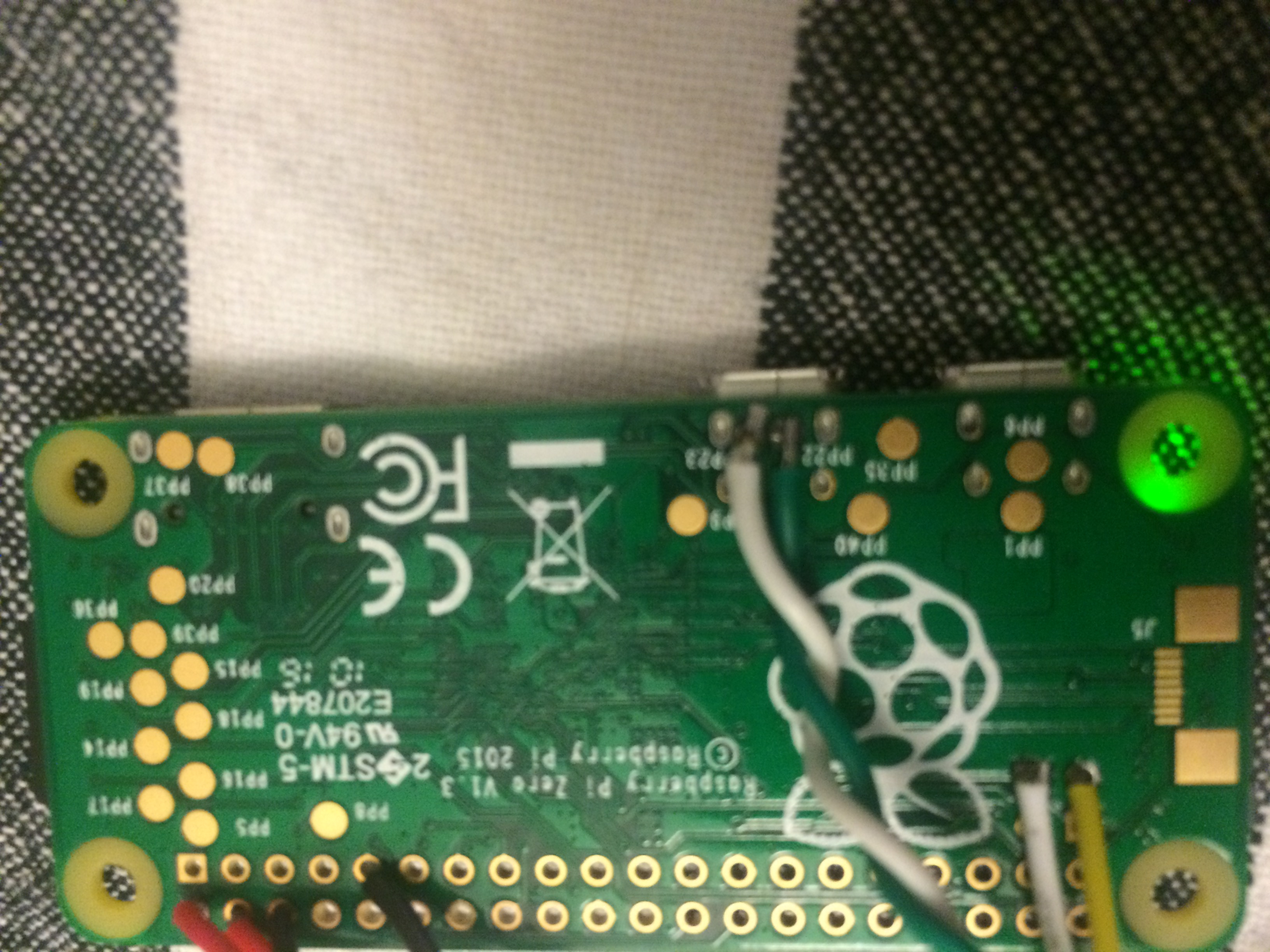

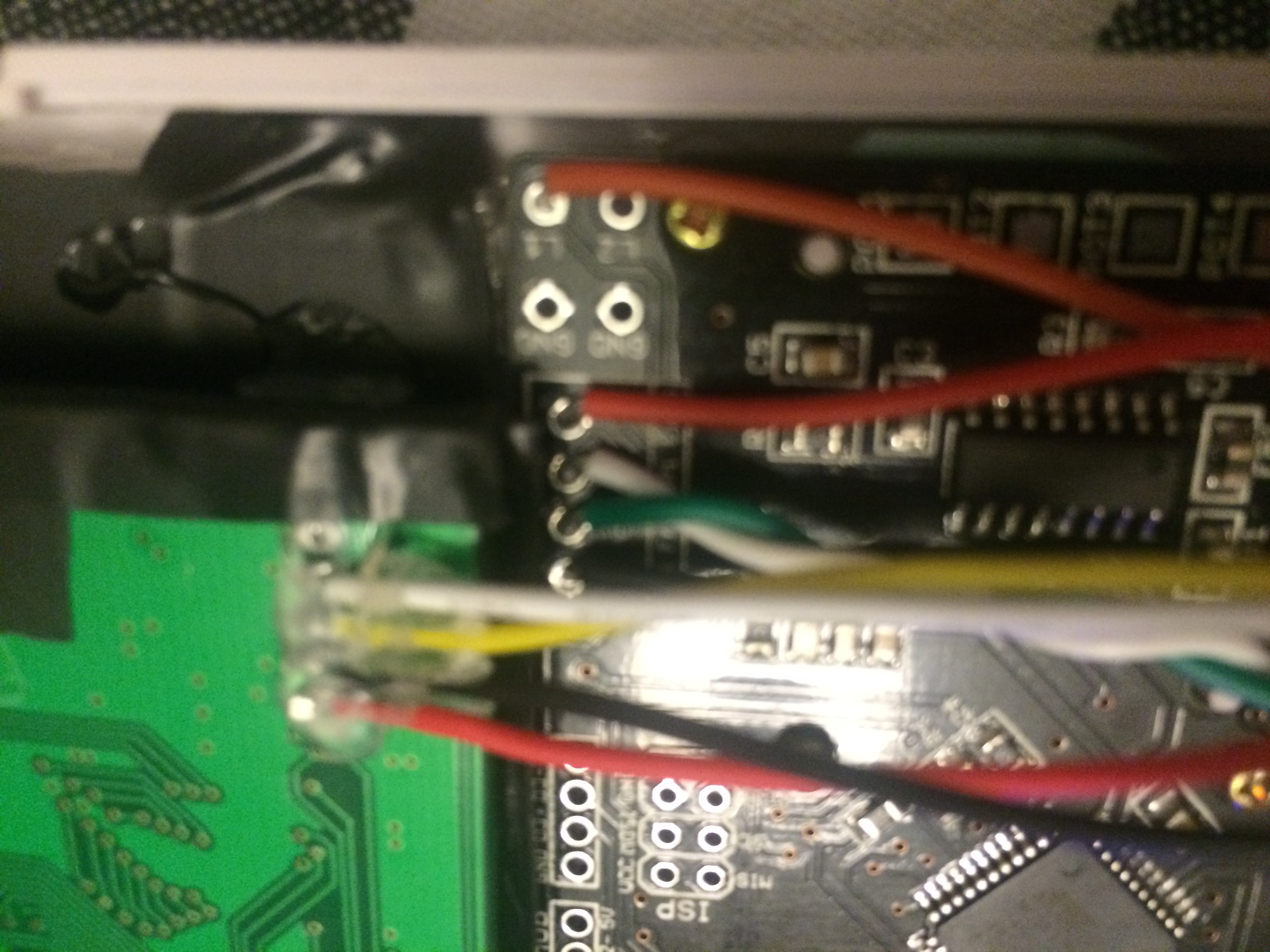

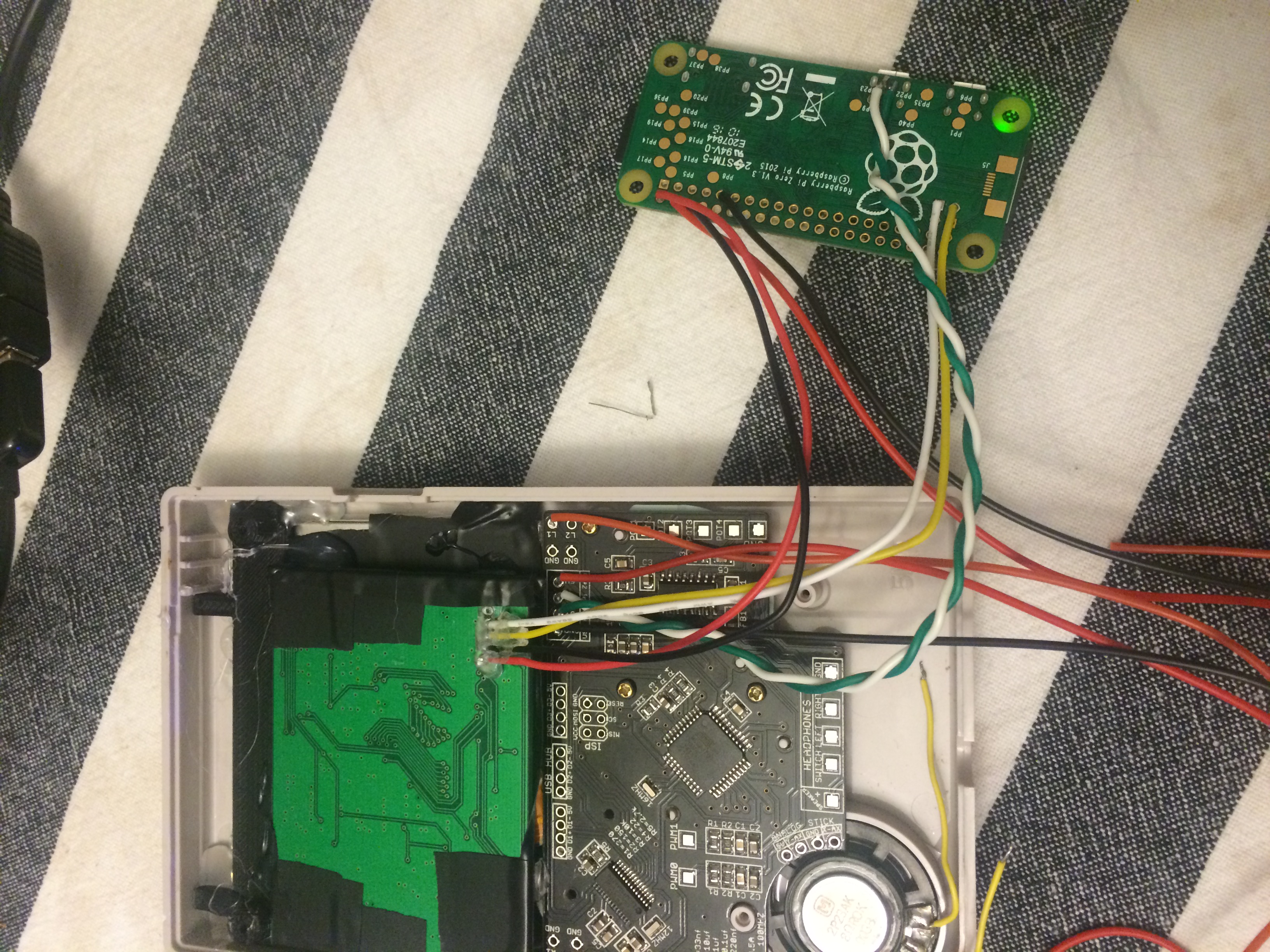

I can not get my aio to work.
I have wired it up to the pi D+ to PP22, D- to PP23. I power it from my powerboost but nothing is happening. I mesured so i know i han power to the aio. When a plugg a keyboard to the pi it all reboots and the keyboard dont work untill i remove the aio green and white.
Dont know what to do?

How do you have the 5V and GND connected ? are the GND connected to the AIO and Pi the same? Also be sure PP23 isn't touching that GND pad to the left of it.
Everything should be getting power from the Powerboost. This means screen, aio, and pi should have their power coming from Powerboost or a break out board. Use pp1 (5v) and pp6 (ground) to power to pi. Screen should not be powered through pi. Also it appears that you have both video inputs connected to pi.BempaG wrote:I can not get my aio to work.
