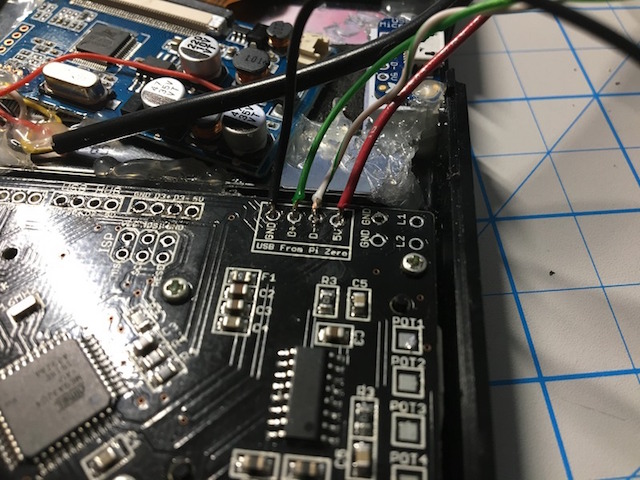

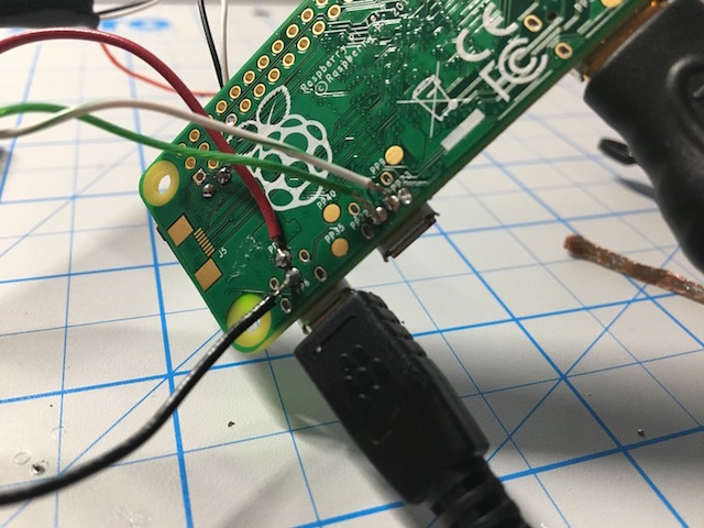

@Helder Today I tried a couple simple things. (All soldering verified to not be crossing paths with other connectors.)
1. Powered the Pi with wall power direct to Pi0 (no powerboost), No lcd (video was HDMI to TV), and AIO powered to 5v and GND on GPIO pins. When the Retro Pie controller config screen pops up it will not recognize any input.
2. Powered the Pi with wall power direct to Pi0 (no powerboost), No lcd (video was HDMI to TV), and AIO powered to 5v and GND on PP1 and PP6. When the Retro Pie controller config screen pops up it will not recognize any input.
Remove AIO from the equation completely and if I plug a USB wifi and USB wireless keyboard into the Pi0 directly I have no issues so I know the USB port on the Pi0 is not damaged.
I have not tried to reprogram the AIO as I do not have a USBasp yet. One is on the way.
