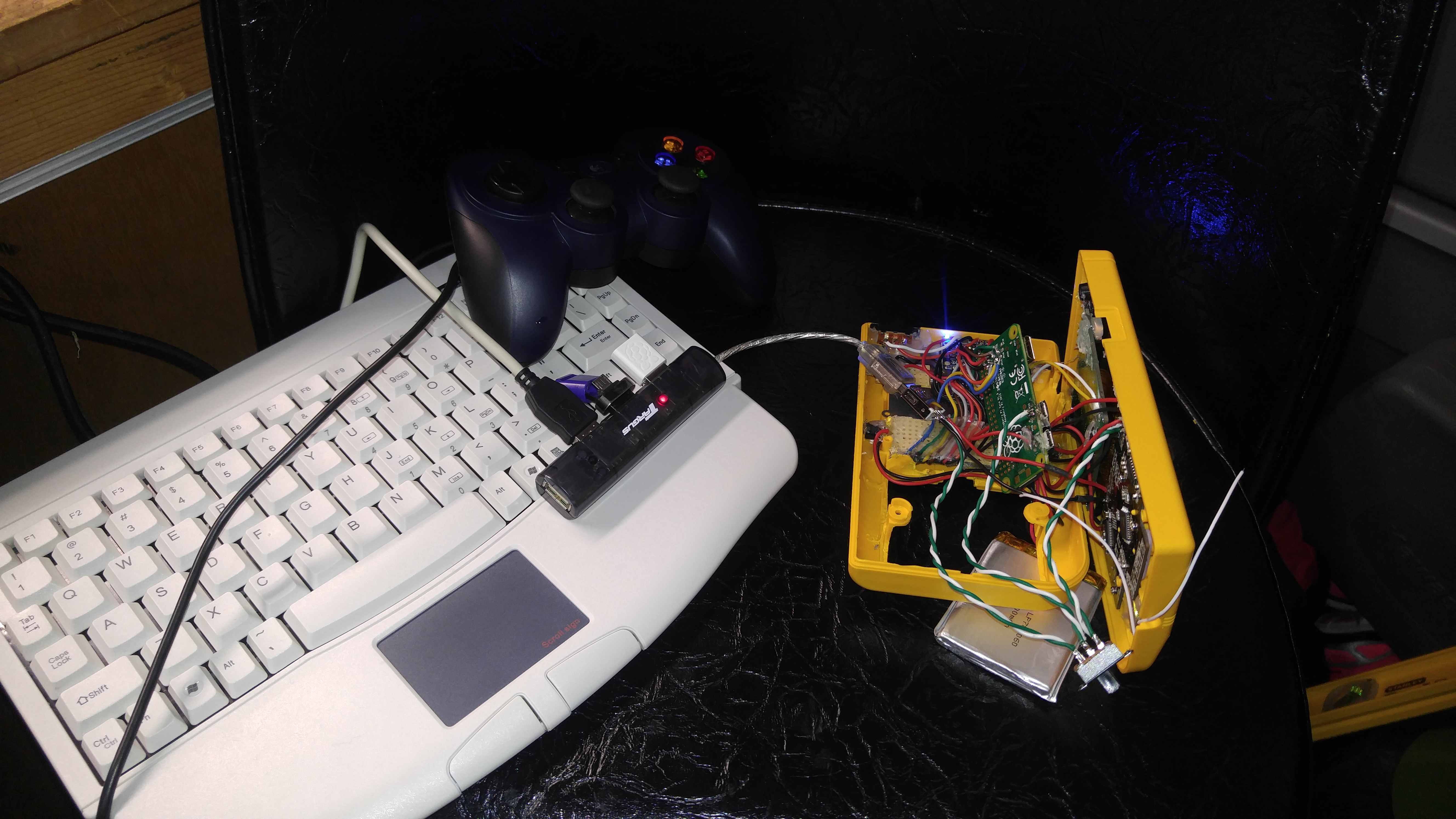

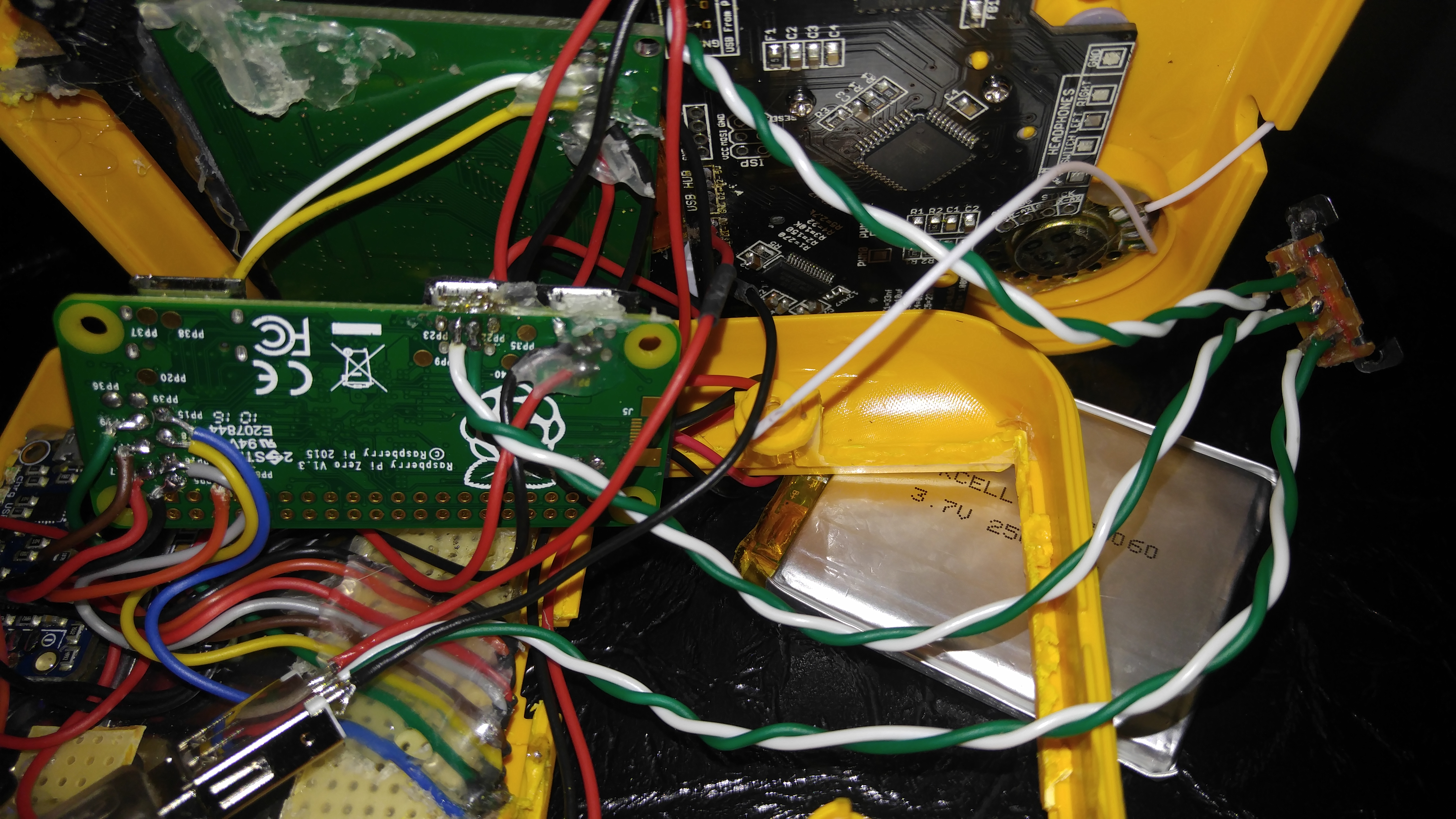

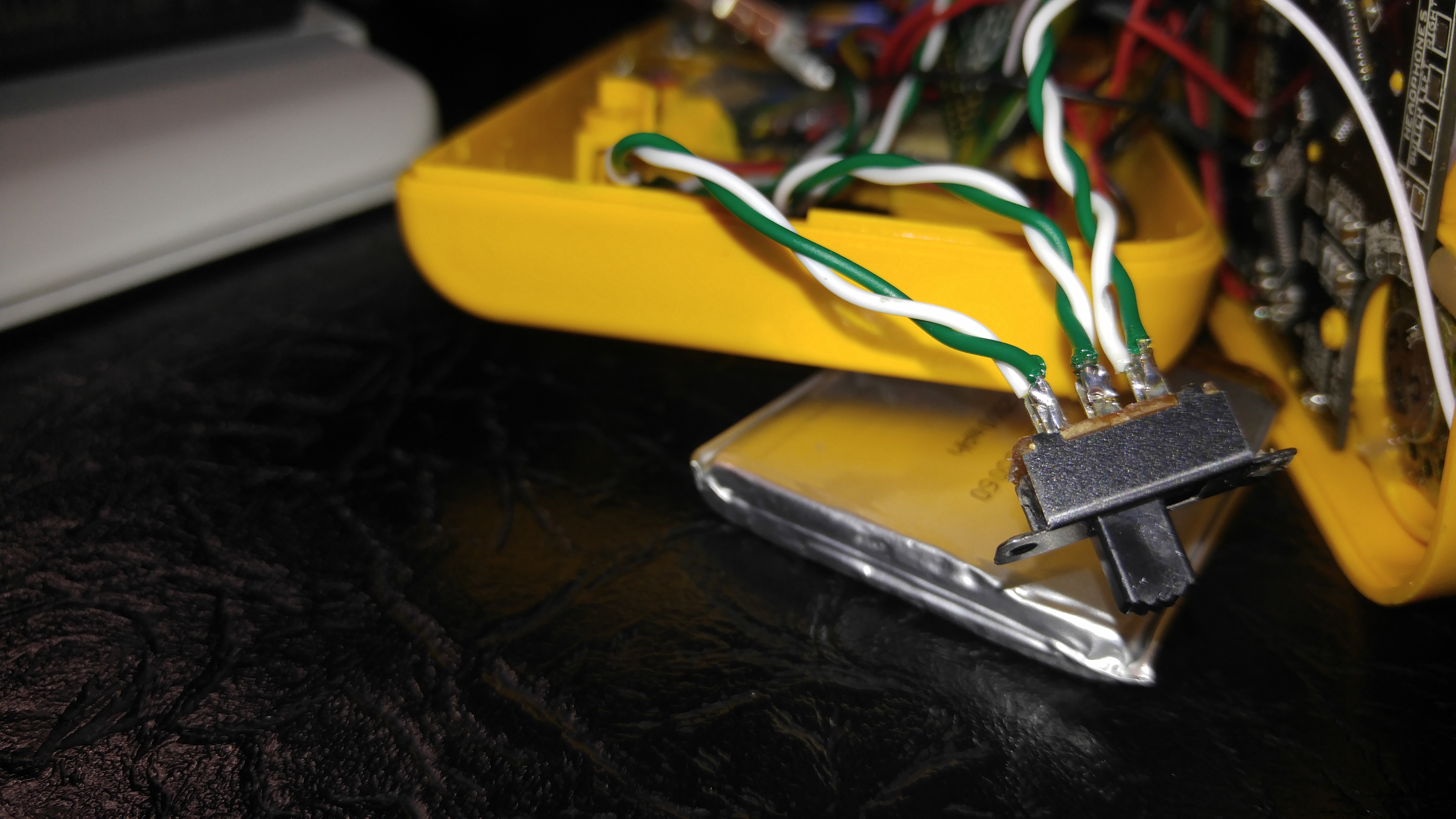

I have a simple fix for the usb issue, I wired the usb signal wires to a switch. Now I just move the switch to give usb control to the aio or the usb port. I can switch back and forth with power on, it goes from one to the other seamlessly. With the usb port active my Wi-Fi, keyboard, memory stick and usb joystick all work now. I'll just keep the switch in the battery compartment and turn the usb port on when I want to add games or scrape an image.

The signal wires from the pi are in the center, switch to the left sends the signal to the port, switch to the right sends signal to the aio.

Post by KaiKona808 » Tue Sep 20, 2016 6:26 pm
msykos wrote:The signal wires from the pi are in the center, switch to the left sends the signal to the port, switch to the right sends signal to the aio.
This is exactly what I was wiring a few hours ago. I just got done testing it and works well. :D
Switch can be flipped from one to the other and will work without needing to reboot.
Pay no attention to shoddy soldering. This was a test run.
