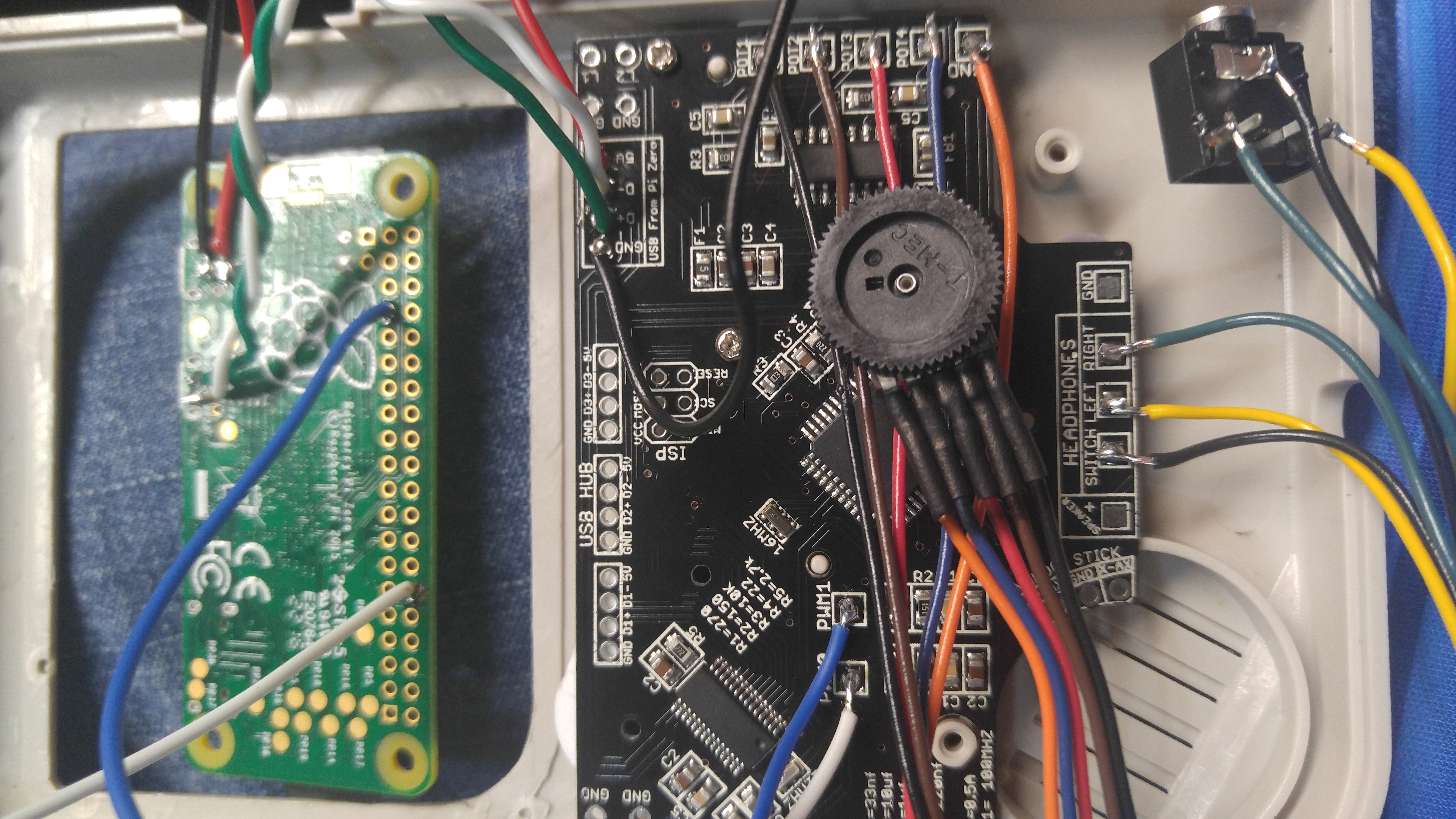

msykos wrote:I have a simple fix for the usb issue, I wired the usb signal wires to a switch. Now I just move the switch to give usb control to the aio or the usb port. I can switch back and forth with power on, it goes from one to the other seamlessly. With the usb port active my Wi-Fi, keyboard, memory stick and usb joystick all work now. I'll just keep the switch in the battery compartment and turn the usb port on when I want to add games or scrape an image.
I see it in the picture but I need to understand, the switch allows communication from either the aio or an external usb hub right? The wifi does not work if you have the AIO hooked up to the hub along side the wifi and the usb storage? (Usb hub hooked up to the pi0 that is)
I have the targus usb hub that wermy had in his video and my wifi works if it's hooked up along side the AIO as described above.
Works like you described. The switch will allow you to flip between the AIO when you want to game and a hub when you need to use wifi/keyboard to work in the Pi0. A quick workaround for those of us still having issues getting the AIO with a hub wired to it to work nicely with wifi. For some adding a couple lines of code and twisting the data wires worked. Others are still having issues getting wifi to work when the AIO is wired to a hub. Helder's new 2.0 board includes an EMI filter to help rid the noise issue plaguing the v1.4 board.
