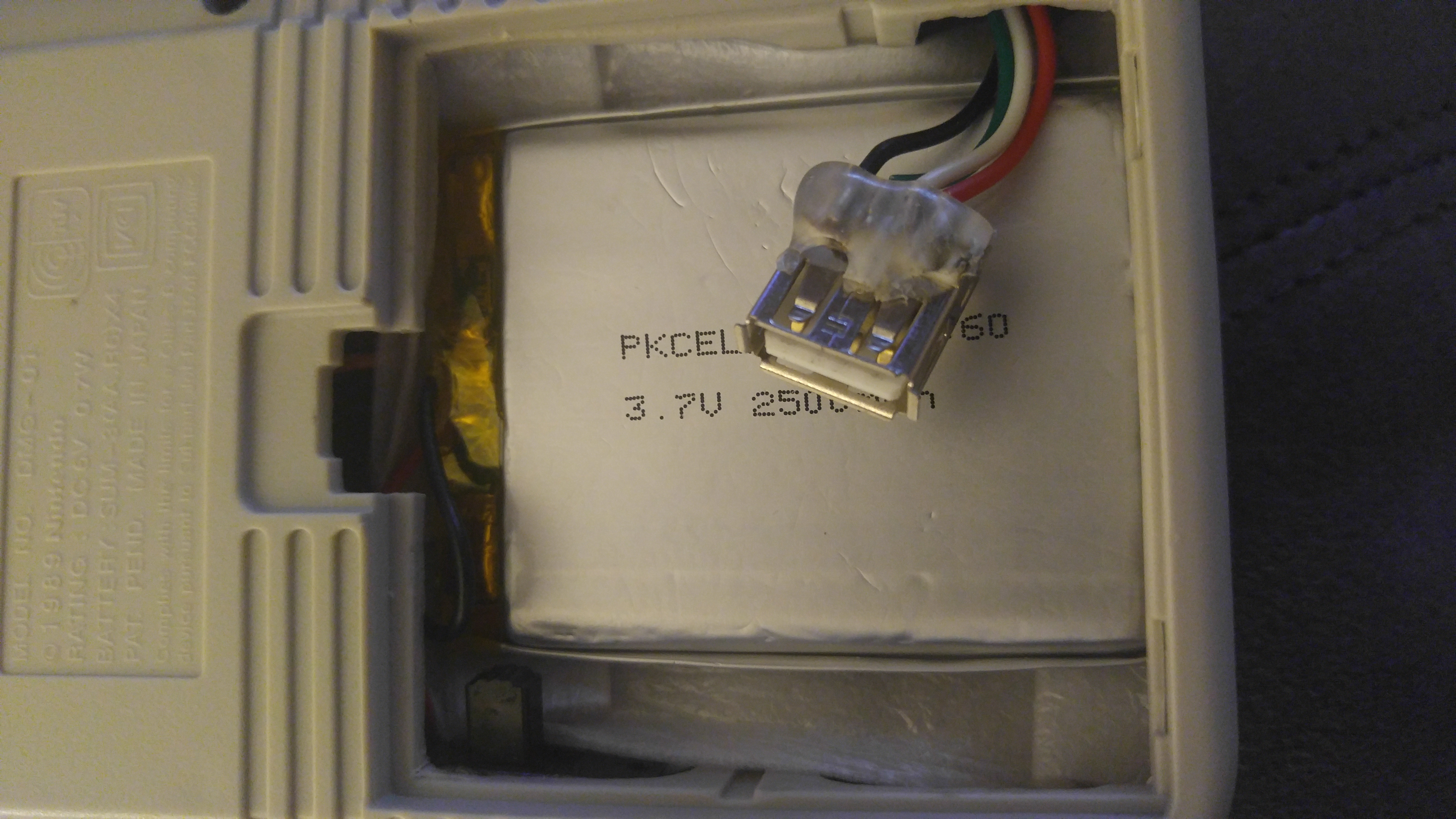

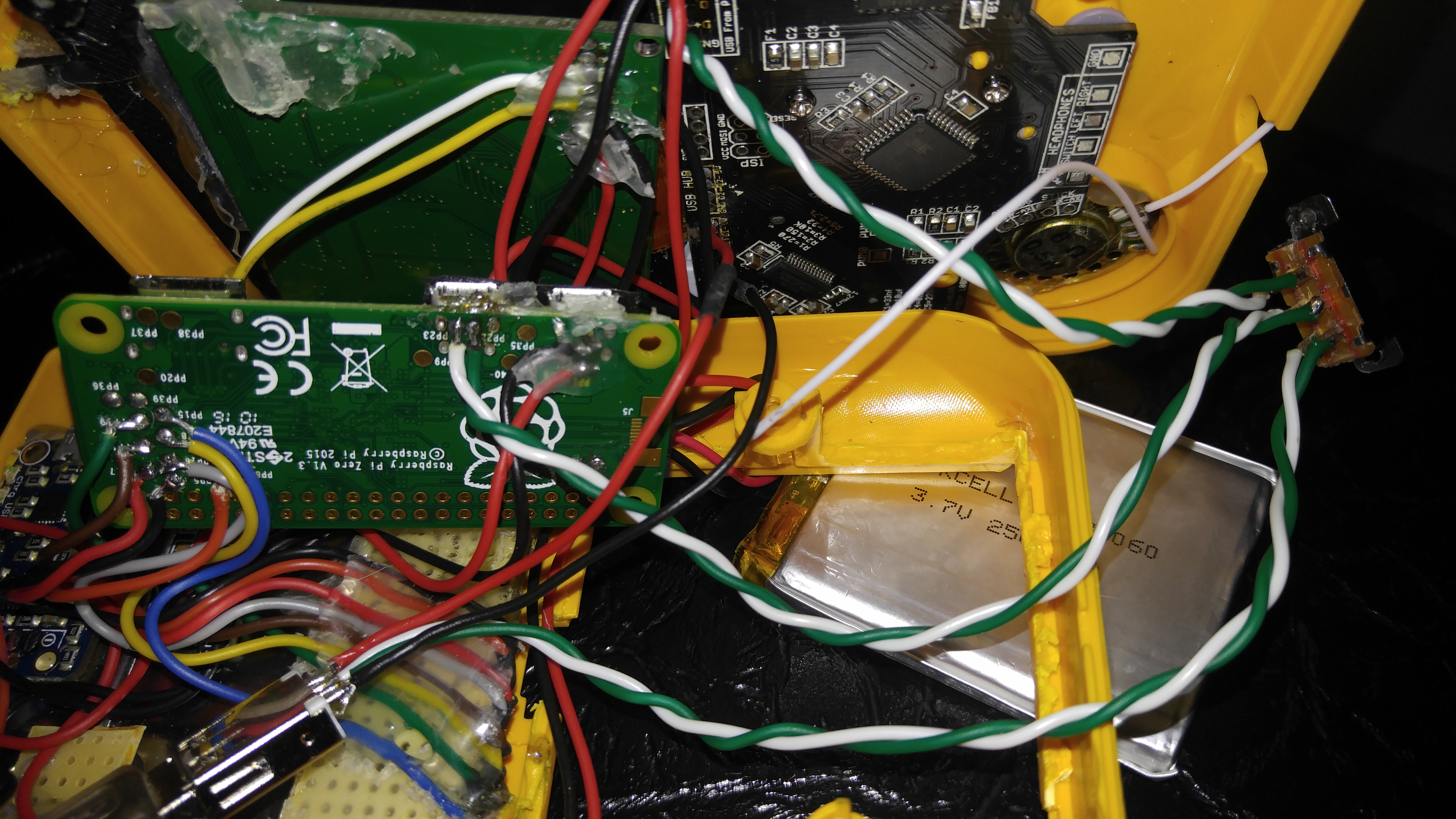

I added a switch( located in the upper left part of the battery compartment) to the usb wiring from the pi, so I could send the signal were it needs to go: either the aio or the upper usb hub. For me my usb key board did still work with the usb from the aio so I added a second usb hub to the battery compartment.
With the switch up I only get usb to the usb hub(aio not connected) this way all my usb devises work, keyboard, Wi-Fi and memory stick.
Down position I get usb to the aio and the hub in the battery compartment, that way I can use the keyboard to map the aio keys in the mame games.

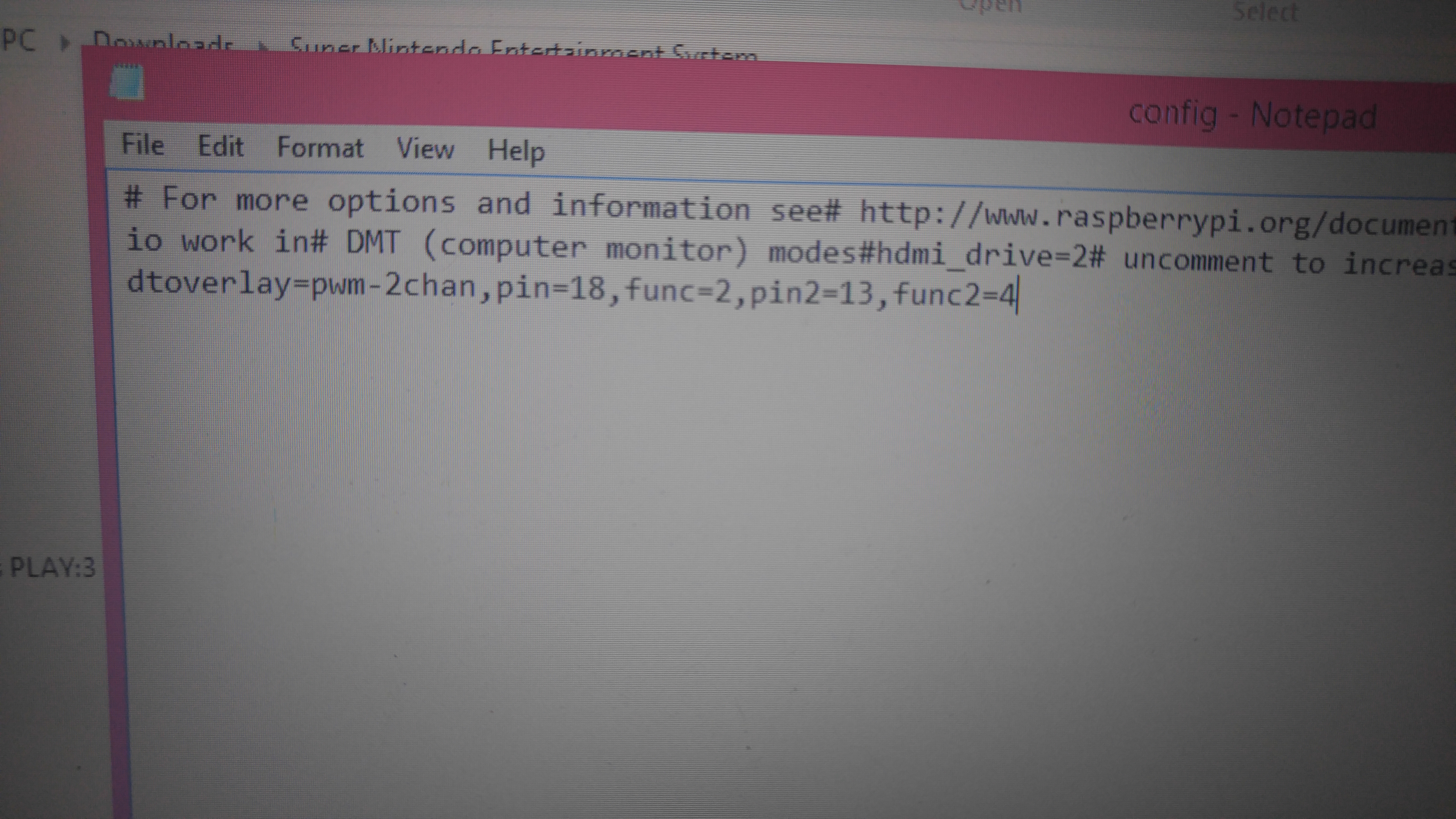

Hello, I'm struggling with audio: I cant't get any sound.
I edit my config.txt and add : dtoverlay=pwm-2chan,pin=18,func=2,pin2=13,func2=4
My wiring seems good:
Do you have any ideas how to get audio?
I had to make that line of text its own line, not add it to the end. Then my audio worked fine. Hopefully that helps. You can also try just wiring up the speaker to make sure the issue is not in the jack.

the dtoverlay line is already on it's own line....
I also try to change the jack for the original GB GMG one, with no luck
I also try to change the volume wheel for the original GB GMG one, with still no luck
