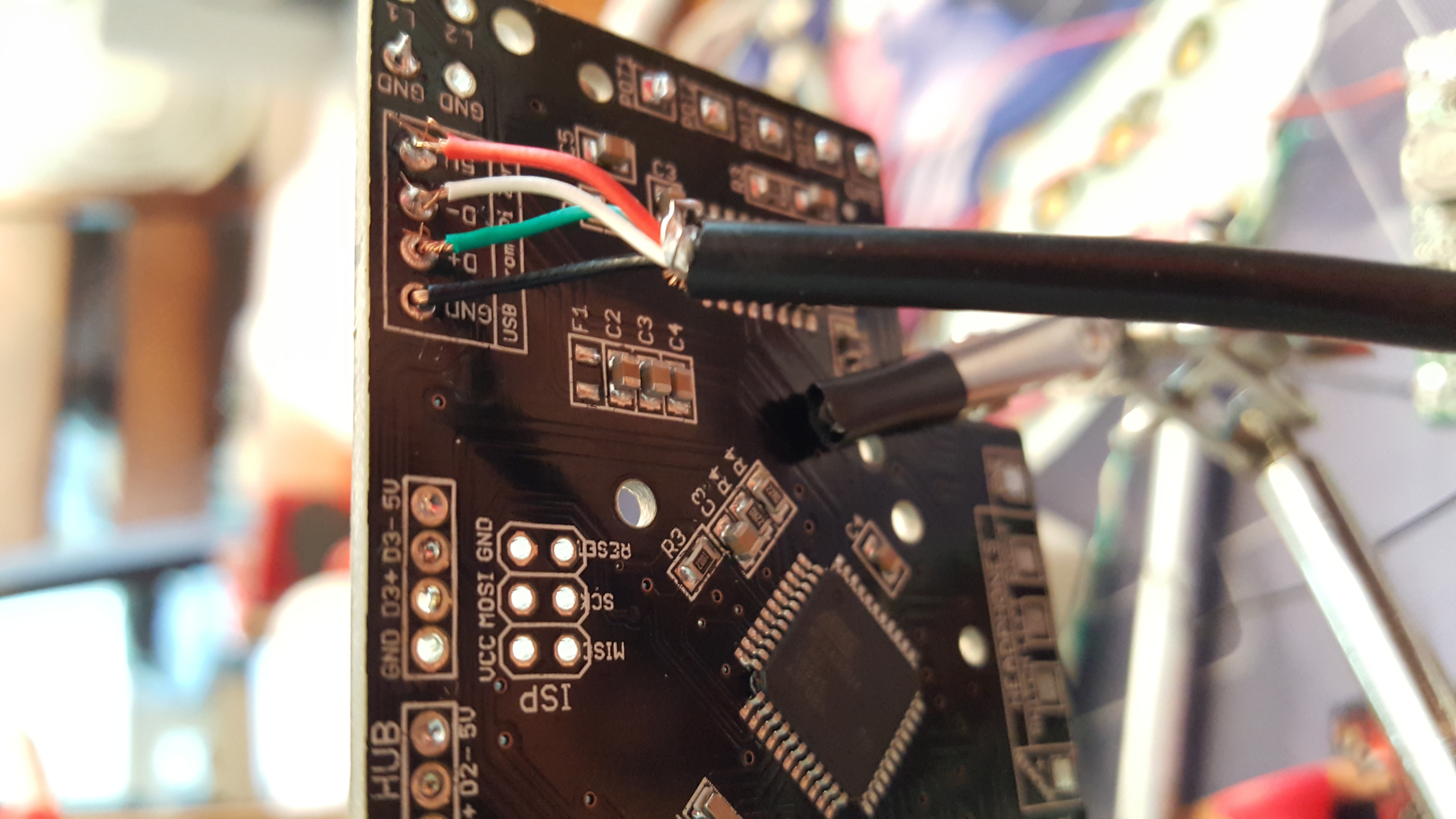

I purchased a 1.4 AIO board and I can't seem to get it to detect on my pi0. I have tried various ways of connecting it but it doesn't seem to be working. I also tried connecting to my PC via usb cable but it's not even detecting or even prompting me that I connected a usb device. Any help would be greatly appreciated. Thank you.
Are you sure you have it wired properly to the usb cable? post pictures please and you might have to reflow the hub chip or the 12MHz resonator if the hub isn't getting detected. Don't reflow anything yet until the wiring has been confirmed.
