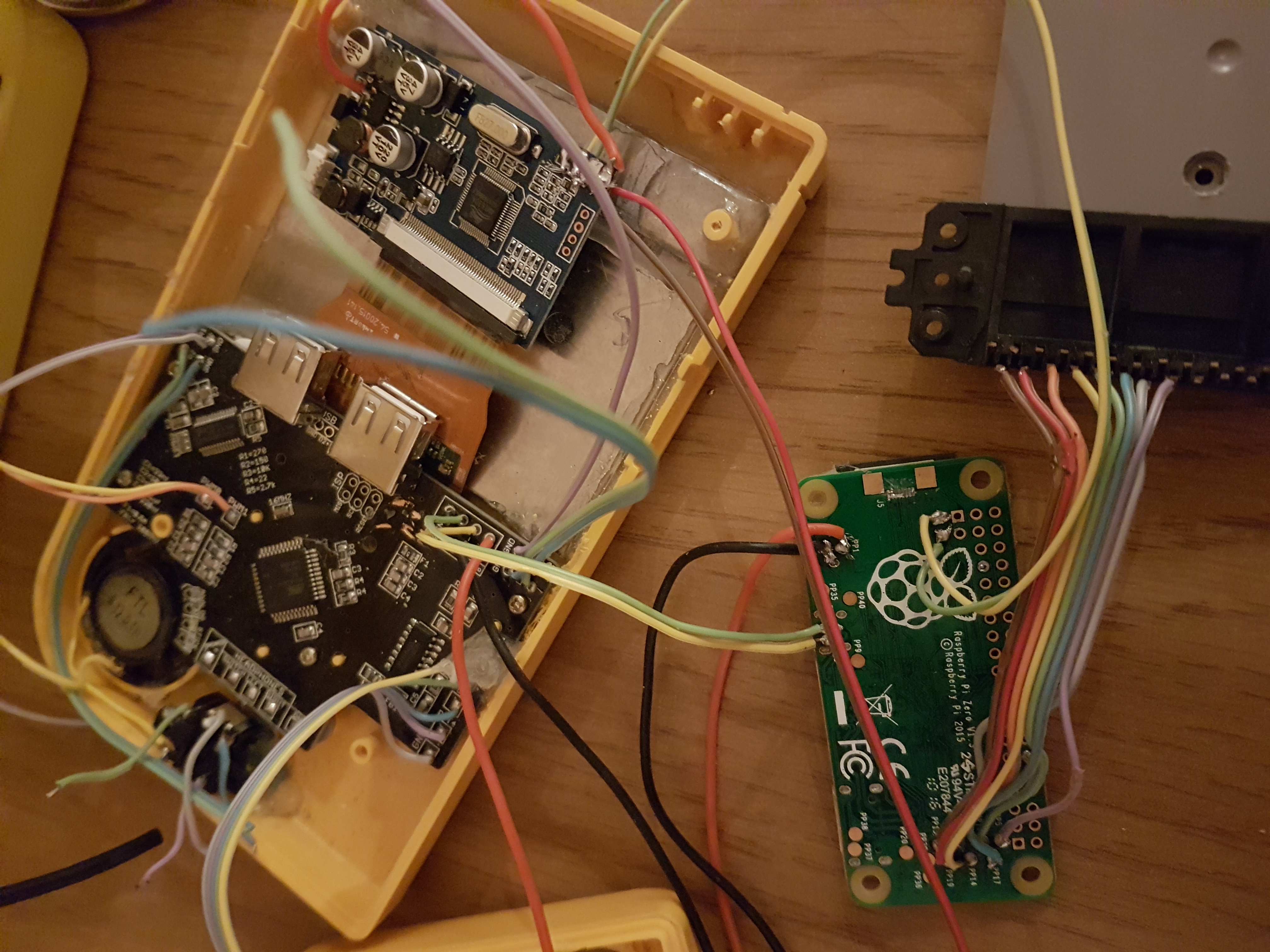

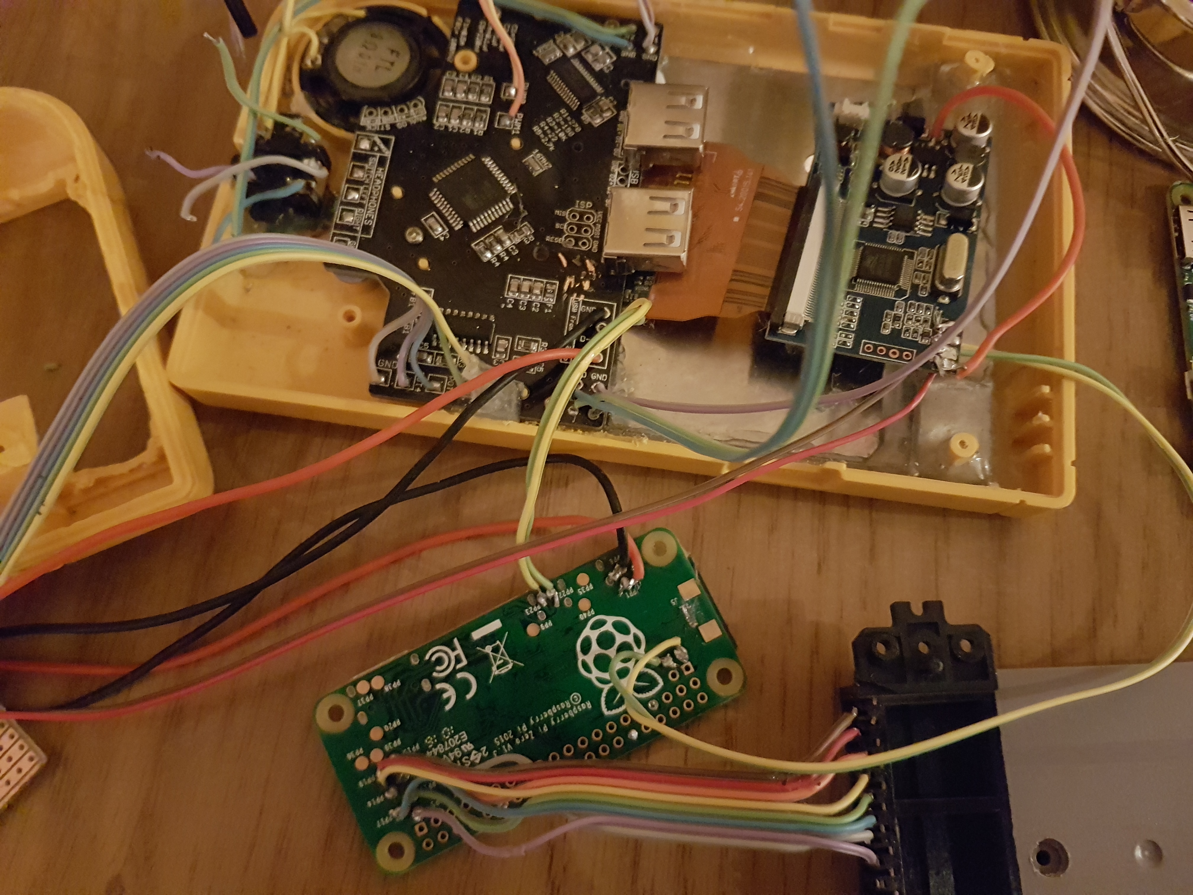

Here is a pic it's been a while as I have kind of lost heart with thiskylewismith wrote:I have tried with everything wired to a power strip from the pb and directly to the pbcaste wrote:Are you also powering the Pi with the powerboost? I figured out tonight after a bit of frustration and trial and error that the board and Pi need power originating at the same source. I had the Pi plugged into a wall charger and the board hooked up to the powerboost and it wouldn't see it. I could only get it recognized by powering it from the Pi itself or powering the Pi from the powerboost as well.kylewismith wrote:I'm at a loss retropie doesn't recognise the board. I have reprogrammed it so I know it's not that and its connecting to my pc. I have 5v at the board and it wired directly to the power boost can't find any shorts does anyone have any ideas
- 20161030_185000.jpg (3.86 MiB) Viewed 11341 times
- Hope that's clear enough
- 20161030_185124.jpg (3.37 MiB) Viewed 11341 times
