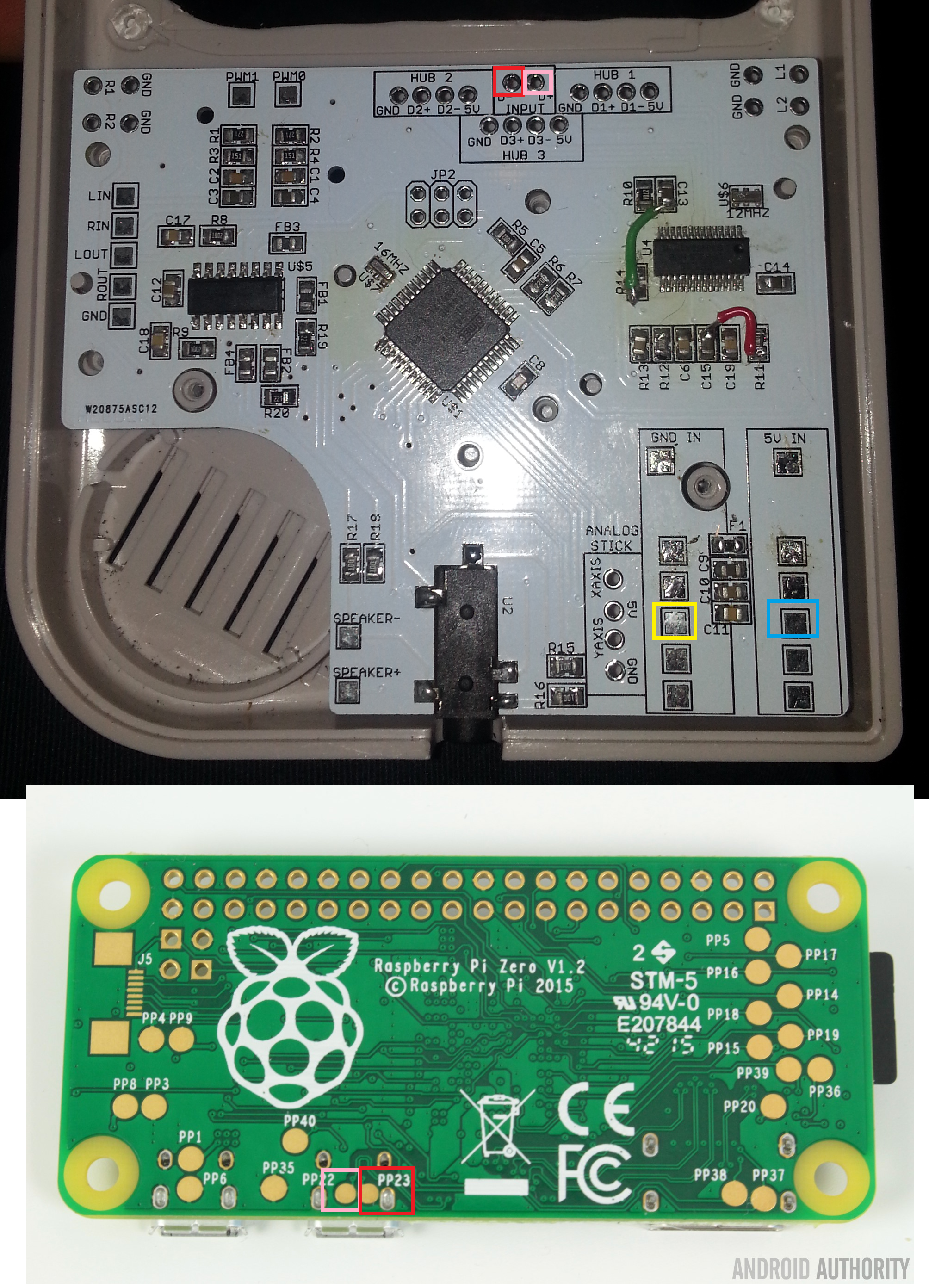

Good evening,
has anyone got a wiring diagram for the latest version of helders board? I just cannot find anything and I am not sure how to power it up (for testing) directly to the pi.

Hi,
I wired my Helder board pretty much like that. I also wired the Screen (Power comes from Helder board, Screen works) but my pi doesnt recognize the helder board as usb controller - shouldnt it work just like that or do i need to do something differently? I twisted D+/D- cables.

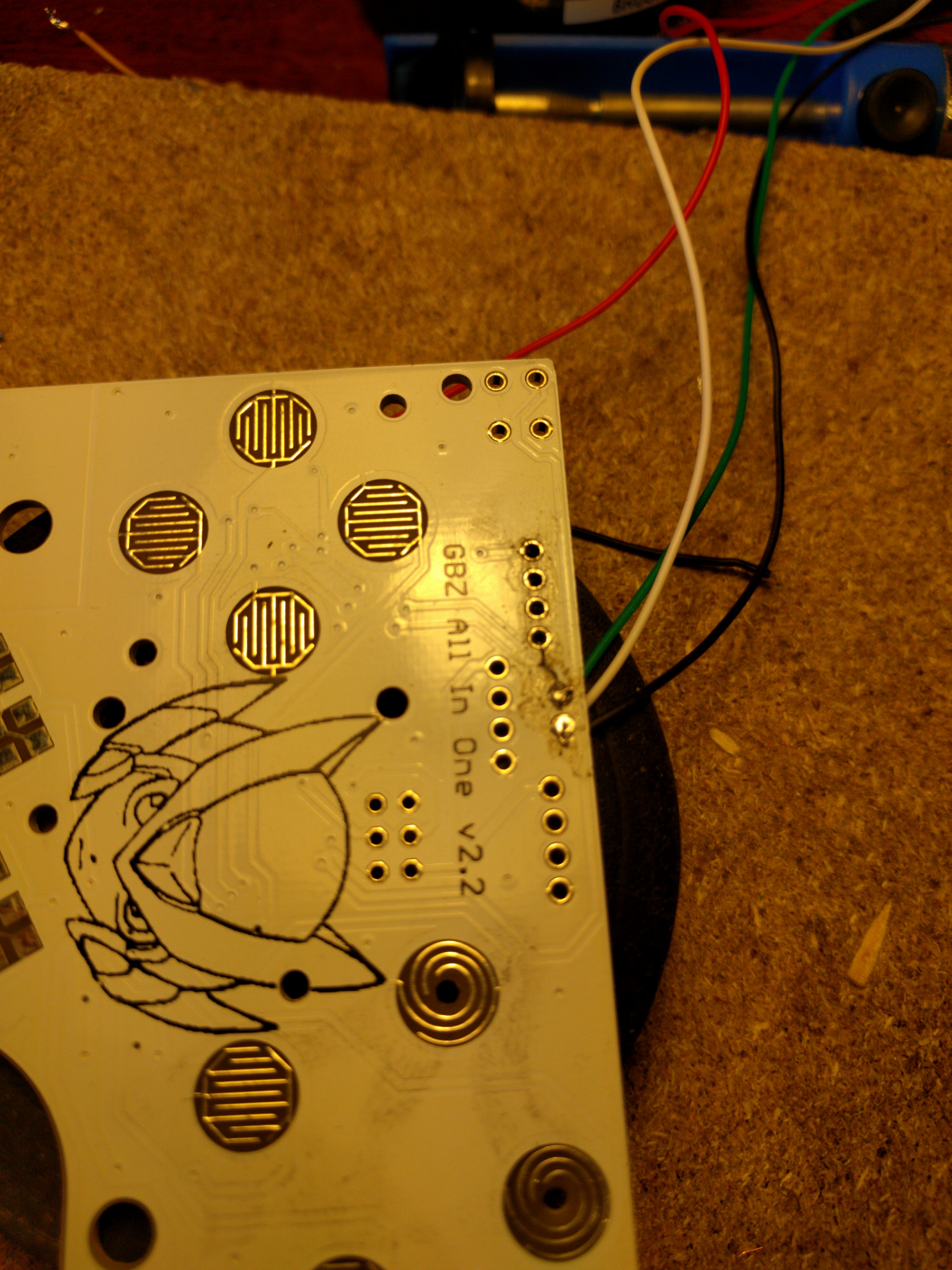

Hello.
I need help.
I started this days to mount the AIO 2.2, but I have a problem. To start mount, I conected all conections, but not work. Later I desoldering, but one track desoldering. Now, How can do the conections?

I added the wiring diagram to the first post because it's so hard to figure out all the connections on your ownkokosgeek wrote:Hello.
I need help.
as for your burned off and ripped trace you can fold it back down and scrap the white coating and solder it to the wire or use any part of the trace I outlined in red by scraping the white coating and solder the wire to that exposed trace but be careful not to rip that trace further.
