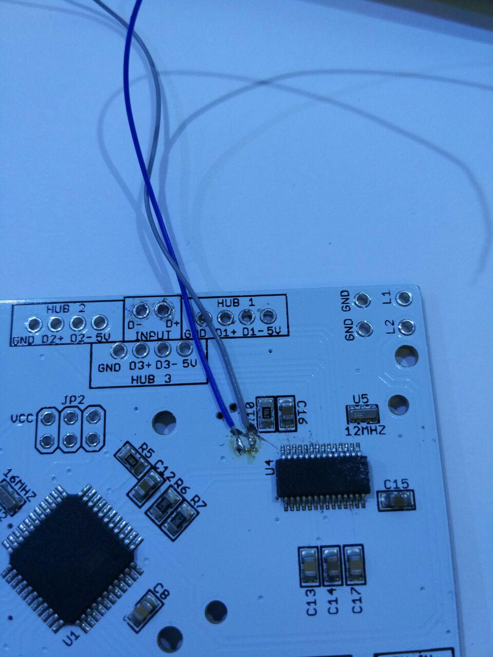

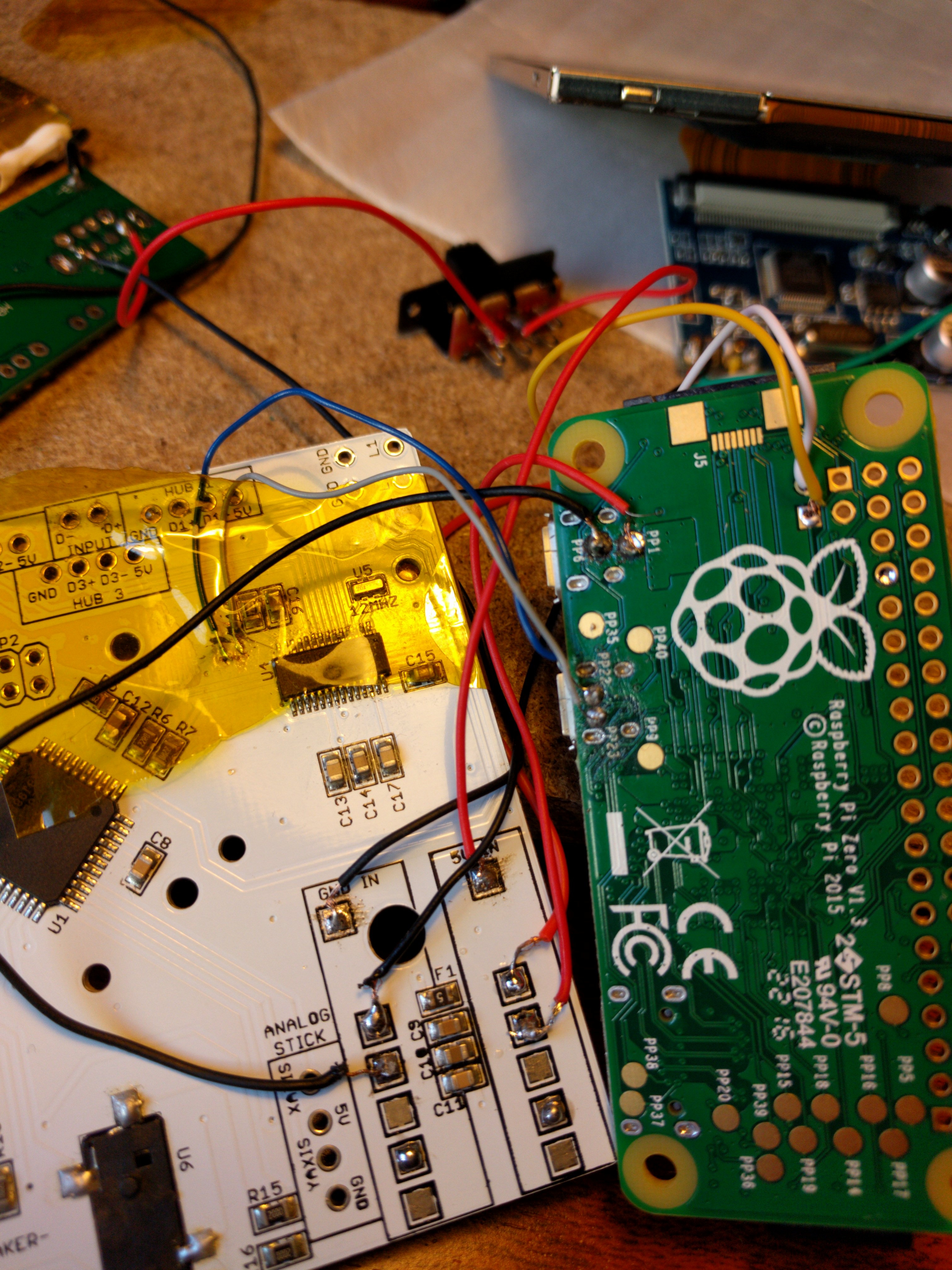

Hello
I recived the all in one, the last week. I connected to Raspberry and didn't work. I desoldering and my all in one, track desoldering. I speak with my friend and He repair, search other point for soldering. But my all in one, continue without work. Any solution?
I attached my solution! Any help?
Sorry for my english!
Post by Helder » Thu Dec 01, 2016 5:53 pm
Are you sure the wires are connected properly on the Pi? post pictures of your whole setup not just the repair that was done. Is the board being powered? Show pictures of Pi and where the usb wires are soldered to. Also test the controller on a PC using the usb connections you normally connect to the Pi.
If you want help we need information and pictures or we can;t figure out what your doing or what is wrong.

I try to connect the all in one to pc, but not recognize.
I attach my connections with the raspberry.
When I recived, I connected all in one in my raspberry and didn´t work and I tried with the pc and did not recognize it either.
Thanks for your help.
Post by Helder » Fri Dec 02, 2016 7:03 pm
kokosgeek wrote:I try to connect the all in one to pc, but not recognize.
First off the wiring is wrong and you didn't twist the usb wires, 2nd I have no idea if those soldered on wires have a good connection or not and they might be shorted to one of the GND pads near the PP22 and PP23 (hard to tell in the picture).
Look at the image below for the proper wiring of USB.
