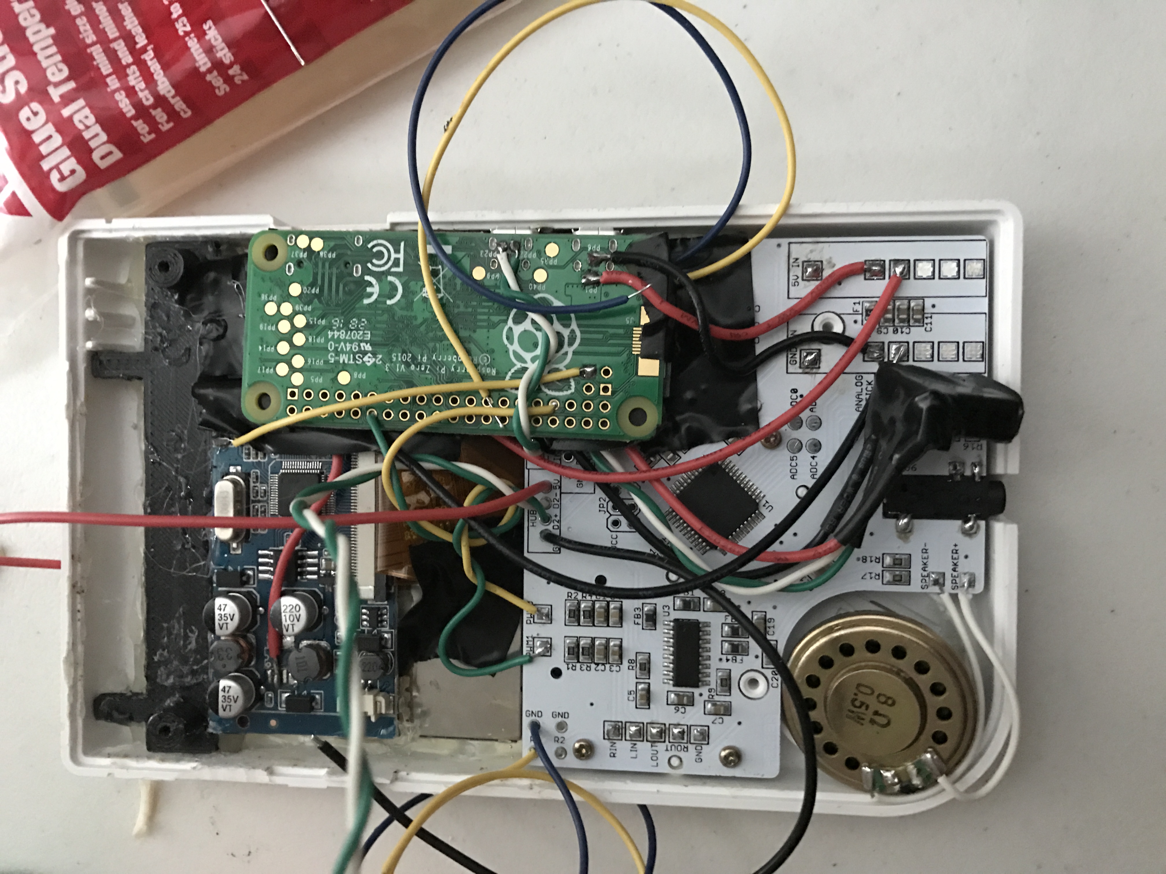

I cannot get any audio out of my speakers or headphone jack....
I have a picture of the wiring with pin 18 going to pmw 1 and 13 to pmw 0, and the speaker seems to be connected as well. I get no audio at all out of the speaker and i'm only getting massive static and hissing out of the headphone jack. I don't know if I messed up the wiring or what. I also changed the config file and just used [mention=]Helder[/mention] file for enabling audio on the page.
Any help would be appreciated. Everything is working perfect except for this and hoping to finish the project up by the end of the weekend!
Photo Jan 19, 8 34 27 AM.jpg (1.93 MiB) Viewed 11076 times
