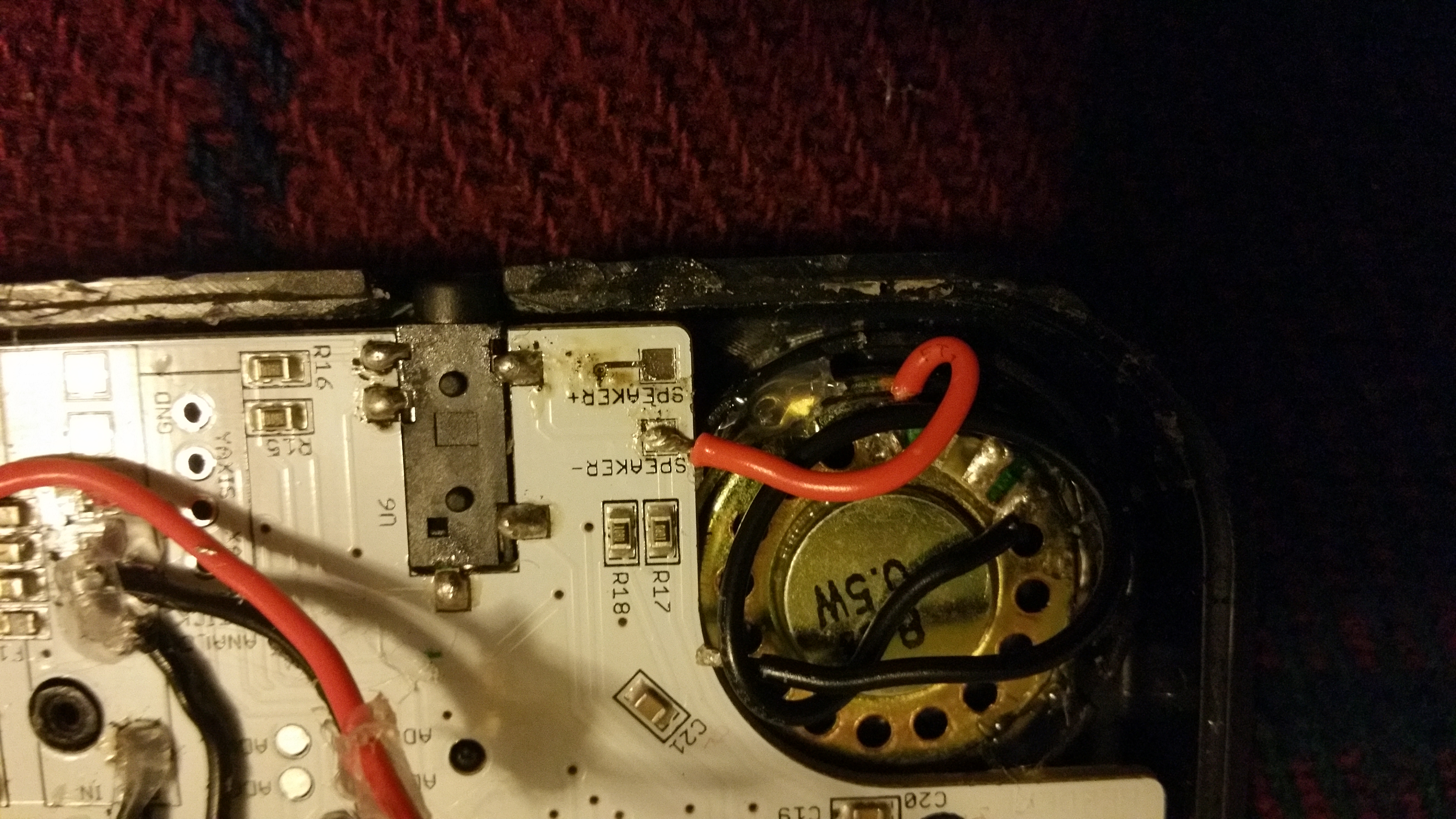

enemone wrote:@helder I unfortunately stripped 2 pads from the channel inputs on the volume wheel pads on the board, and I also stripped the positive pad for the speaker. Do you know of any way that I can regain sound?
Post a picture of the damage and I'll indicate some alternate points.[/quote]
Please see the attached photos of the damaged areas
Volume wheel pads damage d
Speaker positive pad damaged
Here you go, all alternate points for the audio circuit.

Post by enemone » Sun Jan 22, 2017 10:49 am
OMG! Thank you @helder! This is great, now I can finish my project! Lol
