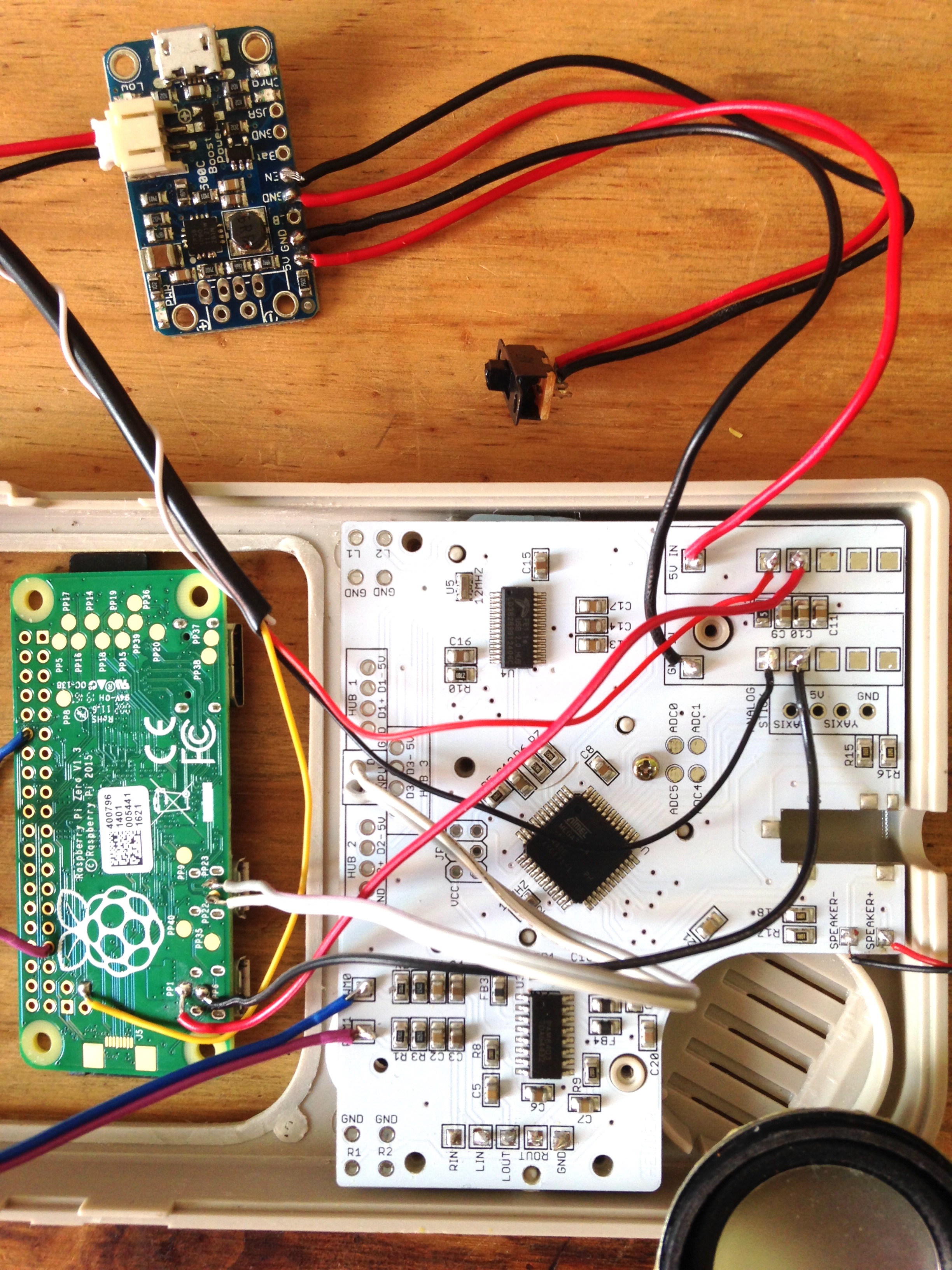

Hello, everyone.
I've just got my PCB but I don't have my volume wheel yet.
Can I still get sound on the speaker without it?
Finally, based on my pic, which config should I use when I get the volume wheel?
Can you see any mistakes on my wiring?
- dtoverlay=pwm-2chan,pin=18,func=2,pin2=13,func2=4
- dtoverlay=pwm,pin=18,func=2
- dtoverlay=pwm,pin=13,func=4
Or another one?
Thanks a lot

- Pi Zero Wiring - Helder All-in-One 2.2
- FullSizeRender 27.jpg (2.06 MiB) Viewed 10123 times

I answered the speaker issues numerous times in this thread and it's probably 5 pages back so have a look for the jumper wires you need to do.rogersouza wrote:@Helder

First post also has the config.txt plus the exact line to use for PWM audio which should be the first line above.
