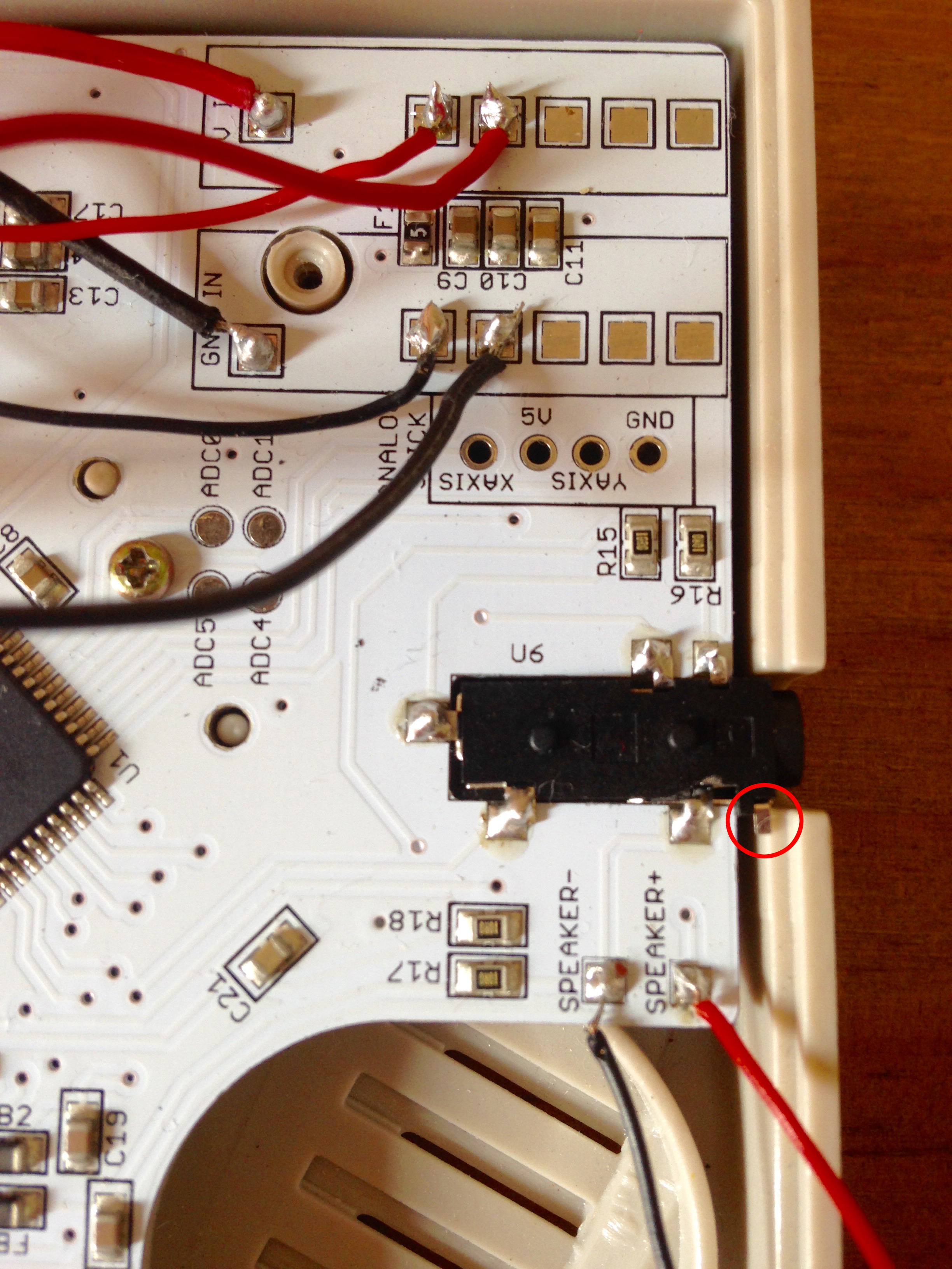

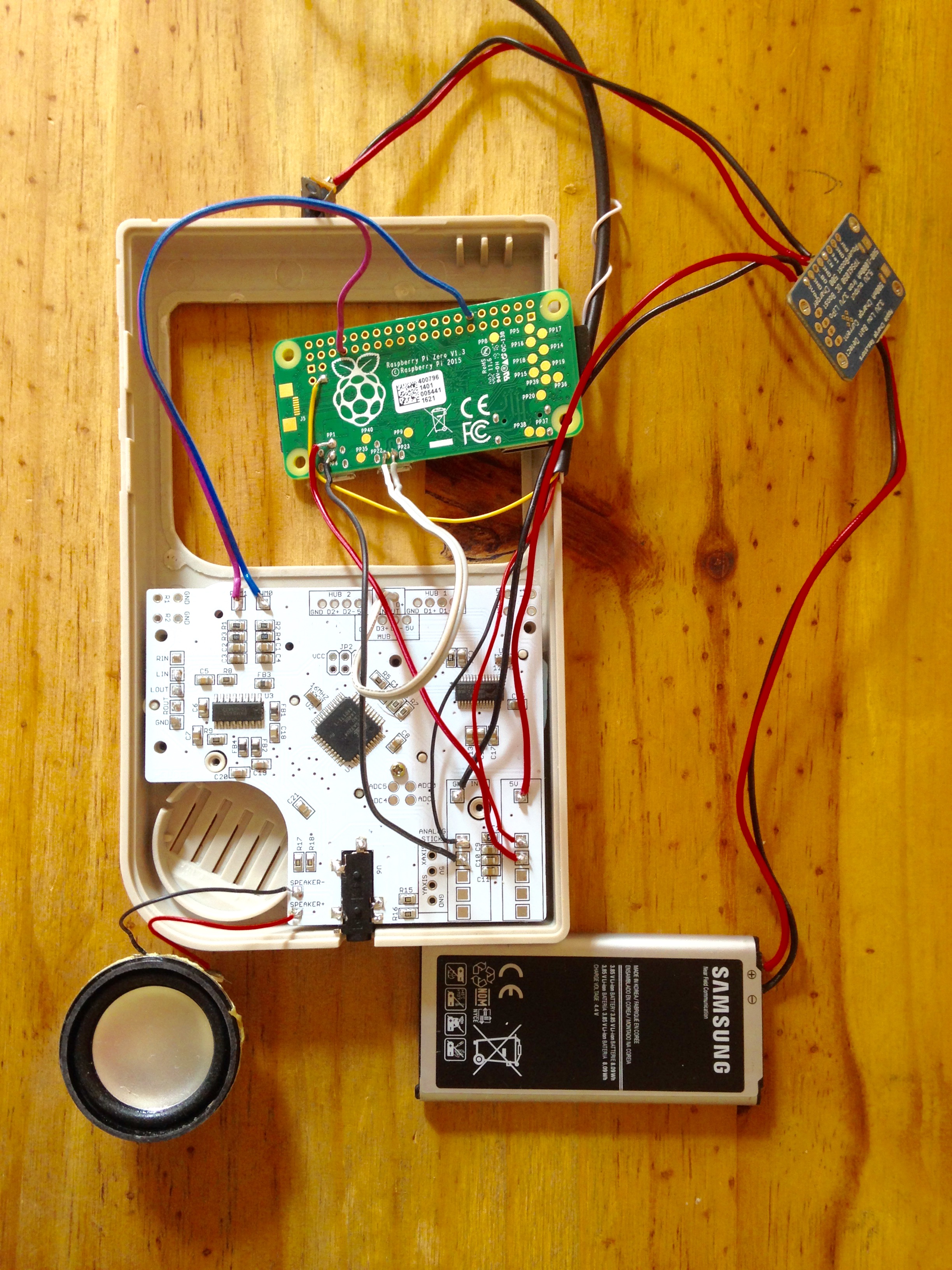

rogersouza wrote:@Helder
Hello, everyone.
I've just got my PCB but I don't have my volume wheel yet.
Can I still get sound on the speaker without it?
Finally, based on my pic, which config should I use when I get the volume wheel?
Can you see any mistakes on my wiring?
- dtoverlay=pwm-2chan,pin=18,func=2,pin2=13,func2=4
- dtoverlay=pwm,pin=18,func=2
- dtoverlay=pwm,pin=13,func=4
Or another one?
Thanks a lot
Helder wrote:@rogersouza
I answered the speaker issues numerous times in this thread and it's probably 5 pages back so have a look for the jumper wires you need to do.
First post also has the config.txt plus the exact line to use for PWM audio which should be the first line above.
Im sorry, @Helder but I've tried everything you could imagine. I am on this fro the last 2 months, so believe me, I've read LOTS of pages here, youtube, etc etc etc. I also was building a Game Boy Zero from scratch with Game Boy parts, so with your board should be easier, I thought. Unfortunately is not
And you did not answer my questions about (can I use/try the audio from your PCB without the volume wheel?
I have installed Retropie, Recalbox and changed the config and cmdline with the files you've provided on the first page and NO SOUND WHATSOEVER. Tried 3 different speakers as well.
Also, I spot a extra "leg" on the jack conector you've sent me. It has 6 pin, and not 5 as I've seen here on this forum. Is that right?
Please, I need really your help as, BELIEVE, I tried everything I could to get this f* audio from rasp zero. I am about to give up
If someone else have experienced the same issue, please let me know.
Thanks a lot

Apparently you didn't look hard enough, go to page 45 to the 2nd post. The first picture is how to wire it up if there is no volume wheel.

rogersouza wrote: Also, I spot a extra "leg" on the jack conector you've sent me. It has 6 pin, and not 5 as I've seen here on this forum. Is that right?
Please, I need really your help as, BELIEVE, I tried everything I could to get this f* audio from rasp zero. I am about to give up![]()
Thanks a lot
Miogui wrote:Hi helder,
First of all, thank you for this board.
Everything works except the sound.
I've got exactly the same issue as Tomatoflames and xfcrowman.
When I plug an headphone I've got a clear sound, but when this is unplugged I've got no sound on my speaker.
I've tried 3 different speaker from adafruit, and also confirmed they work by directly map them on the headphone output.
I've also tried to replace the 2 resistor by a 75ohm ... Nothing work.
Is there a reason for explaining that the amp doesn't work without headphone...
And yes I've already read all post concerning the 2.2A.
Could you share with us the schematics of this board, or do I need to reverse engineering this board and share with all my schematics...
I'm an electronic engineer, and for it's impossible to expirement some workaround without schematics.
Shit this might be the issue with the speaker, I had a huge bag of left over sockets for the headphone from the last order from the manufacturer but upon further inspection it has 6 legs like yours and without the correct socket the speaker audio will likely not work which is the issue many of you are having.
The socket is PJ-328 and I will have to order a bunch and send you a new one once they arrive unless you can order 1 for yourself from some online retailer. Anyone having speaker issues please check the headphone socket if it's 5 pin or 6 pin and let me know in a PM so I can get a list going of who will need a replacement.
Try to bridge these 2 pins and see if it makes the speaker work.
