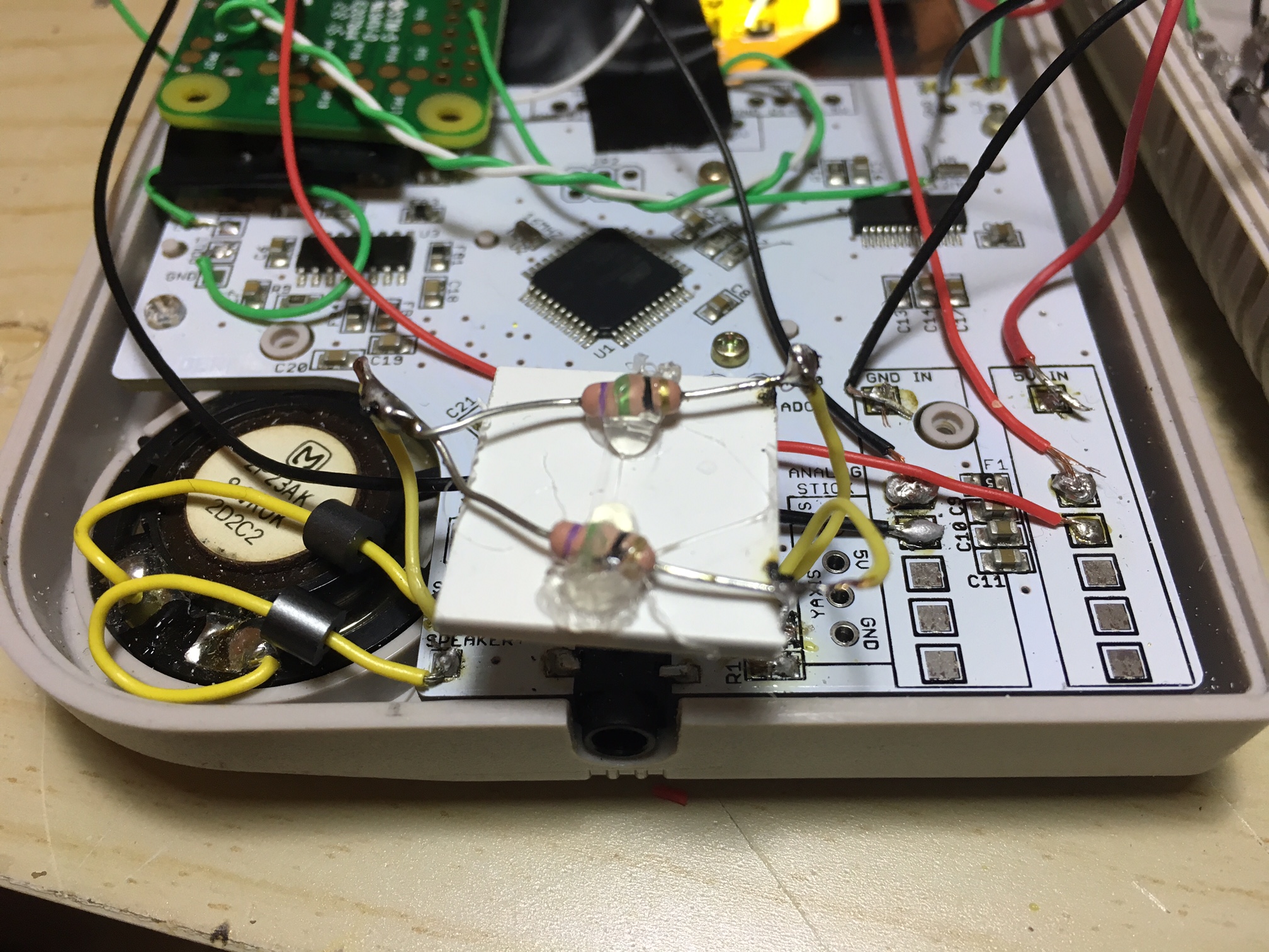

Bummer about the screen. I removed the volume wheel during the trouble shooting process. Once the speaker worked with the resistors, I put the volume wheel back on and it works perfectly. Completed build now. It's definitely awesome and worth the trial and error. Good Luck!

Tomatoflames wrote:Solution found! Thanks @Helder. :D
Issue: Extremely choppy and quiet audio through speaker.
Solution: Added resistors as suggested by Helder which, instantly increased the volume and reduced the choppiness to a very playable level. No other steps were required apart from hookup as shown on Helder's wiring diagram and the config file, both of which are found on page 1 of this thread.
My setup: AIO 2.2A with 5 pin audio jack, Raspberry Pi v1.3, Adafruit Powerboost 1000C TPS61000, and 8 Ohm 1/2 Watt speakers https://www.amazon.com/gp/product/B00WW ... UTF8&psc=1
Parts Required: Two 75ohm 1/2 watt resistors, Three 1.5 inch long pieces of extra PWM or audio wire and a small piece of perf board.
Resistors from https://www.amazon.com/gp/product/B0002 ... UTF8&psc=1
To do:
Place resistors into the perf board parallel and adjacent to each other and solder the ends together on one side to make a U shape.
Solder a wire from the bottom of the U, on the side you just joined, to the Speaker - pad on the AIO.
On the other side of the perf board, solder a wire from the end of one resistor to the right side of R15.
Solder another wire from the end of the other resistor to the right side of R16.
Done
You do have extra perf board that you used for practice, right?! :)
For excellent soldering tips to protect your investment - http://www.sudomod.com/forum/viewtopic.php?p=21465
This was genius! It worked perfectly, and I even tried it with two 150 ohm resistors. Sound is perfect through the speaker now! Not even much static or hissing!
@helder this should be on page one for these new boards. There must be some disconnect between R15 and R16.
Thanks!!!

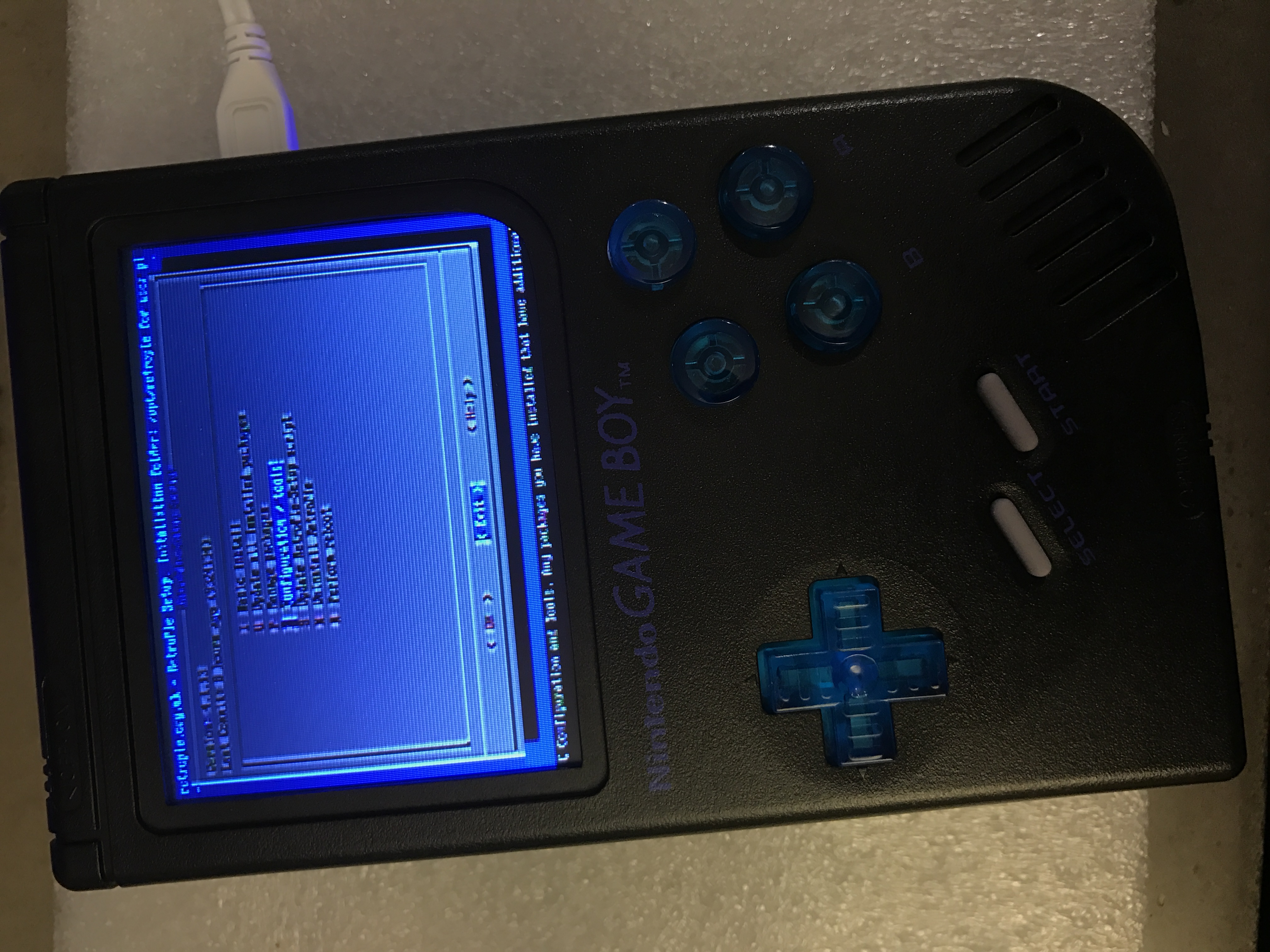

I've configured and got my AIO board running and all the controls work great in game and in menu.
However, when I go into retropie-setup or wifi, I can move around in the menus but can't exit or choose any options. Seems like it's not responding to "A" or "B" on the controller.
Any chance you know how to fix this? Does not happen when I connect a keyboard or another controller.

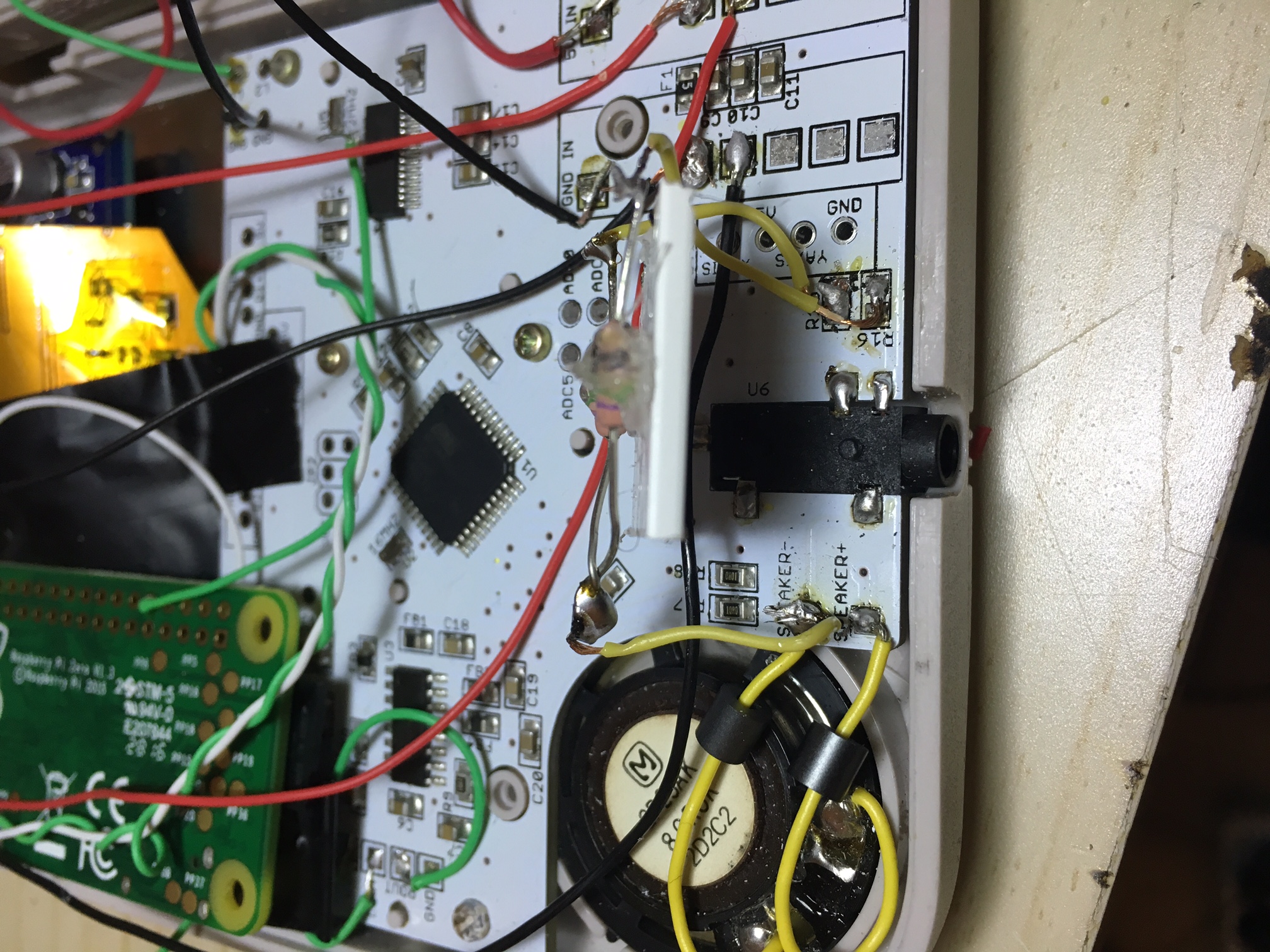

Can someone help me? I tried the above to reduce cracking of the sound after shielding the speaker cables. but now I have no sound at all.

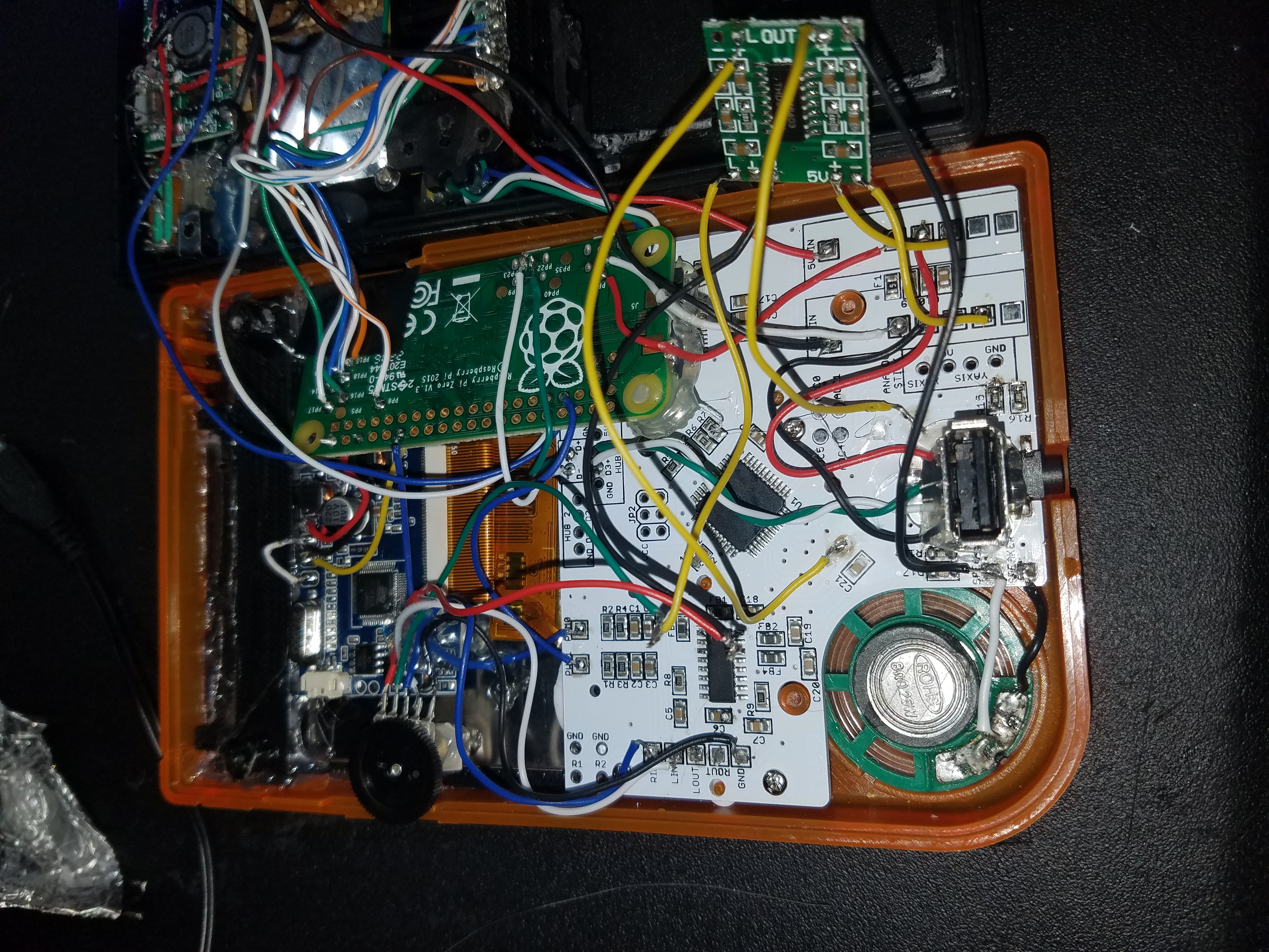

could not get audio to work at all, build several gbzs and had this exact problem before.
sound would not go past 65% without cutting out at high pitched noises and volume waaay to low. it was from grounding both left and right outputs on the pam board. could not fix the aio so i just rerouted the audio through my own pam(pic was only for test haha) and it works perfect. definitely something wrong with the circuitry.

try hookung the resistors you added to the speaker + pad not -
