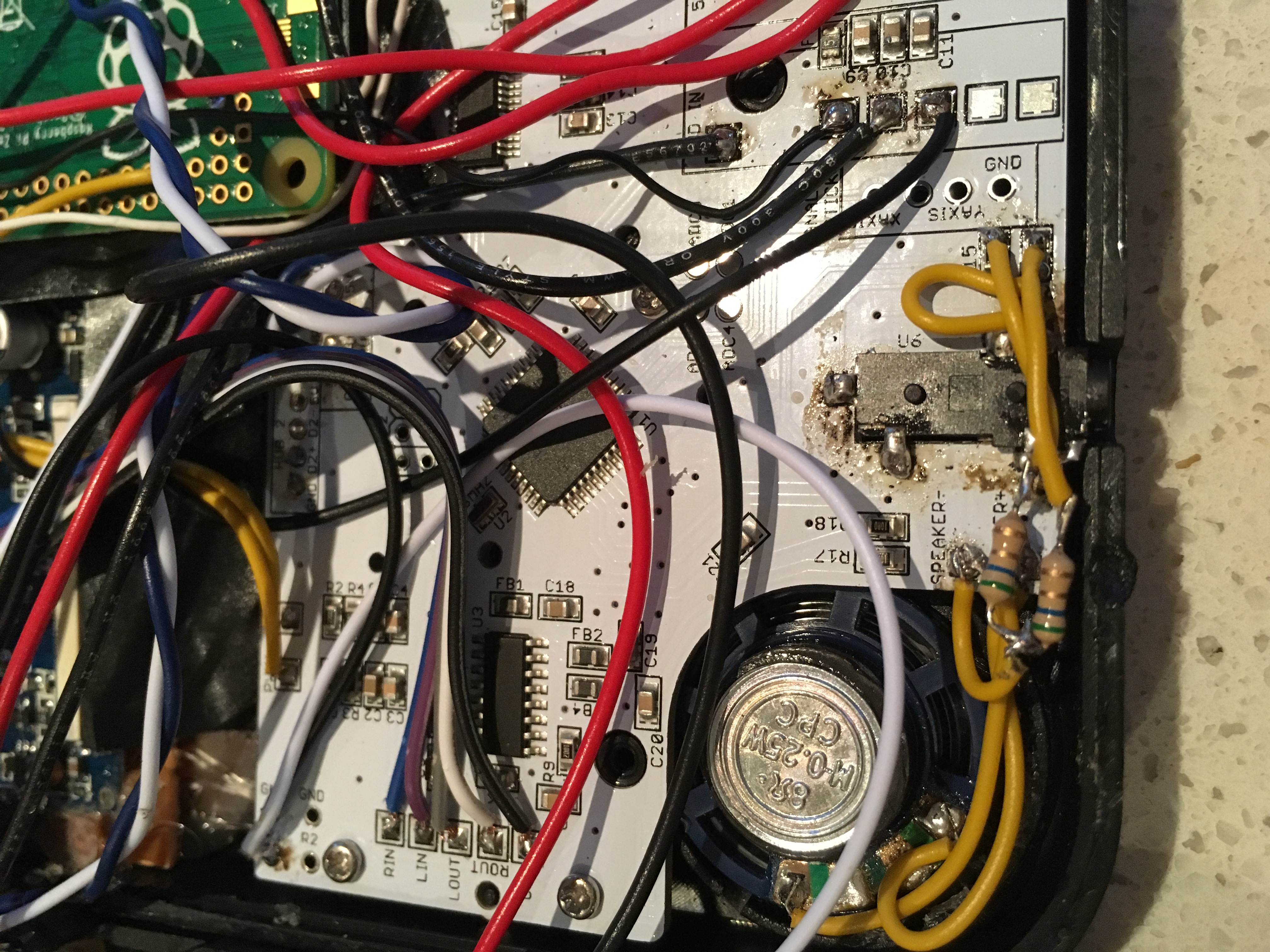

Edit:
Threw a pair of 5 ohm resistors through to the speaker. Volume is great on the speaker now. The volume is very high on the headphone jack but it's much easier to adjust the volume slider just right. There is a lot of noise on the headphone jack, will change the PWM to shielded cables if it starts to annoy me.
Thanks for everyone's help. Here is what my bodge job looks like. Will need to move the resistors off the board a little as they're pretty close to the speaker positive (+) pad.
Ignore the little looped yellow cable, I took off a pad while trying to change out to another headphone jack.

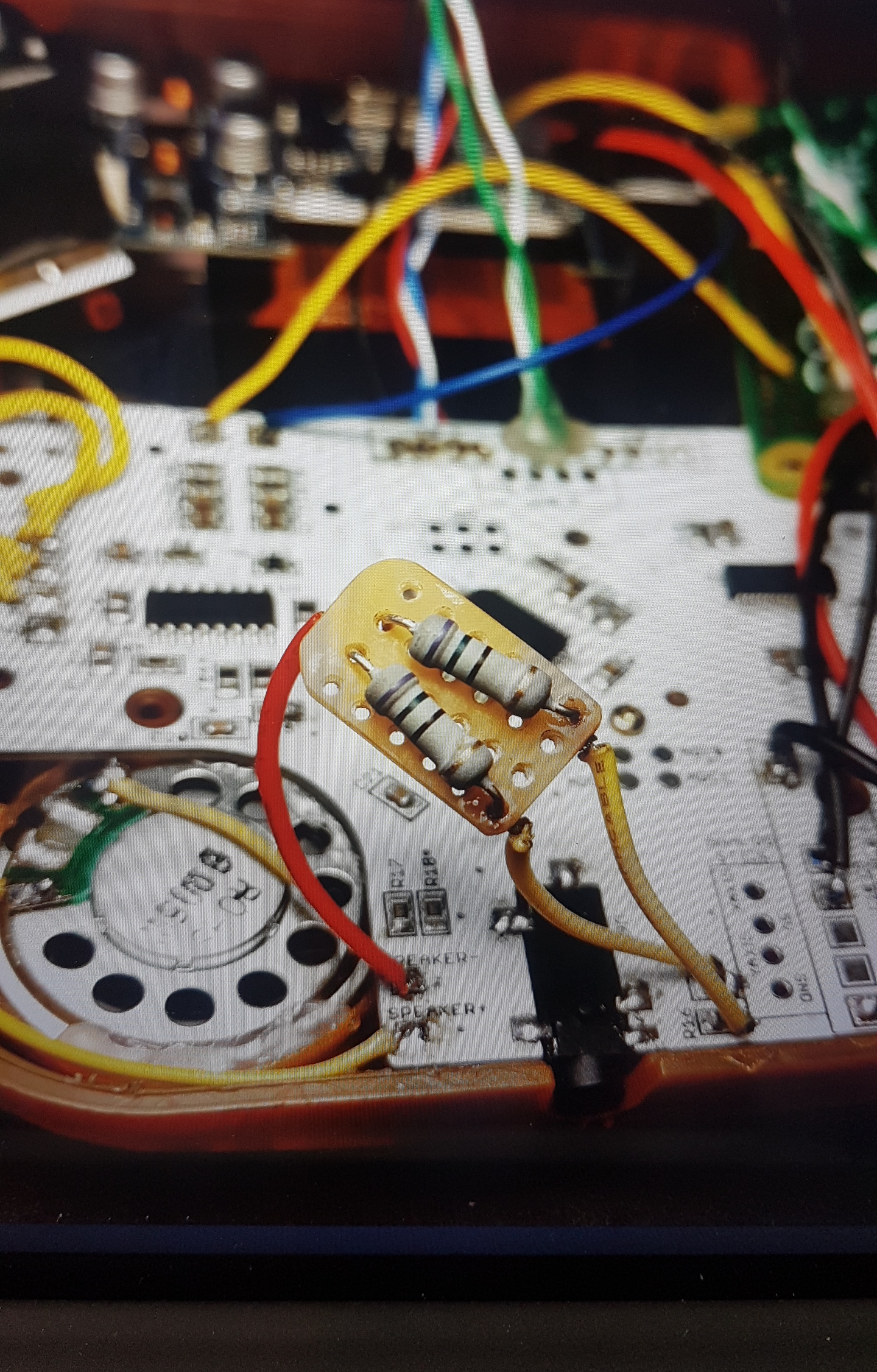

Help needed guys!
So here's the thing.... Finished my build a couple of months ago (see signature) and everything working fine.
Only issue I had was Audio with the AIO board. This was fixed as per @tomatoflames fix adding 75ohm resistors to R15 and R16 then bridging and attaching to speaker as per:
This worked perfectly and I've had no issues to date.
Recently decided to re expose the mini HDMI port that i previously covered up. Opened the case, re aligned the Pi, fixed it down and closed the case.
Oddly I noticed audio dropouts when i increased volume after this. Not terrible but annoying and noticeable. Thought i must have knocked a resistor perhaps, solder joint etc. Opened up, couldn't see anything. Ended up re making the bridged 75ohm resistors on perf board and rewiring. Still no joy.
Decided while I was in there id swap my pi for a new pi zero W and in the process re-wired everything including PWM wires and a new voulme pot.
All working but again...drop outs on sound when loud / normal volume.
Sometimes its not too bad at all. Went to bed last night thinking it was all ok. This morning it's worse than ever.
What have i overlooked?!
