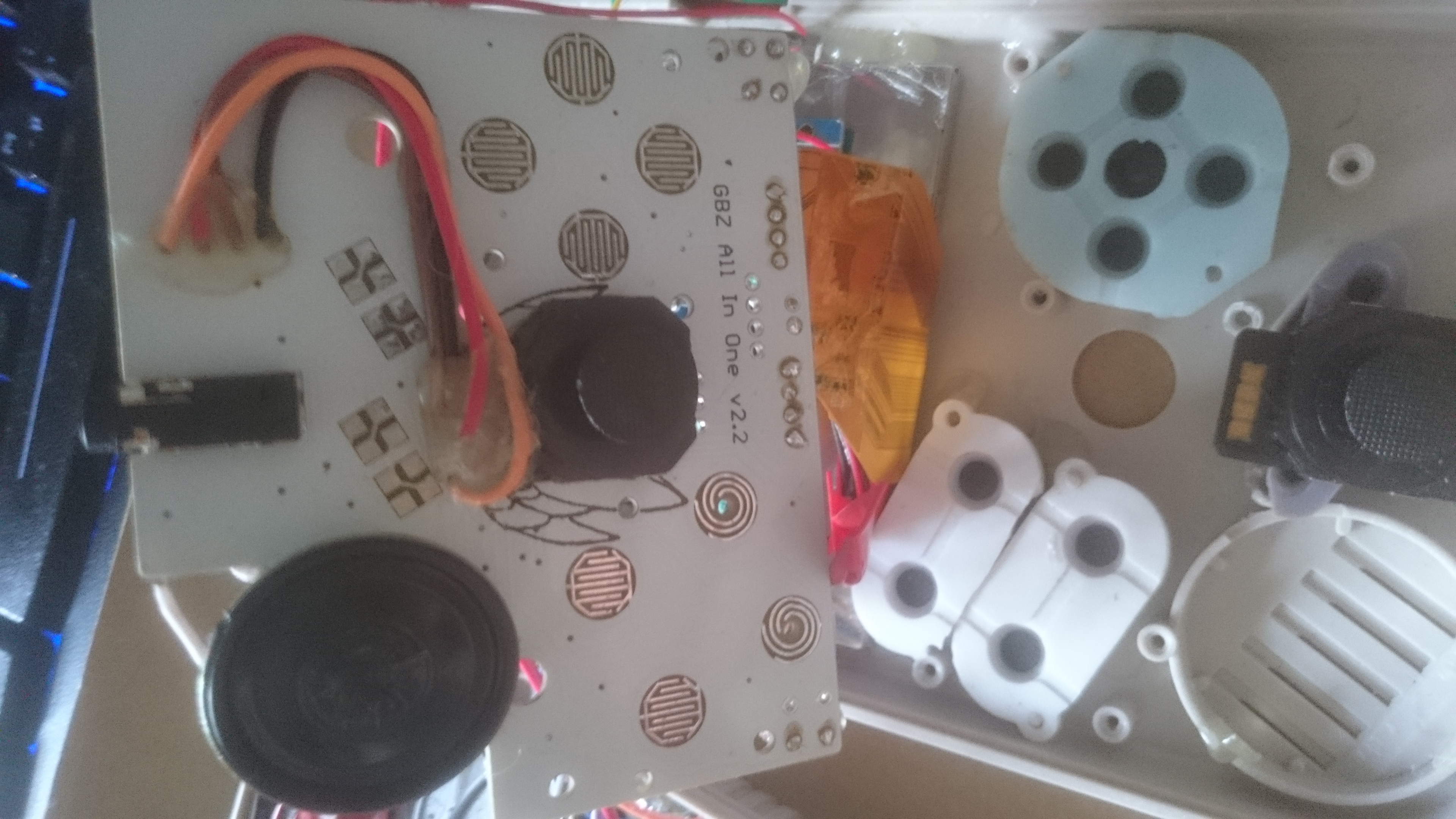

Hello, my L1, L2, R1 and R2 buttons don't seams to work. My wire Set up =
L And R buttons.jpg (615.85 KiB) Viewed 11838 times
did i make a mistake ? the joystick don't work too, the other buttons seams to work. My camera is Junk, so you cant see anything :oops:
analog stick.JPG (2.94 MiB) Viewed 11836 times
Sorry for my stupid english, im from Germany :roll:
Post by Helder » Mon Mar 27, 2017 1:19 pm
The board comes preprogrammed for no analog stick which is why it's not working. In your edited image that looks fine but I can't see your actual wiring to determine anything.
Since you plan to use an analog stick you need to program the board for this and if there was some button issue the reprogram will fix it.
Head over to the "Other Hardware" forum for some guides on how to reprogram the board for analog stick.

Post by LarsH. » Mon Mar 27, 2017 1:42 pm
thank you :D , i didn't now that i need to reprogram it, i already destroyed too joysticks :?
