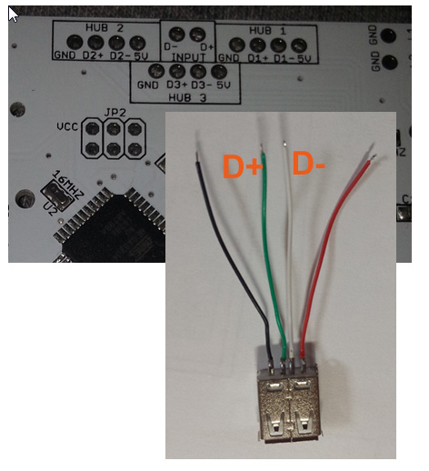

Hi All,
I received my 2.2a AIO Board and connected all as described. And I put in the config.txt and cmdline.txt. The image was fresh. After booting the board was detected as input.
But when I plugged in an USB Adapter for a HUB to connect a USB Stick to test Super Mario the raspberri rebooted. Then, plugged in with the HUB it said no Gamepad detected. Only rebooting again and plugging off the hub let detect the board again.
Is it possible to connect directly an USB Connector to USB Hub 1 Port or does it need a real HUB?
Do you have some ideads?
Best wishes
Michael
Best wishes
Michael

There is a hub on my board so you need to use the marked hubs from the AIO if you want to connect some other usb device. You basically added 2 devices to the Pi in the same and only usb slot it has. I hope nothing got messed up because of it.

Hi Helder, sorry the controller is just ok and works fine but I tried Hub 1 and 2 but I can not use a joystick or a wireless keyboard with it. After booting nothing comes up just like "1 new Controller detected". Do you have a idea? An USB Stick I tried too to connect. The LED of the stick is on but no blinking (writing/reading)
I need to connect an USB stick or a WIFI dongle to bring up Mario

Ok i had the same problem. First check your d- and d+ is connectec correct. Seccond of all not all wireles dongles are working wit retropi check retropi for compately. Same gous with the wireles keyboard
Greets. I can tel you this. It wil work with the right stuff.

I I used all compononets before using the Board. And they worked fine.
And now I do not connect a HUB on HUB 1 - I connect just an USB Plug. So I understud Herder - is that wrong? Can I use on HUB 1 an USB HUB?
