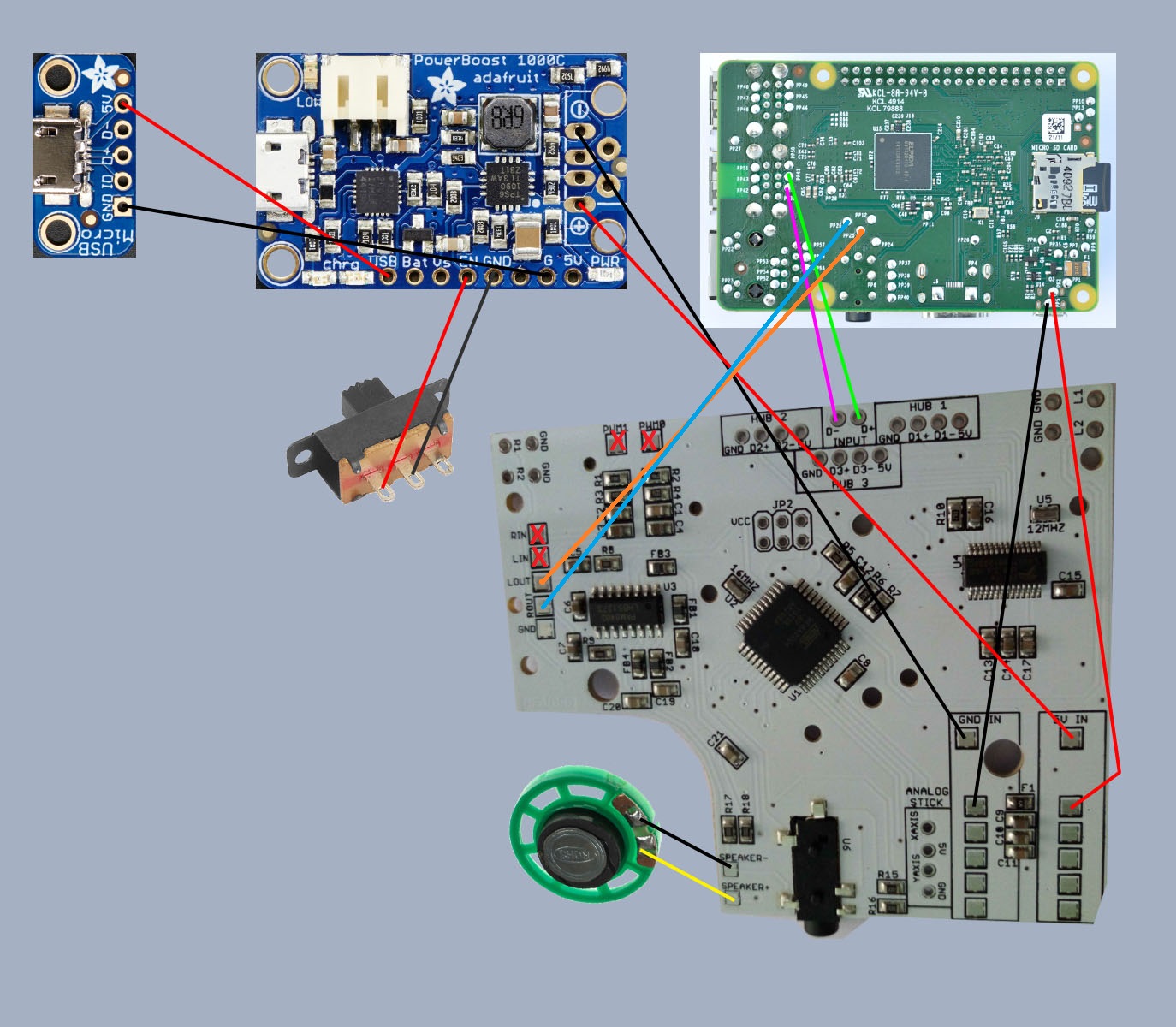

Post by Awesomenatious » Wed May 03, 2017 3:49 am
How would I connect the AIO board to a Pi3, I haven't desoldered anything the pi3 is completely stock. Where would you recommend I solder to? Thanks in advance.

Post by Helder » Wed May 03, 2017 6:26 pm
Ryan
Look up the test pads for the Pi3 and you basically solder the Auido points which I believe are the PP25 and PP26 to the top 2 pins on the volume wheel and skip the whole PWM pads section on the wiring diagram of my board. You will also skip the RIN and LIN pads of the volume wheel pads, everything else is the same as the pi zero with the exception of the 5V and GND pads are likely to be different on the Pi3 than the Zero.

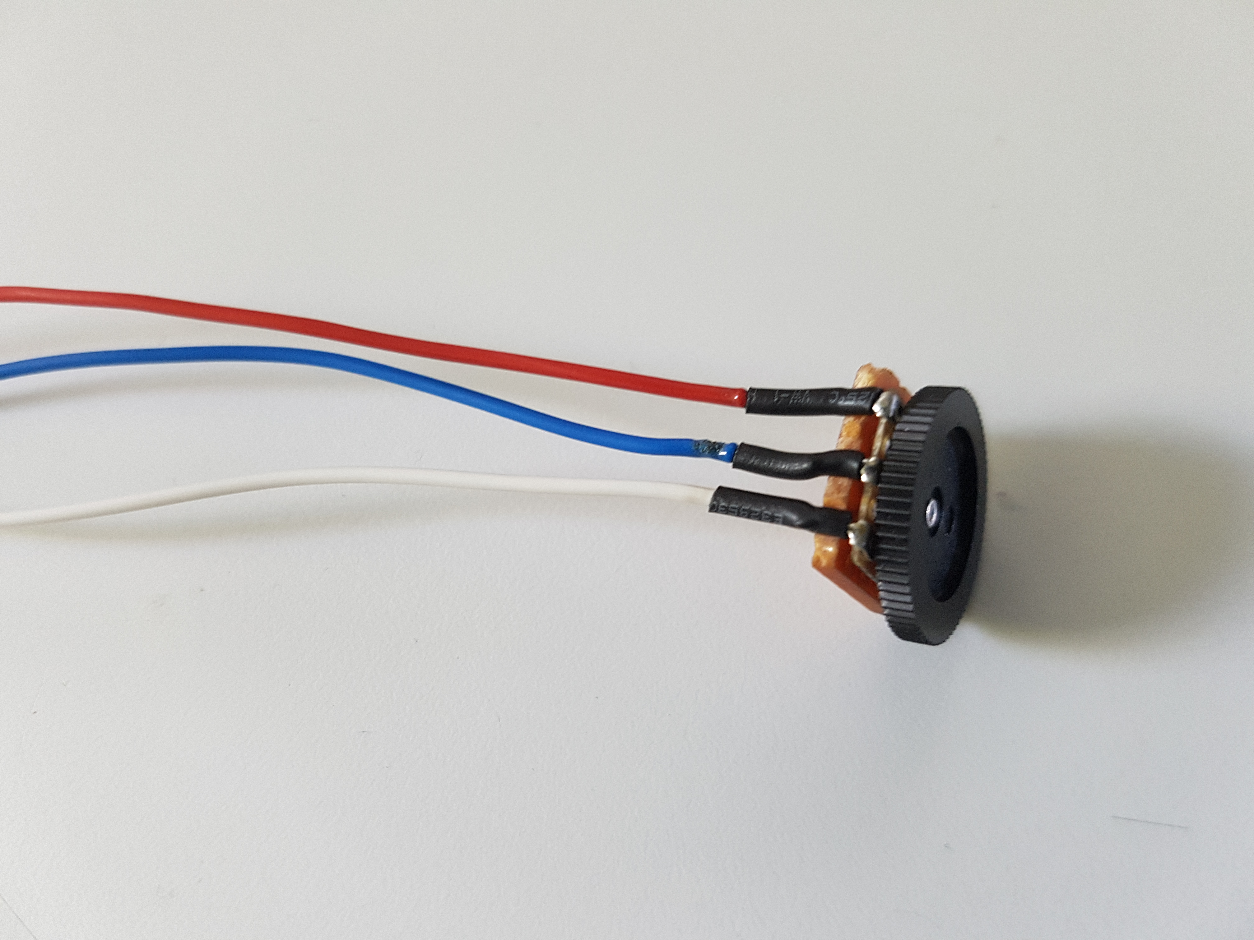

Post by Lololo » Fri May 05, 2017 3:25 am
hello Helder,
thanks for your great board !
I did not quite understand where to put the wheel for the sound with a pi3
i have this wheel :
thanks for your help

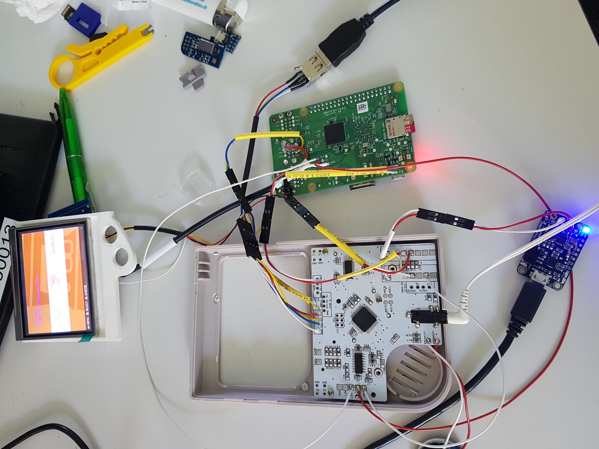

Post by Lololo » Fri May 05, 2017 5:51 am
me again ;-)
I just do a direct connection with the raspbbery to test the audio but I have two problems:
- with headphone jack I have a lot of noise
- with loudspeaker I have no sound :-(
Post by Helder » Fri May 05, 2017 12:34 pm
You have your audio wires too long and directly under the powerboost which will cause alot of noise that you will hear, as for the speaker are you sure it's wired properly? and you also have to remove the headphones for speaker to work.

Post by 144TECH » Sat May 06, 2017 9:23 am
me again ;-)
- with loudspeaker I have no sound :-(20170505_134132.jpg
Hmm, for as far i can see you soldered the audio input on the volume wheel input ?! i think you should use the PWM1 and PWM0 pads for input Left + Right.
Also, your volume wheel will only control one channel L or R , because its a 3 wire wheel (versus a 5 pin wheel wich is dual layered wheel both for controlling the Left and Right channel.
IF you don't hear anything you could change the wiring at the volume wheel pads (for example from L in To R in, or visa versa)
it would also be better to change your config.txt to mono output in this case.
Kind regards 144Tech
