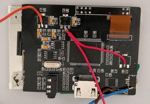

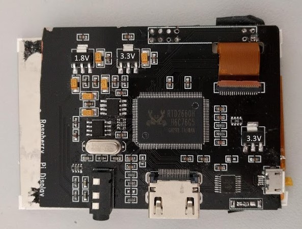

I am using the Kedei HDMI display and have been experimenting with its power supply. It has the DS1117 as well, but three times: one for 1.8V and two for 3.3V. The 1.8V is for the central display controller RTD2660. One of the 3.3V is for the LCD and it's backlight. The other one seems to supply the T25S40 EEPROM including the firmware and the TSC2046 touch controller. The CS4334 D/A converter is powered by 5V. Without 5V supply there is no sound.
I measured the currents and voltages at the beginning of Super Mario Land level 1 with headphones connected, so they can be compared easily.
Supplying the display with 4.962 V from a USB power supply, it draws 394 mA which is 1.955 W.
I desoldered the three DS1117 linear regulators and used 5V, 3.3V and 1.8V from the Pi, as instructed by salami738. These are my measurements:
1.80 V: 77 mA = 0.138 W
3.32 V: 234 mA = 0.777 W
4.97 V: 13 mA = 0.065 W.
In total this is a consumption of 0.98 W. That's half of the power it draws when the linear regulators are used!
Thanks to salami738 for his guide! I will be modding all my displays for future builds. This improves battery life and reduces heat inside the case.

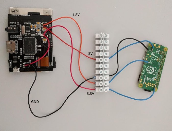

can you give a better look on how you have it wired up to the Pi/Build....
as the images you provided have several wires connected to the screen, where do these wires go

Here's my test setup:

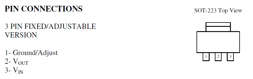

salami738 wrote:
Wed Dec 06, 2017 1:42 pm
GND can be connected to any of the original pin 1's where the DS1117 were, 5V to any pin 3:
Re: [GUIDE] 3.5 inch HDMI Display - high energy usage

"We usually supply the display with 5V. The display shows inefficient linear regulators to produce 3.3V and 1.8V. You can remove the voltage regulator and pick up the required voltages directly on the Pi. In my test setup, I was able to reduce the consumption of the display from 1.955 W to 0.95 W. This extends the battery life and reduces the heat in the case. The only downside is just two more cables from the Pi to the display. The 5V to the display will continue to be needed for the soud."
IMPORTANT: The 3 linear regulators (red marking with inscription "REMOVE") must be removed, otherwise there will be nasty short circuit!
