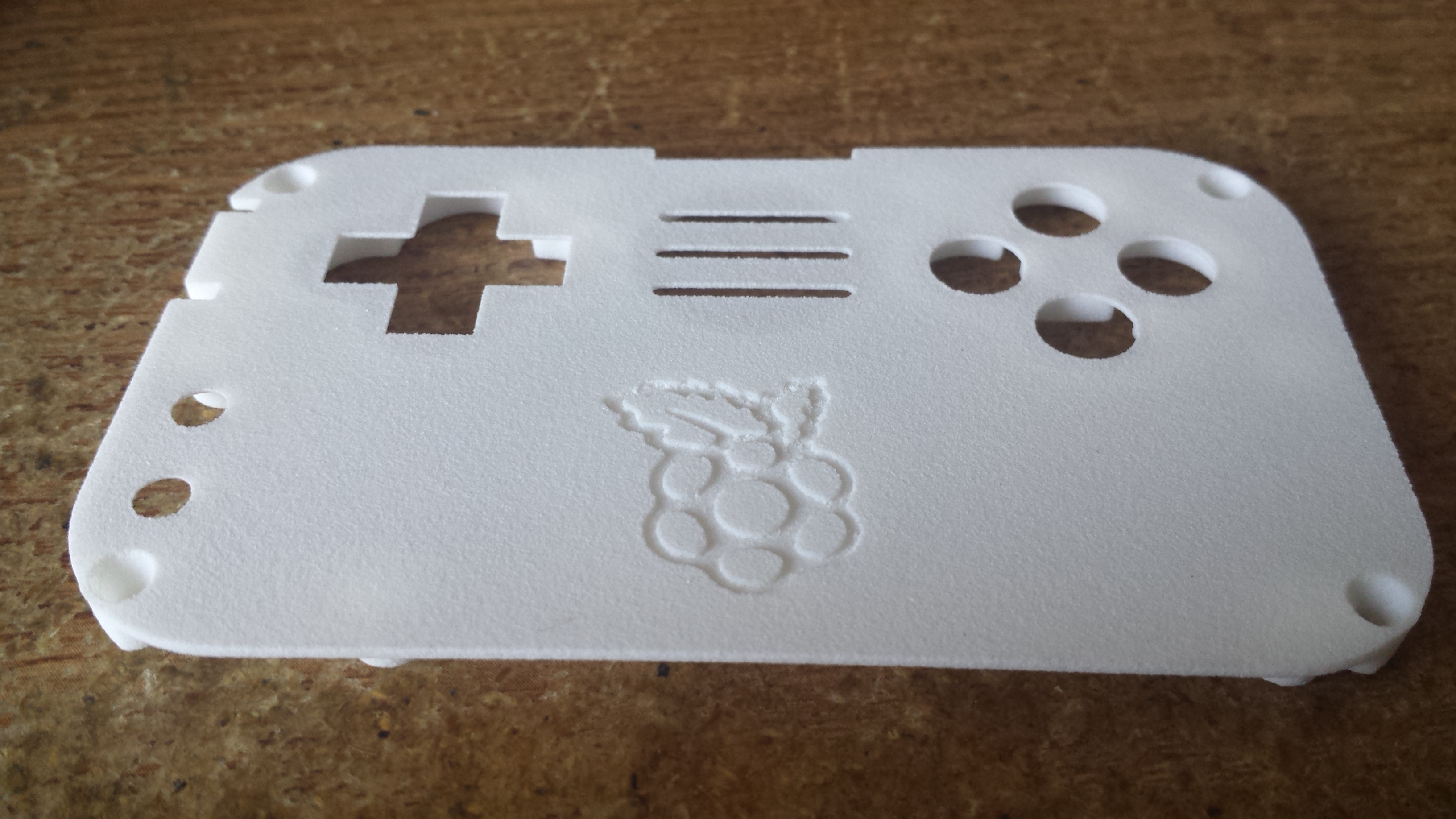

Turns out SLA probably isn't the best option, due to the finished parts being incredibly brittle! I'm going to try another alternative, selective laser sintering (SLS), using nylon. It will be a much more durable finished project.
Since the only piece I'm having an issue with is the faceplace, that's the only part I'm having made. I'll post pics once it comes in. Should be about a week.

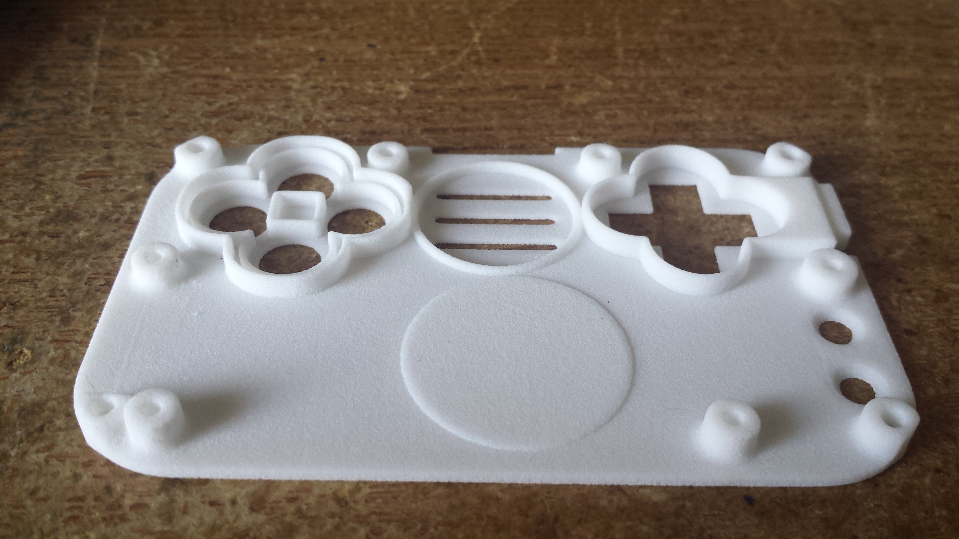

Just got my nylon faceplate!
FrontShow
nylon print front.jpg (1.65 MiB) Viewed 13380 times
BackShow
nylon print back.jpg (1.75 MiB) Viewed 13380 times

Looks nice!

Can you say what the price?
