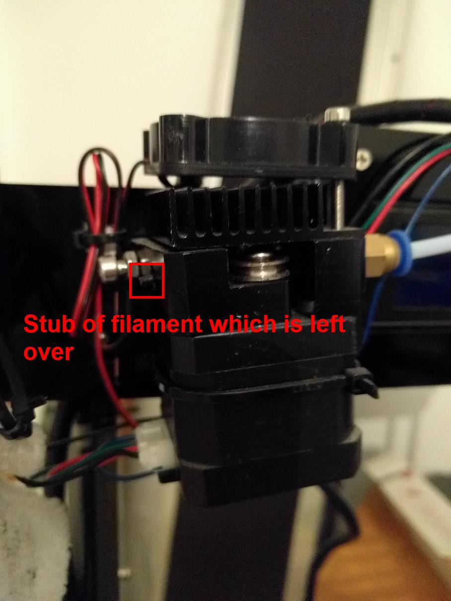

A friend out of the blue gave me his Anet A8 printer, because he's busy as hell...
I can't get it to work, and since the thing seems to be heavily modded already it's hard to find reliable information on what's the problem.
The problem: No filament coming out of extruder ("air printing"). I figured out that the extruder is probably congested, and additionally I don't know how to properly change the filament (pull it out? print it out? Just fill new filament after the last one?)
Anyone can tell me how to open the extruder / change filament or point me in the right direction (guides / tutorials)?

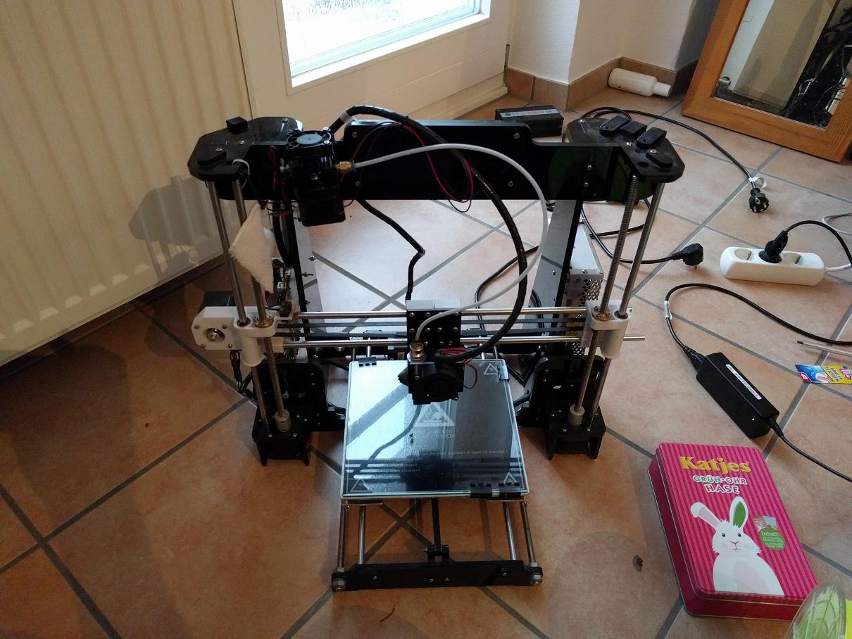

First off, can you post some pics of the full printer? It looks like they've modified it from a direct drive to a bowden tube setup, which would mean differences in filament removal.

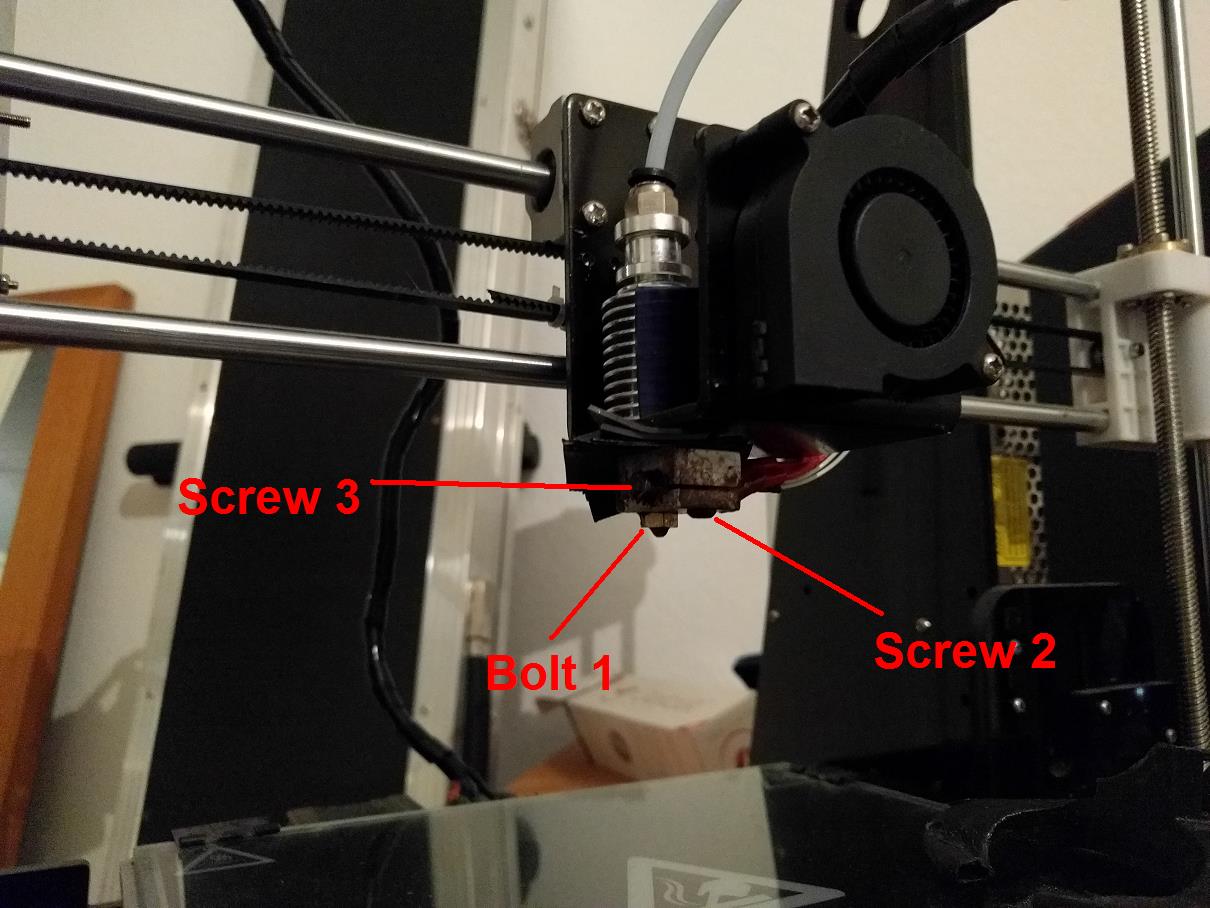

For your first photo, bolt 1 is your nozzle. Screw 2 should be securing your heating element. Screw 3 should be holding your thermistor.
The first thing I'd suggest is some basic troubleshooting:
Is your hot end heating up? (this is the part that you're calling the extruder) If it's not getting hot enough, you won't be able to extrude any plastic. You should be able to feel heat radiating off the hot end. If it is heating, you can try poking an acupuncture needle in the nozzle to feel for clogs.
Is the extruder turning? That's your 'filament inserter'. It feeds the filament into the hot end, so if the gears aren't turning, it can't push anything. You'll probably have to remove the fan(?) and heat sink(???) from the extruder so you can see any movement.
Is the filament stripped? If the gears are turning, it's possible that they've ground down the filament so the extruder can no longer push it. Again, you should be able to see this when you remove the heat sink.
It also occurs to me since I'm assuming that it's left over from the previous owner... what kind of filament is in the printer? If it's ABS or Nylon or something, and you're trying to print at PLA temperatures, the machine will definitely struggle. Maybe try bumping up the temperature to 260`C? (does the A8 have an all-metal hotend? Can it go that high?).
To change the filament, you need to remove the old stuff. To remove the old stuff, you need to heat the nozzle to your print temperature, release the extruder (there's a spring-loaded lever you'll have to squeeze to open the gears), and pull it out. You don't have a lot of filament sticking out though, so if you can't grab it with a pair of pliers, you may need to release your bowden tube - squeeze the plastic ring down (away from the white tube), and pull on the white tube to release it from the brass fitting. They're a pain in the ass to remove though, so don't be surprised if it's a struggle. You can't print it out because the motor pushes it through the tube and out the nozzle, so once it goes past the motor, there's nothing to push it.

Here's a pic of the entire printer:
Anet A8Show
The hot end is getting hot, the printer heats it to 190°C and all filament I have is PLA!
ICMF wrote:
Sat Nov 11, 2017 5:42 pm
I didn't check, since there's only a stub of filament left. Instead I tried to change the filament the way you explained it, but it is stuck. Even after squeezing open the gears, I tried to pull it out with force to the point where the filament broke. Now I'm left with ~1mm of filament to work with :roll:
Ok so why is the filament so heavily stuck? And do I need to remove the bowden thingy now?

That's kinda weird. I thought they shipped as direct drive printers. I guess modding it to a bowden would lighten the print head and help with ringing, though it introduces its own set of issues. Must be a grass-is-greener thing - people with bowden printers seem to envy those with a direct drive because of their ability to print flexibles.
Anyway... with that setup, you can definitely remove the fan and heatsink from the extruder motor up top. They are doing absolutely nothing for you. In the long run, it might be worth re-locating that fan back down to the hot-end, especially if you're printing PLA. But obviously, that's after you get it running. :)
I'd try going hotter. Try 210 or 220. It's probably not going to solve the problem, but it might help.
If the nozzle is getting hot enough to melt the plastic, it means that either something is preventing the filament from coming out the nozzle (blockage), or from feeding it through the extruder. Unfortunately, that short stub of filament is going to complicate testing both.
I think your best bet would be to remove the bowden tube so you can troubleshoot more easily. It's actually not about removing the bowden per se (it's just a tube; it's not the problem), but disconnecting the filament from the extruder and giving you more filament to work with.
To release the tube from the brass fitting, you need to press the blue plastic ring down, towards the fitting, then pull out the white tube. Since you've got filament in the tube, you will also need to hold the lever on the extruder open, so it's not grabbing the filament. This will be a lot easier to do with two people.
If you can't release the tube (they can be a pain in the ass), you may need to unscrew the brass fitting.
Once the filament is completely free from the extruder, you can test the extruder to make sure it's working. Go into the menus on the printer and manually move the extruder - if it turns, it's fine.
You'll also have a longer length of filament to grab onto, so you can check the nozzle. Heat it up to print temperature, then try pushing a bit of filament through. Not a lot - a few mm should be enough - you just need to see if anything comes out the nozzle. If plastic comes out, then at least you know the filament is moving, so you should be able to pull it out of the printer now. If *nothing* comes out, you've probably got a serious blockage. For blockages, this is a really good video: https://www.youtube.com/watch?v=g8uvh6kvr54
Aaaaaand that was my problem! I removed the tube and gave it a strong push at 215°C and litterally a cloud of dust came out of the nozzel...
But it's working now:
