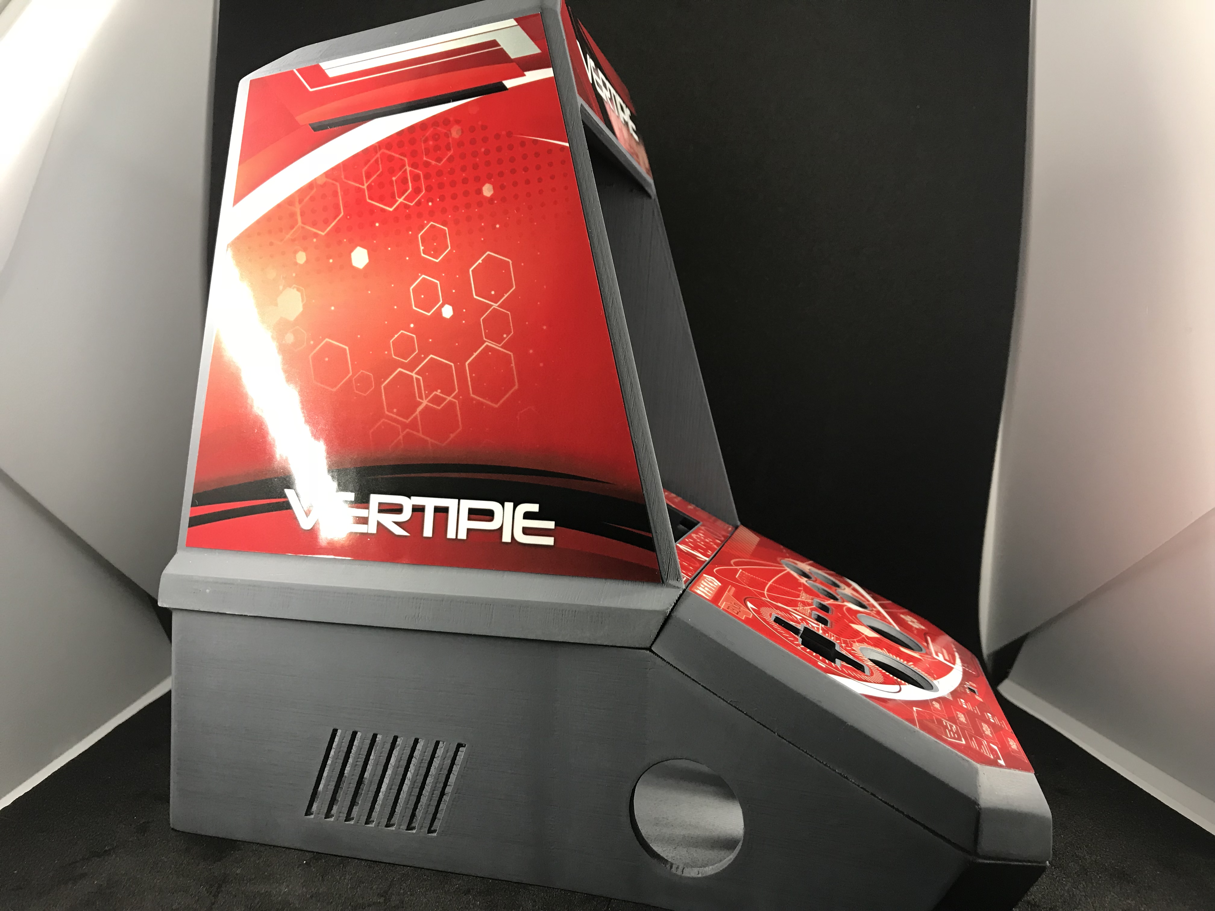

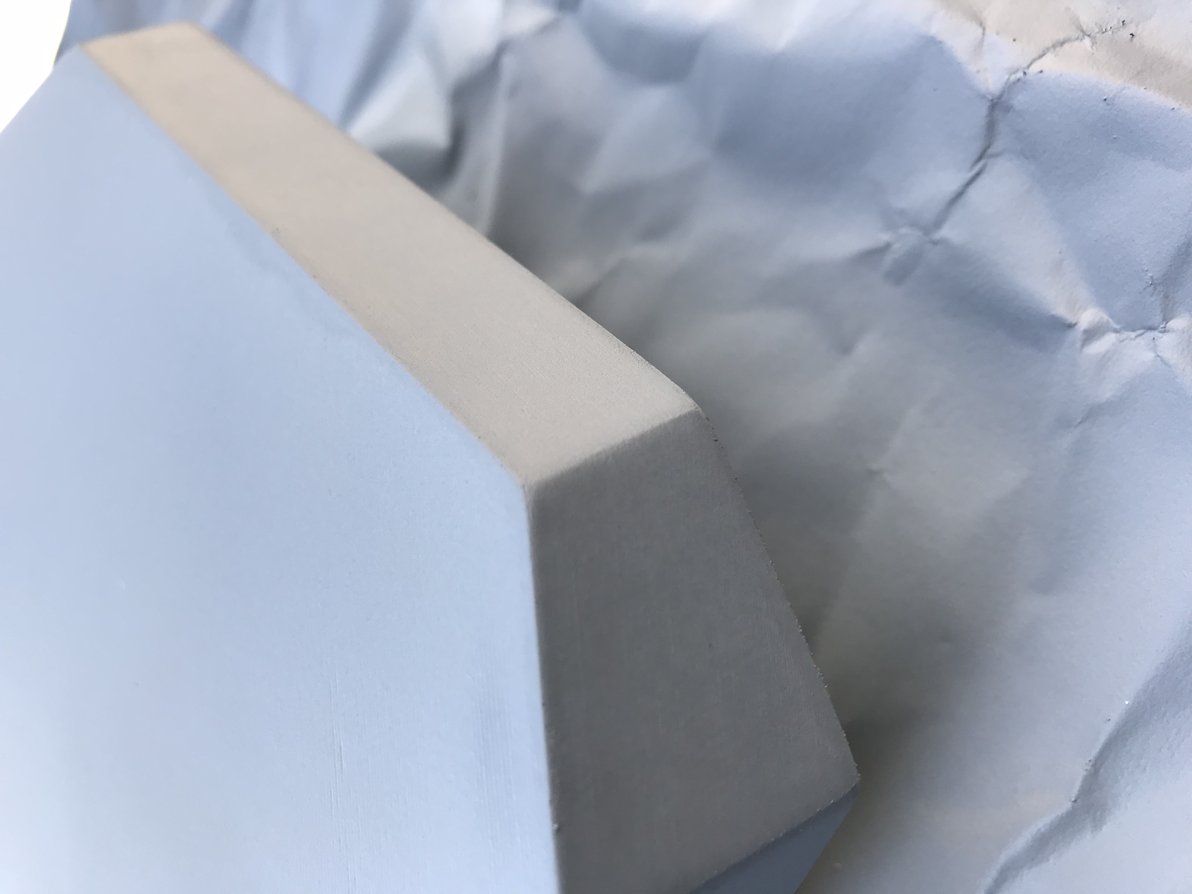

Re: Finishing 3d parts
Post by YaYa » Sat Jun 23, 2018 2:43 pm
I am using automotive grade products for primming, and coating. It’s a German brand named Spray Max.
I am using 2k components.
Start sanding 200, two times, then priming, then sanding again 200, then priming, then sanding again 200, then priming, then sanding again 200.
It’s almost perfect then for painting.
See pictures
