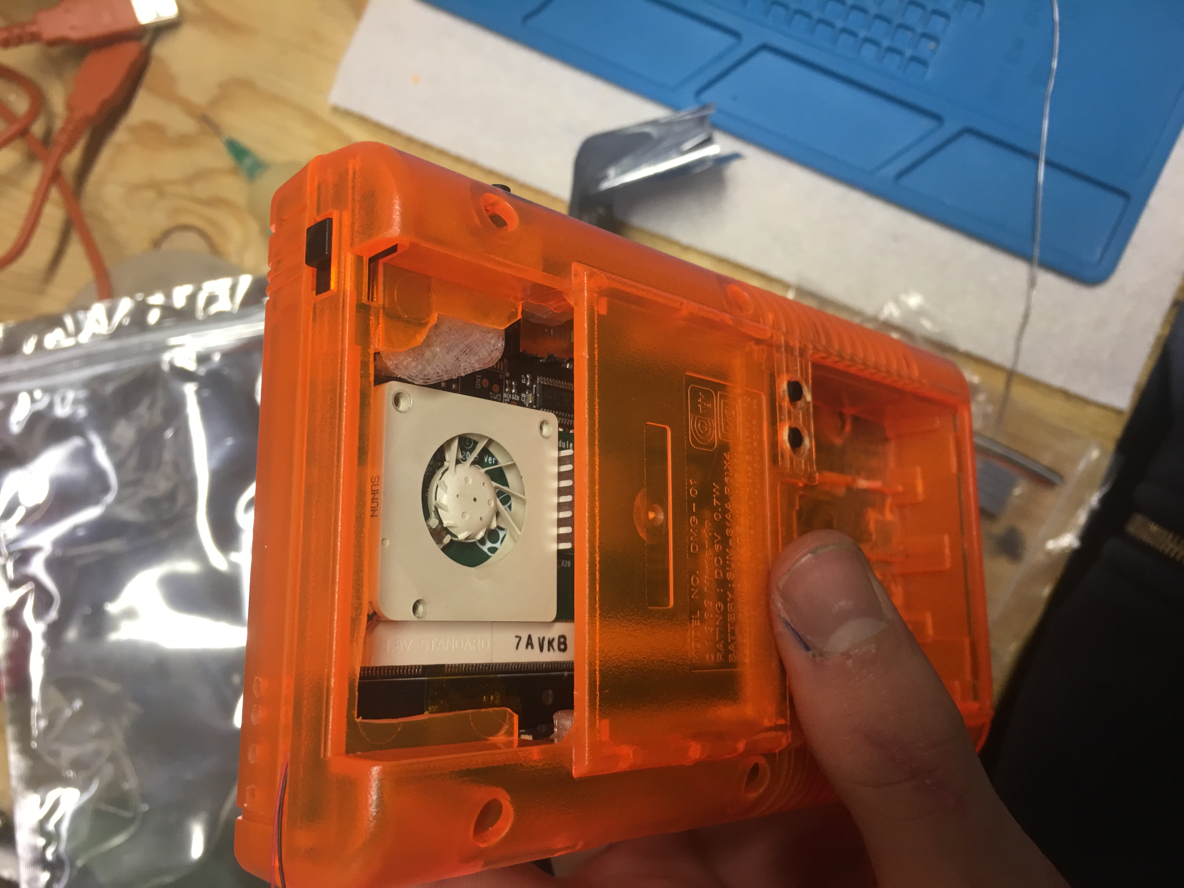

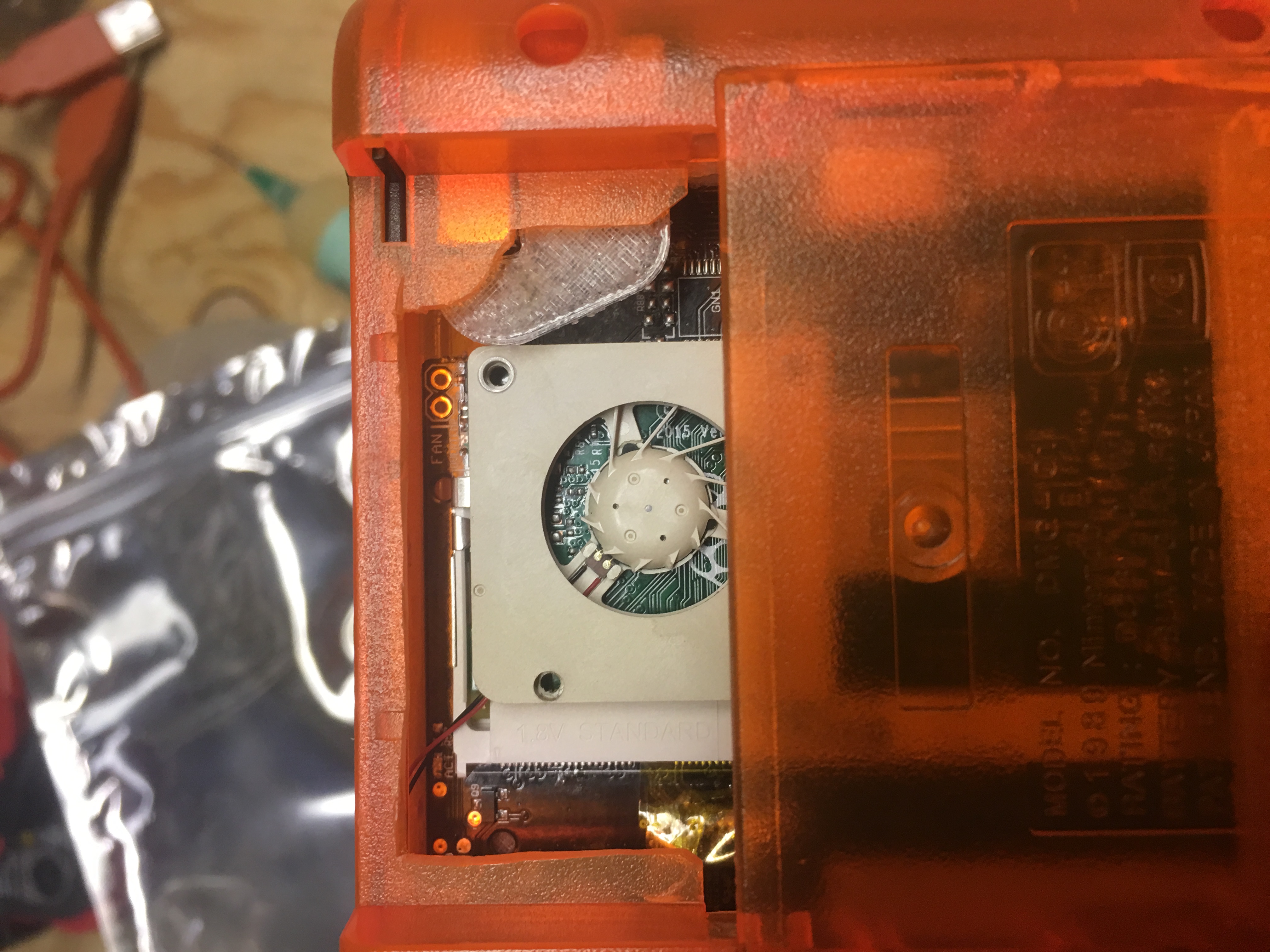

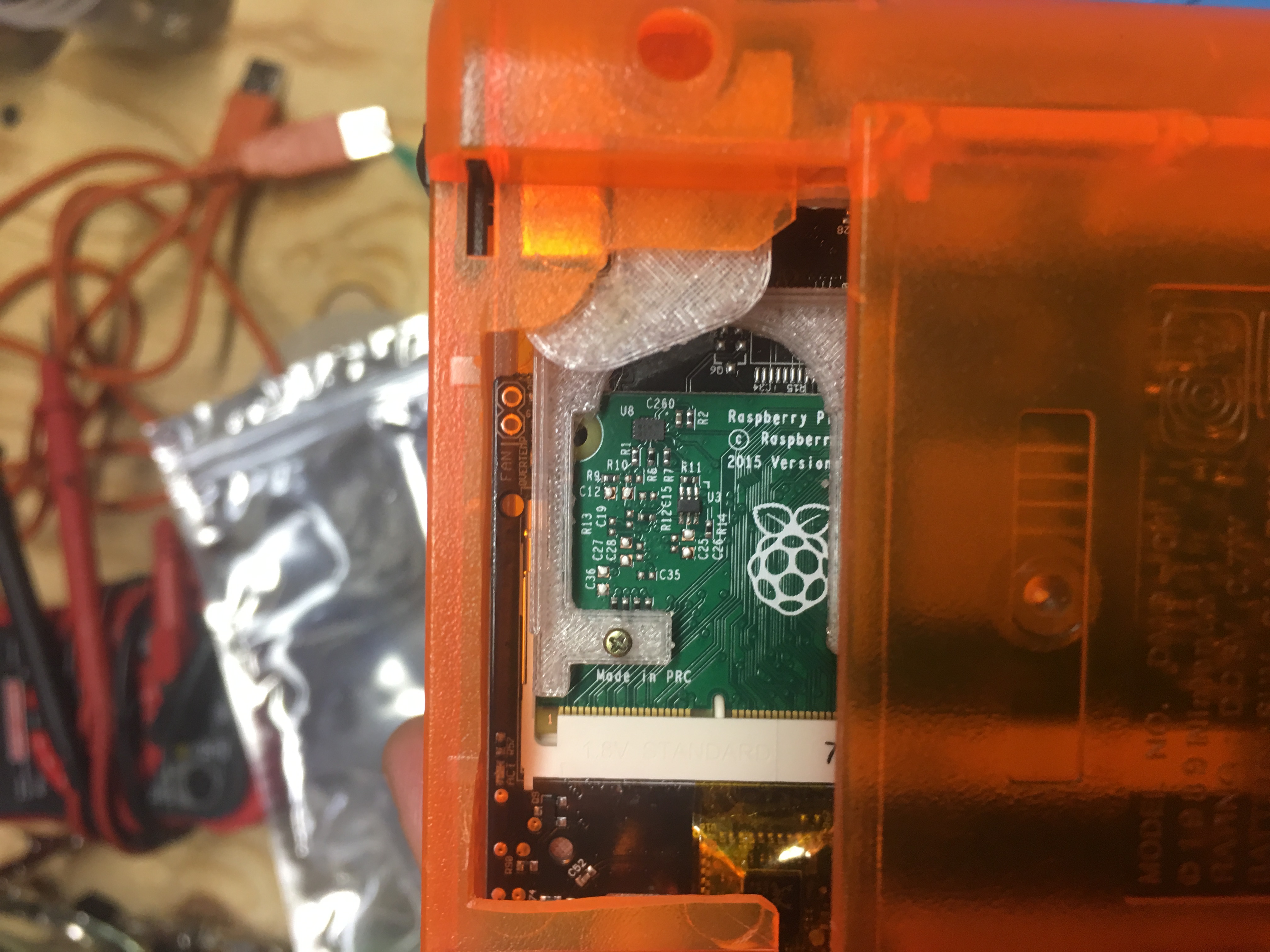

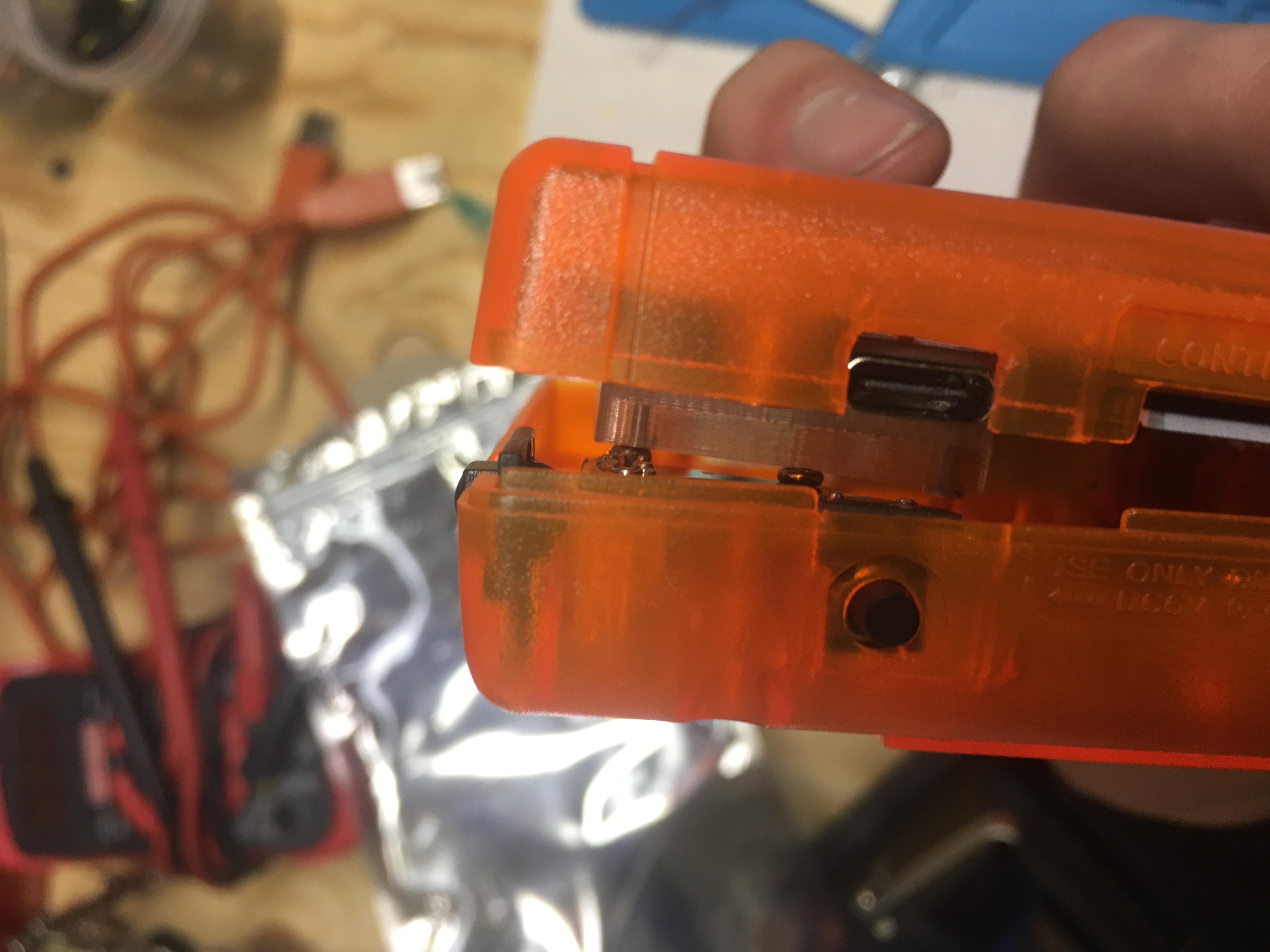

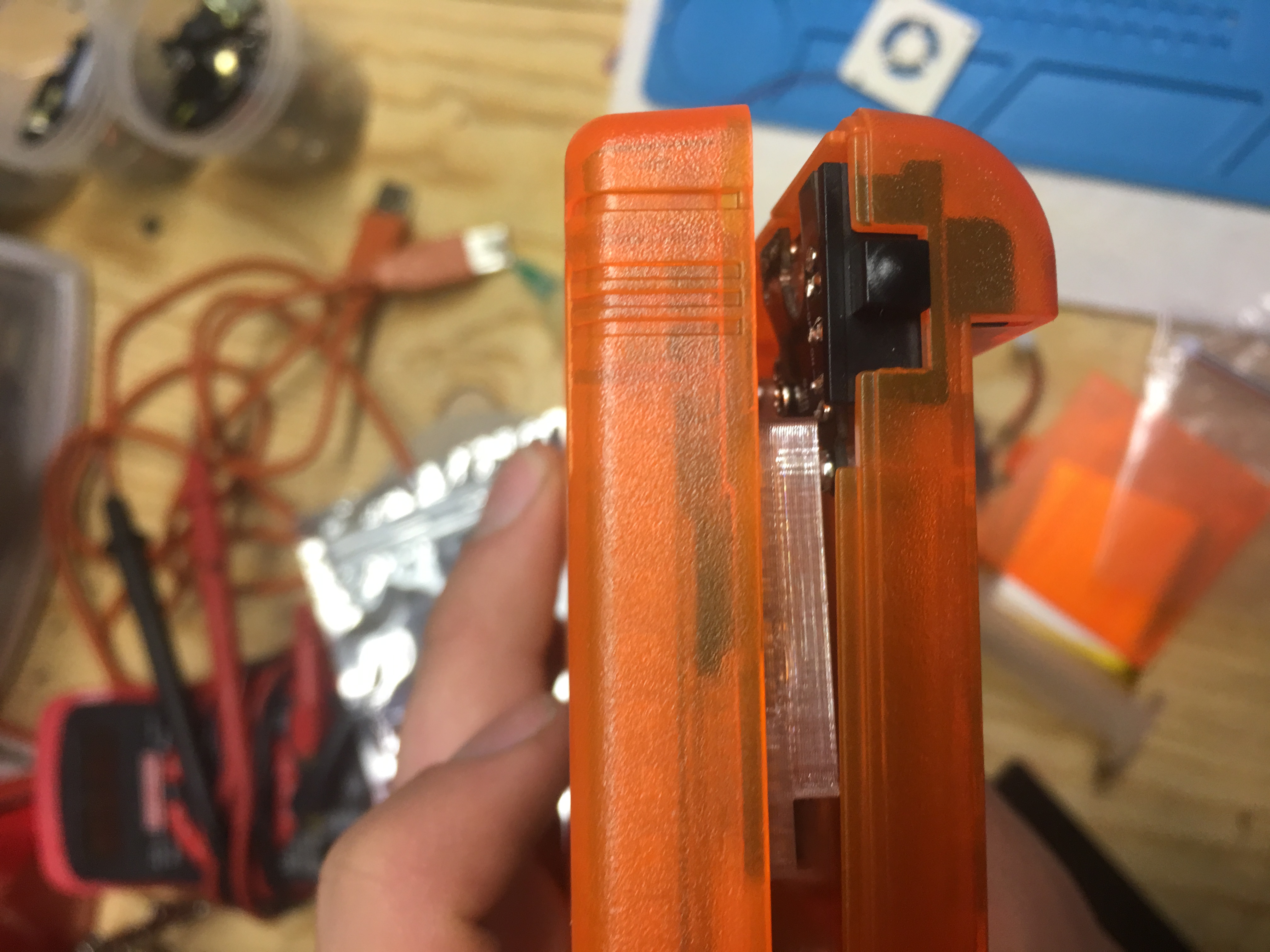

Hi, I am in the process of assembling my gameboy using Kite's Circuit Sword and I found that when using the included switch/mode PCB and the 3D printed bracket HoolyHoo created https://www.sudomod.com/forum/viewtopic.php?f=58&t=5321, the switch/mode PCB mount interferes with the fan mount. From the 3 pictures below the top right corner of the bracket is hitting the PCB/Mount.
But when I place the fan around 2-5 mm to the left (As shown below in the 2 pictures) it fits perfectly with room for it to be raised up (for better airflow from the exhaust of the fan) like it is in the original bracket.
If I tried I could probably convert the STL to a file I can modify in Fusion 360, but I though it was more appropriate to bring this to your attention since this is a work in progress. I believe if the bracket was modified by moving the PCB grips/clips over to the edge of the right side of bracket or maybe farther it would fix this issue.
Thanks for your hard work on this mount, it makes a very clean install inside my translucent case!

Nicode70 wrote:
Wed Feb 28, 2018 1:31 am
Do you think that removing the top screw on Hoolyhoo's bracket could solve the problem without compromising the fixing of the power board to the bracket?
The top screw of the bracket is in my opinion important for keeping the power switch securely mounted to the frame so it doesn’t wiggle around and gives it an authentic feel. It can probably be removed, but glue will be needed to hold it in place.
I do not plan on trying this since I would like to get as clean of a product as possible (with exceptions for my mess ups) and making enough room for the current fan bracket design will require modification to the PCB and bracket that I don’t have an interest in doing.
