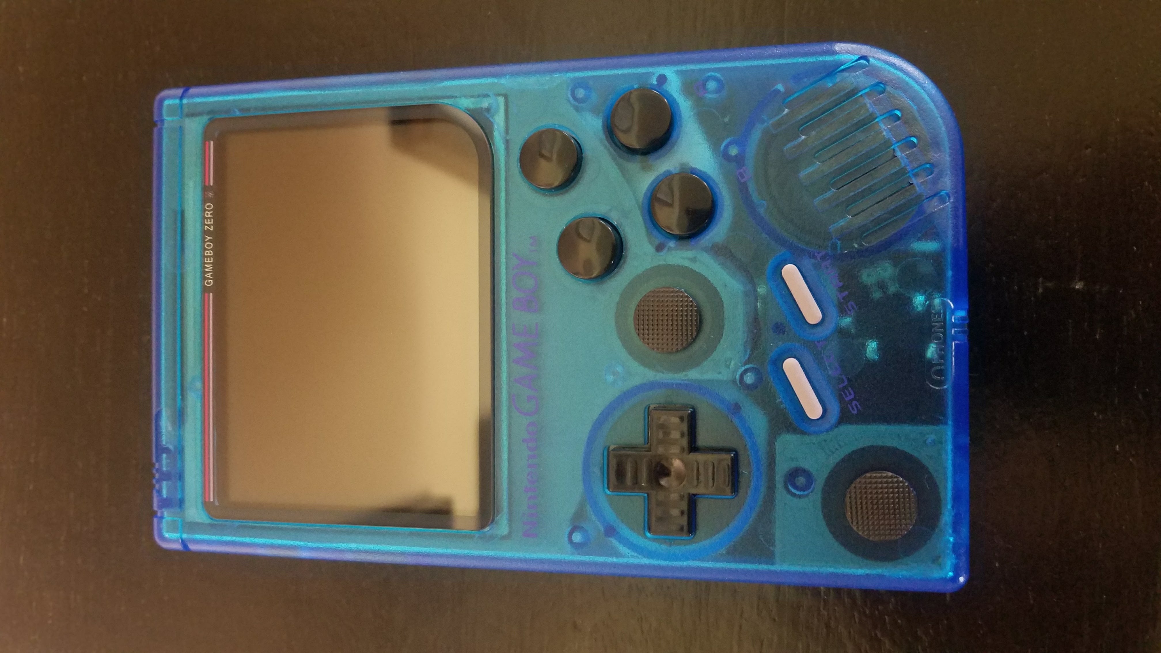

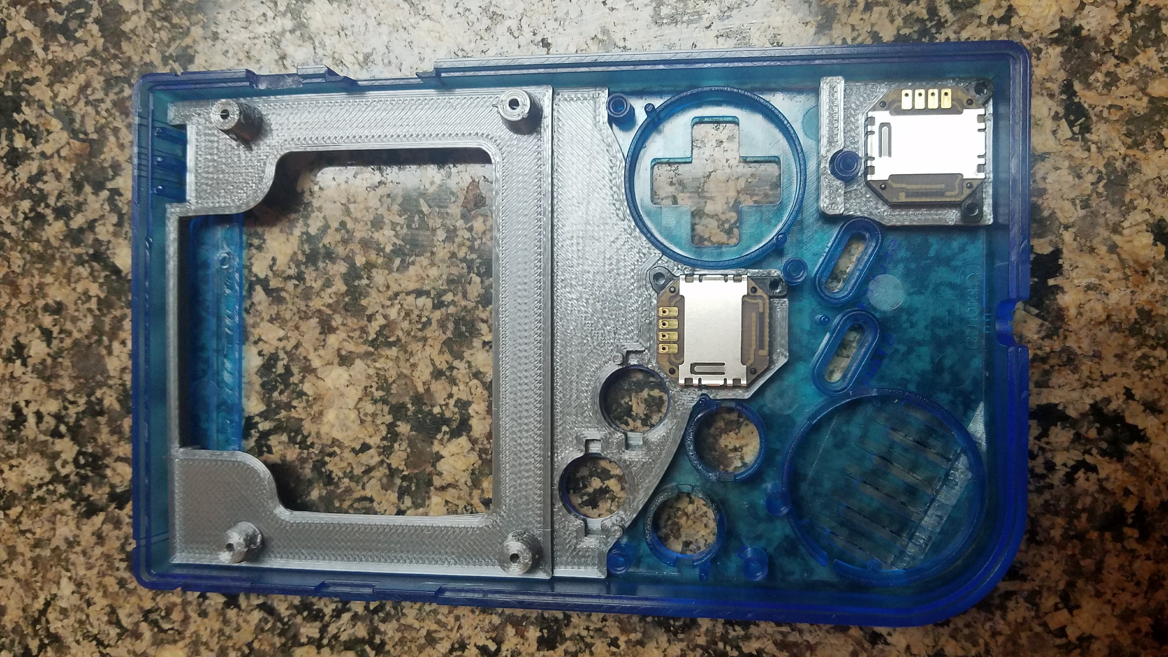

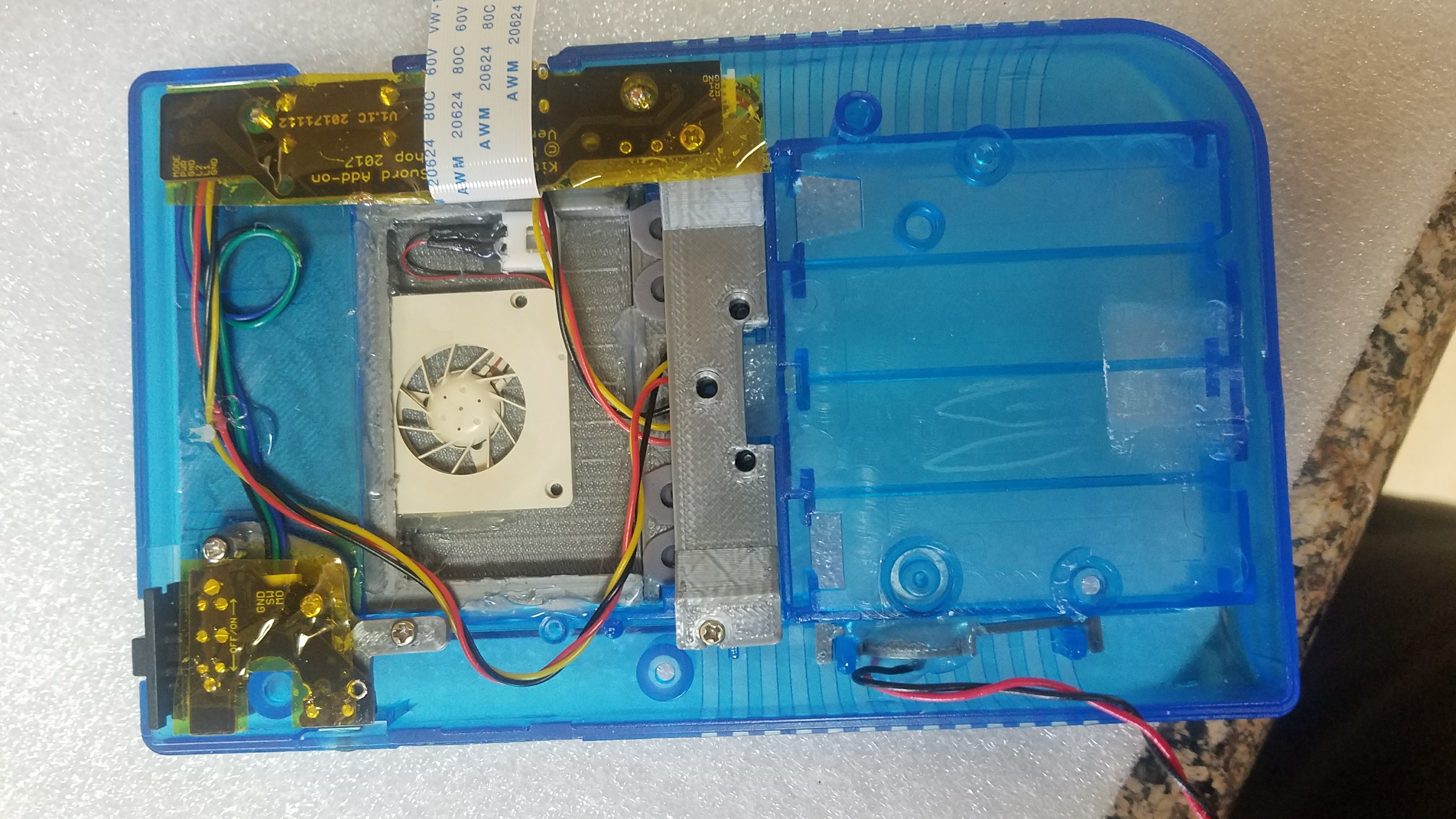

First is a joystick in the bottom left of the case. You will still need to epoxy it down. The screws are from Amazon M1.8x5mm https://www.amazon.com/gp/product/B01FK ... UTF8&psc=1. You will need to clip off a couple of mm to make them short enough so they don't push into the case when you screw the joystick in. The gameboy case is so thick you may need to add a piece of paper in the joystick cap to make it extend a little longer. Ensure the bracket is glued as close as possible to the case so that the joystick is as low as possible when mounted. Solder your wires from the right and wrap them around and up the hole through kites board - if kites board presses too hard on the back of the joystick it can make it not return to center - don't forget your kapton tape! I designed my own center joystick holder and modeled it off of @HoolyHoo 's Screen Bracket w/joystick. Since my design is basically the same as his I won't be posting that here.

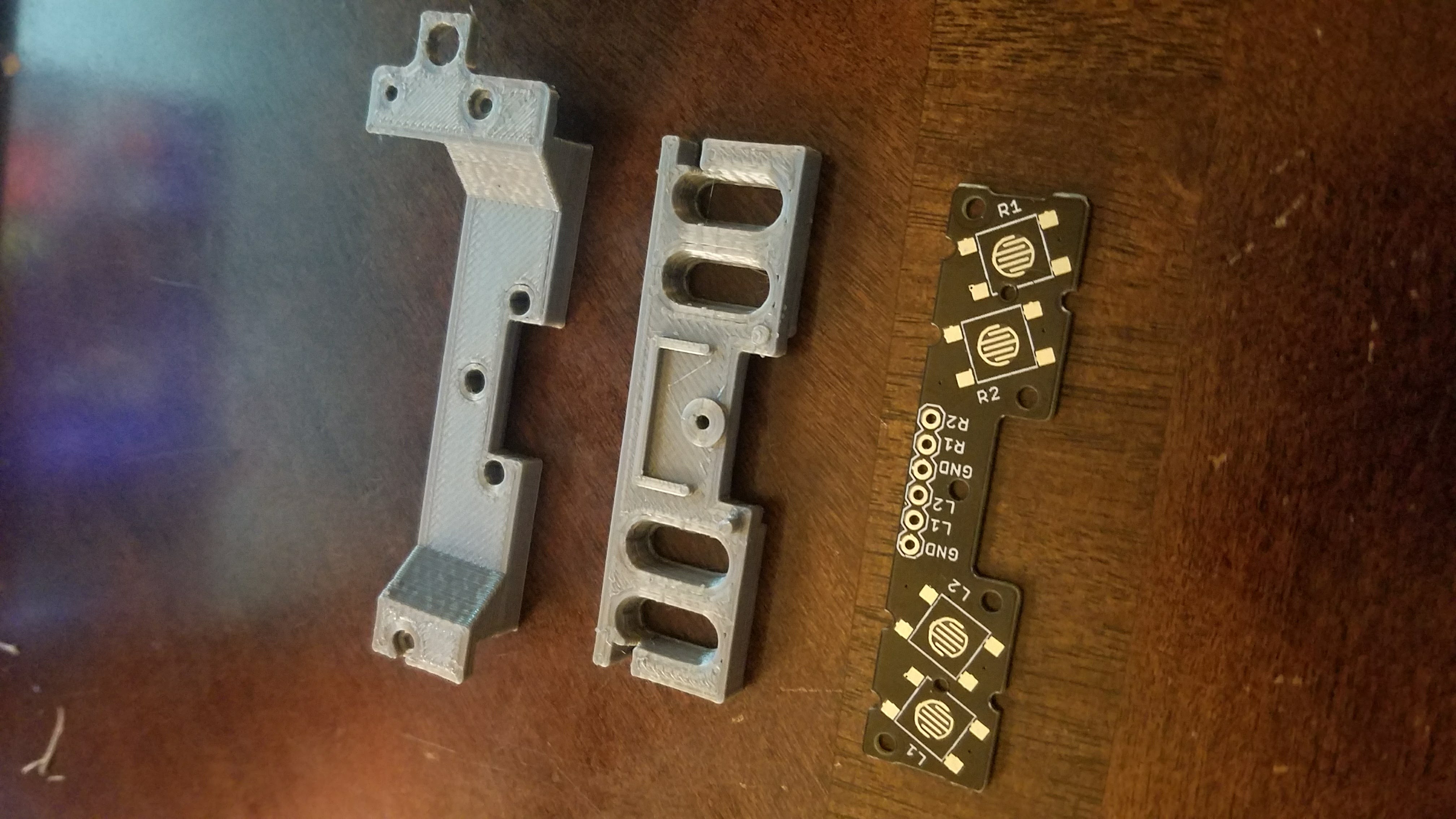

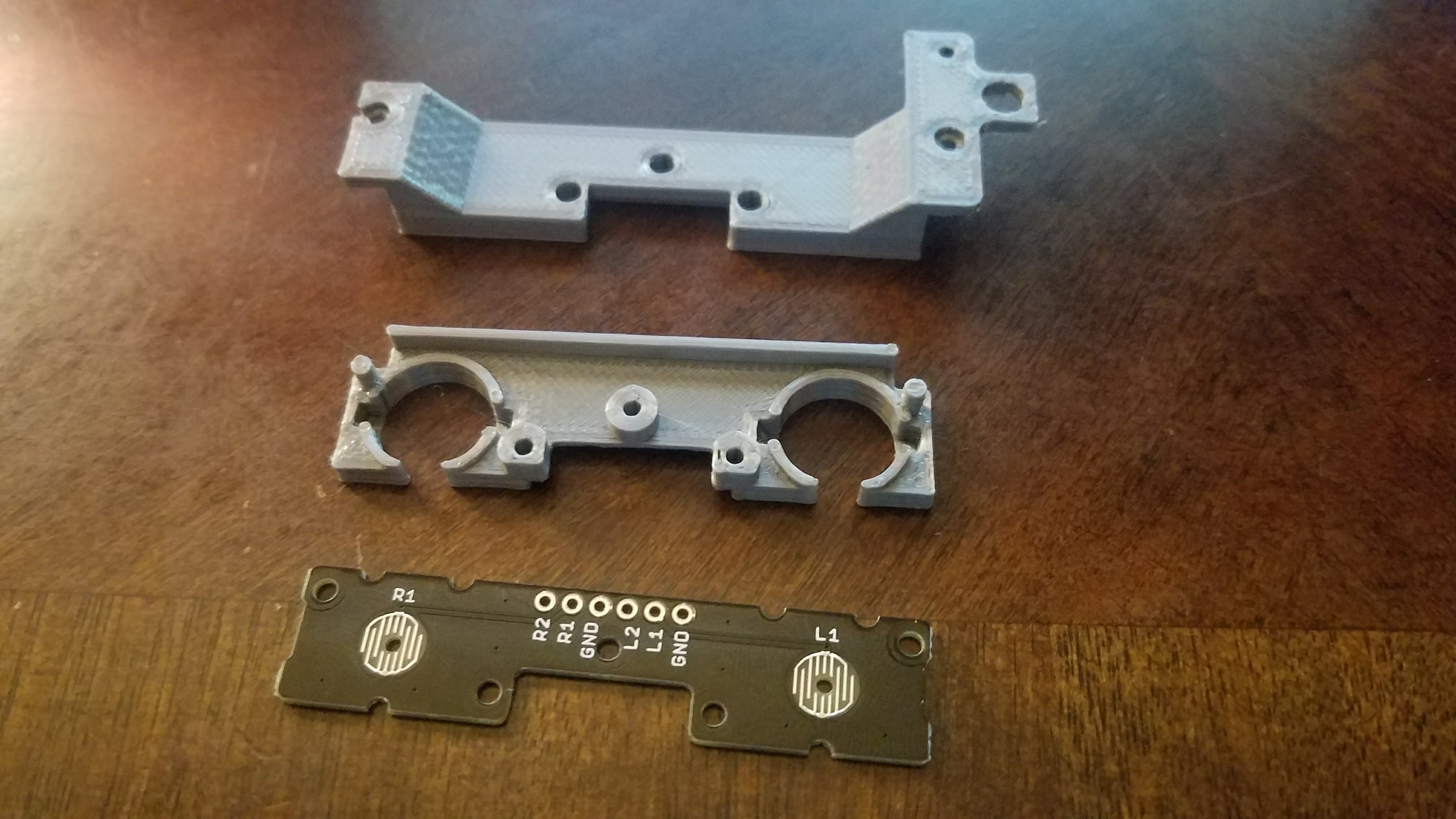

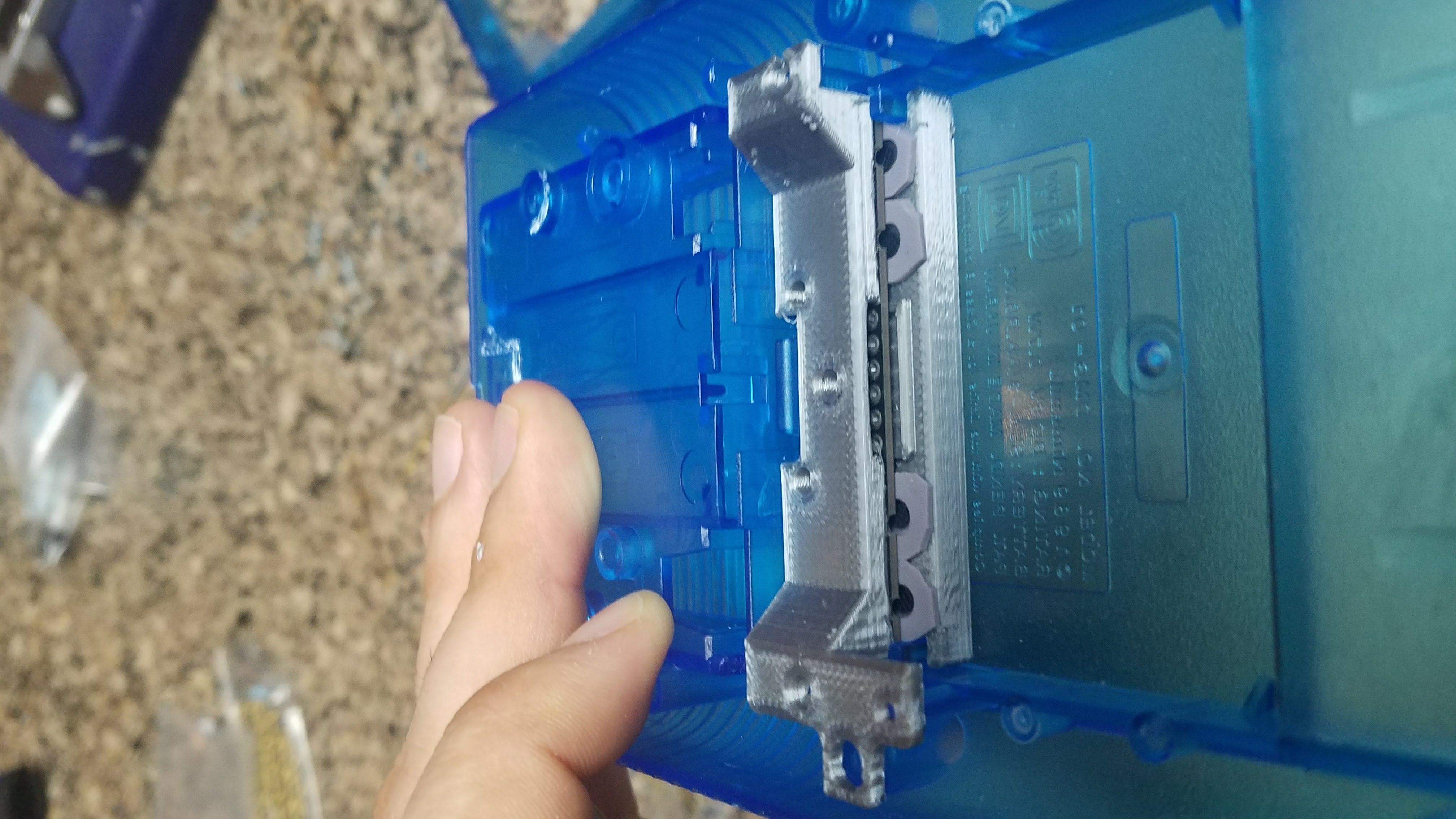

Second is my back button design. I really like how the the start/select buttons feel and look so I made these files. This works with Kite's back button board. The drill guide is for a 2mm drill and the final drill diameter is a 3mm drill.
Start Select Shoulder Guide.stl
(135.53 KiB) Downloaded 1925 times
Start & Select Back Button Bottom.stl
(632.11 KiB) Downloaded 1677 times
Start & Select Back Button Top.stl
(98.03 KiB) Downloaded 1766 times

Here are some more back buttons... it uses the standard DMG buttons/pad
Two button Top.stl
(96.47 KiB) Downloaded 2062 times
Two button bottom.stl
(149.5 KiB) Downloaded 1996 times

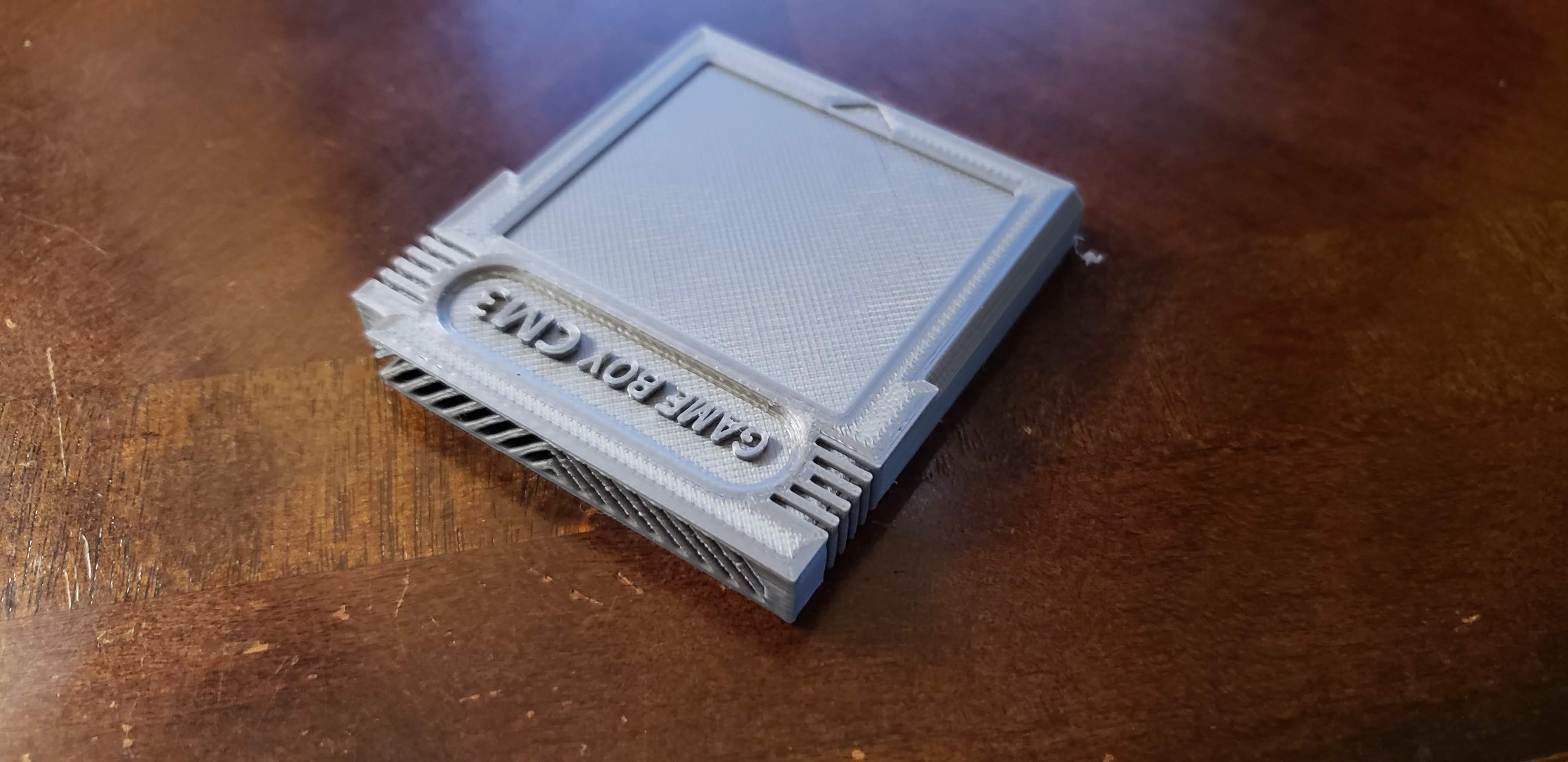

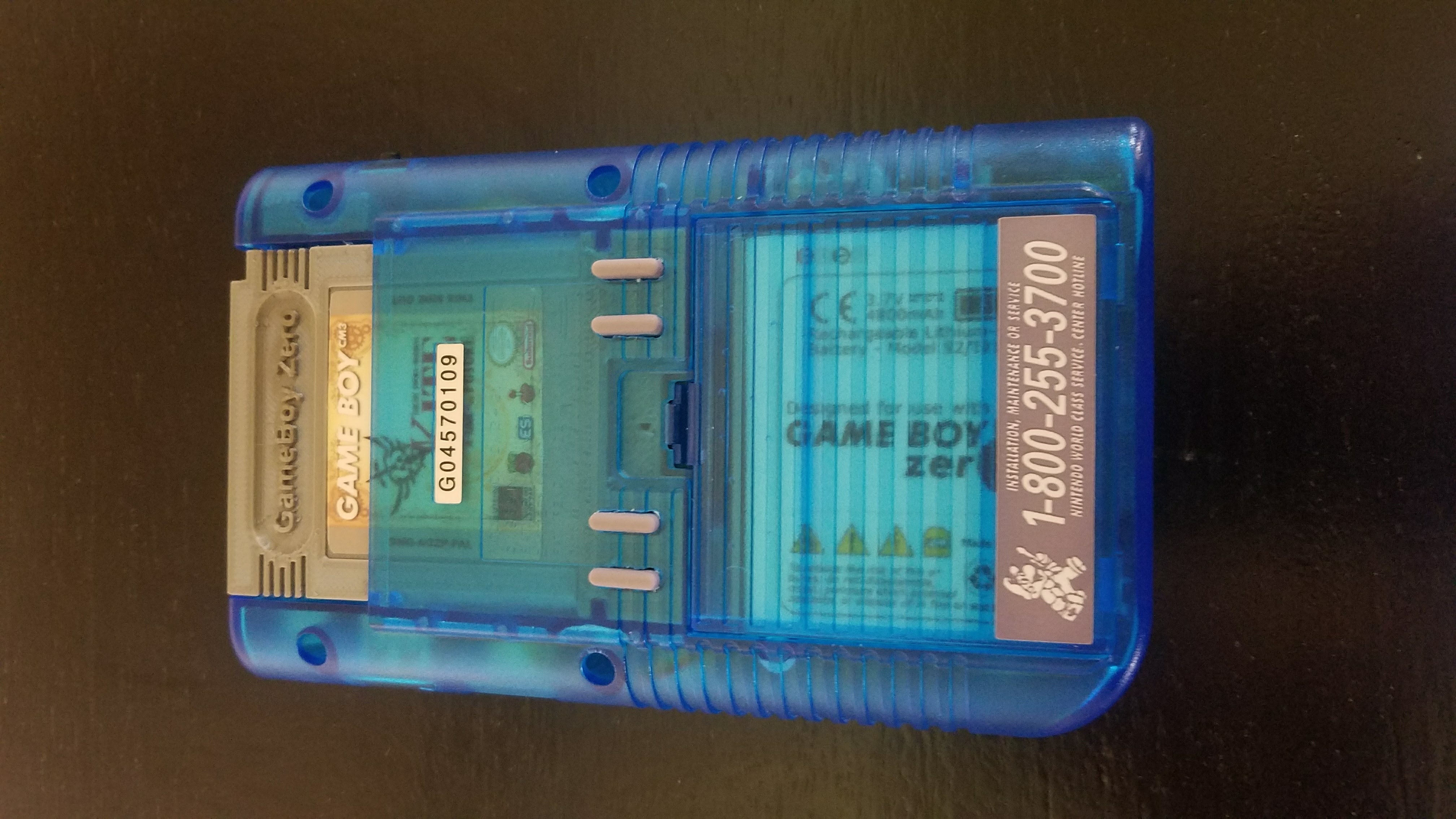

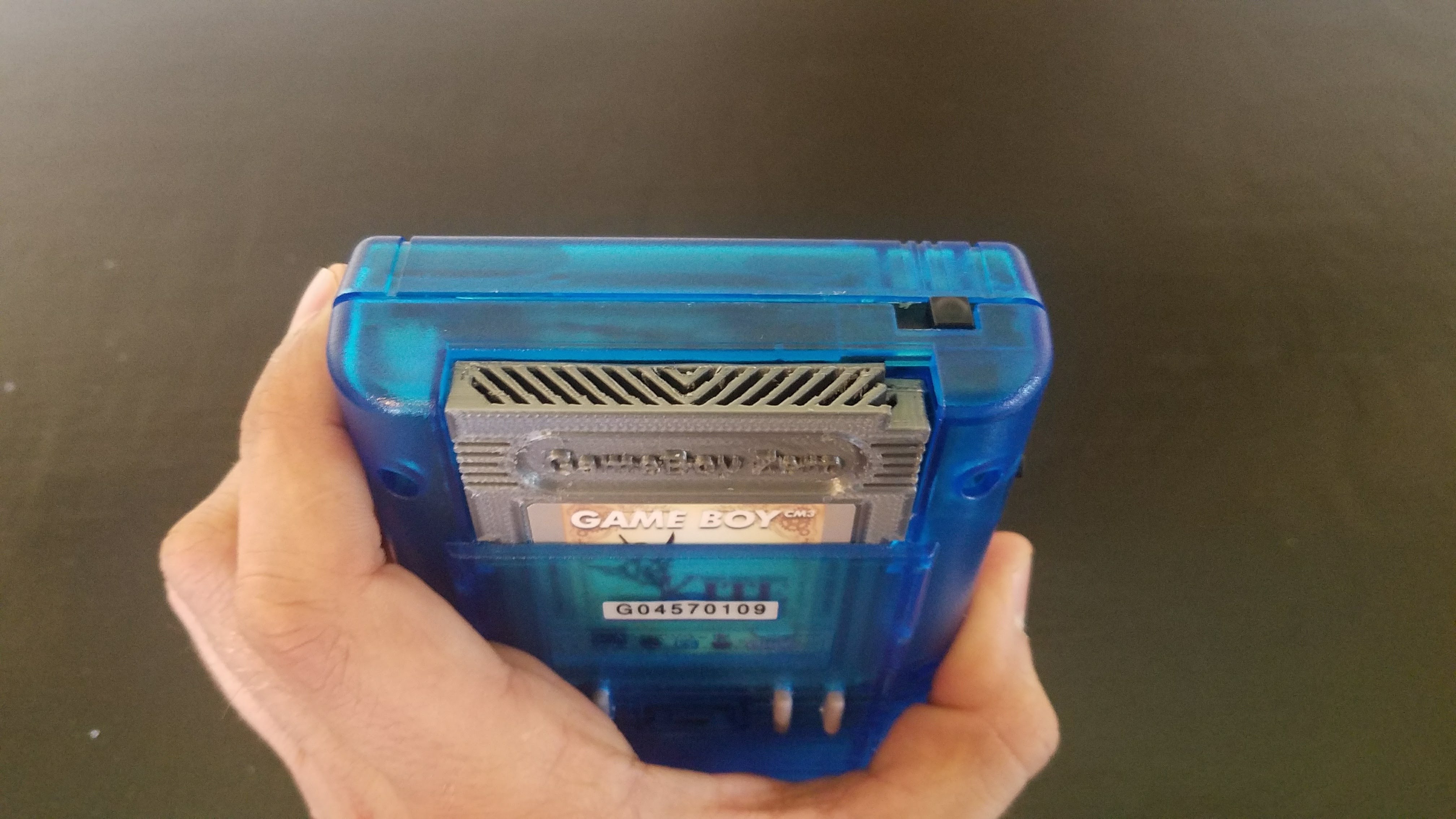

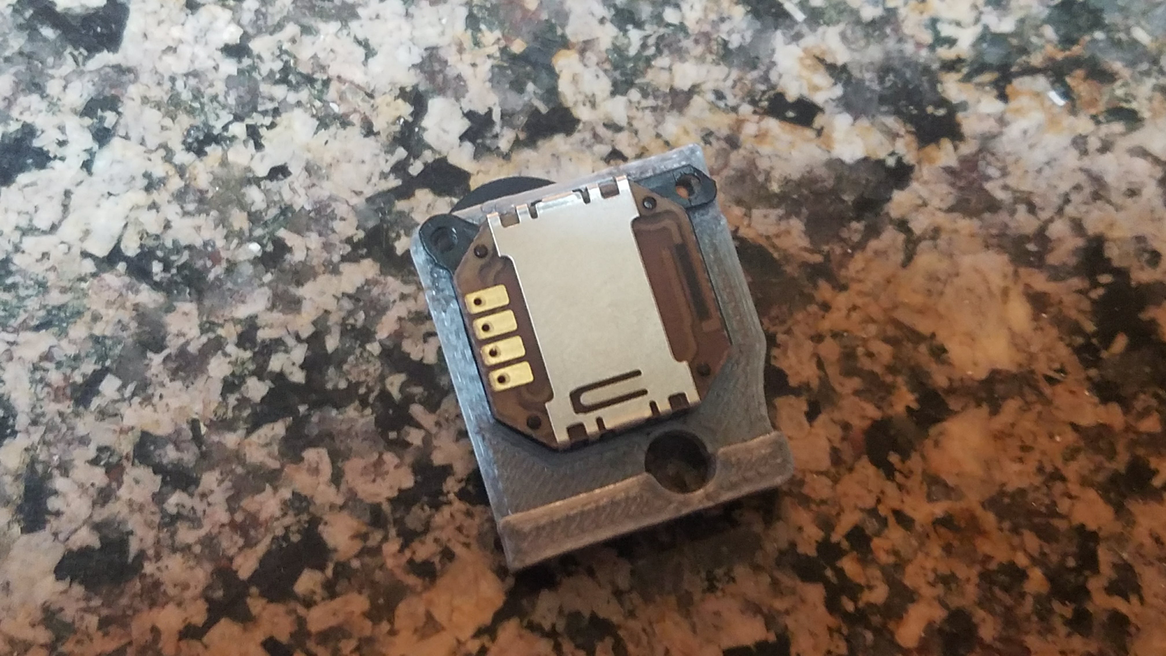

Finally, here is the fan bracket I used. It mounts the fan into the cartridge and forces the hot air out of the case. I hot glued a JST plug next to the fan so that the back of the case can still be completely removed. You must use a low profile heatsink. The one provided by kite works great.
I've added a blank and CM3 version.
Cart With Fan Vent.stl
(499.98 KiB) Downloaded 1944 times
CM3 Cart with Fan Vent.stl
(586.12 KiB) Downloaded 1781 times
Blank Cart With Fan Vent.stl
(176.84 KiB) Downloaded 1769 times

Also I forgot to include the joystick drill guide. If I remember correctly the PSP joysticks are 10mm... make sure to measure yours though - I don't remember off the top of my head.
PSP Joystick Guide.stl
(54.57 KiB) Downloaded 2047 times

I love these brackets. This may be obvious to others, but there were a couple things that had me stumped. Let me preface this with the fact that I haven't wired this up yet, but I DID check with a multi-meter. I had been planning on using only L1/R1. If you use all four, the bracket sits backwards in the case (Left is Right and Right is Left). Will this matter? I doubt it as you are telling Retropie what button you want to use for everything, heck... you could use Start for L1 if you wanted.... but my OCD is going CRAZY!
Second, I already had my HDMI board set up with the 2 risers soldered in. You will need to remove those if you use this bracket because AntFJ was awesome and made a bracket that does EVERYTHING!
Thanks again for this design and sharing your STL files. I will finally have all four back buttons :)

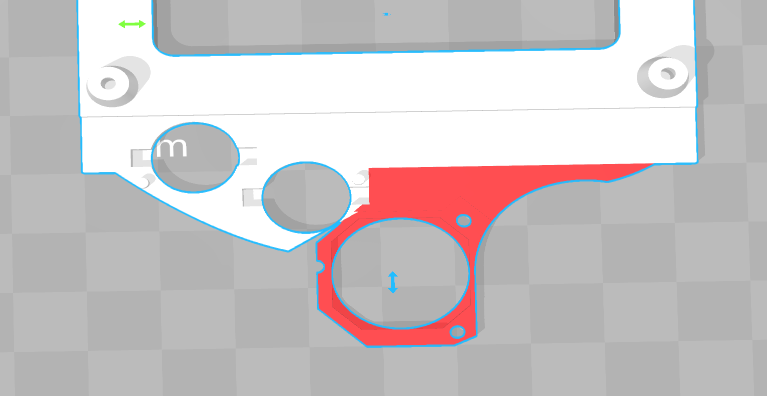

Someone PM'd me for the center screen/center bracket. As I mentioned before that screen bracket is based off Hoolyhoo's design so I won't give that .stl file away. I will give the part that I designed though. It can be added to any screen bracket if you know how to manipulate .stl files.
Here is an image showing how it lines up.
PSP Joystick Upper GBZ Bracket flush attempt 2.stl
(65.22 KiB) Downloaded 1841 times
