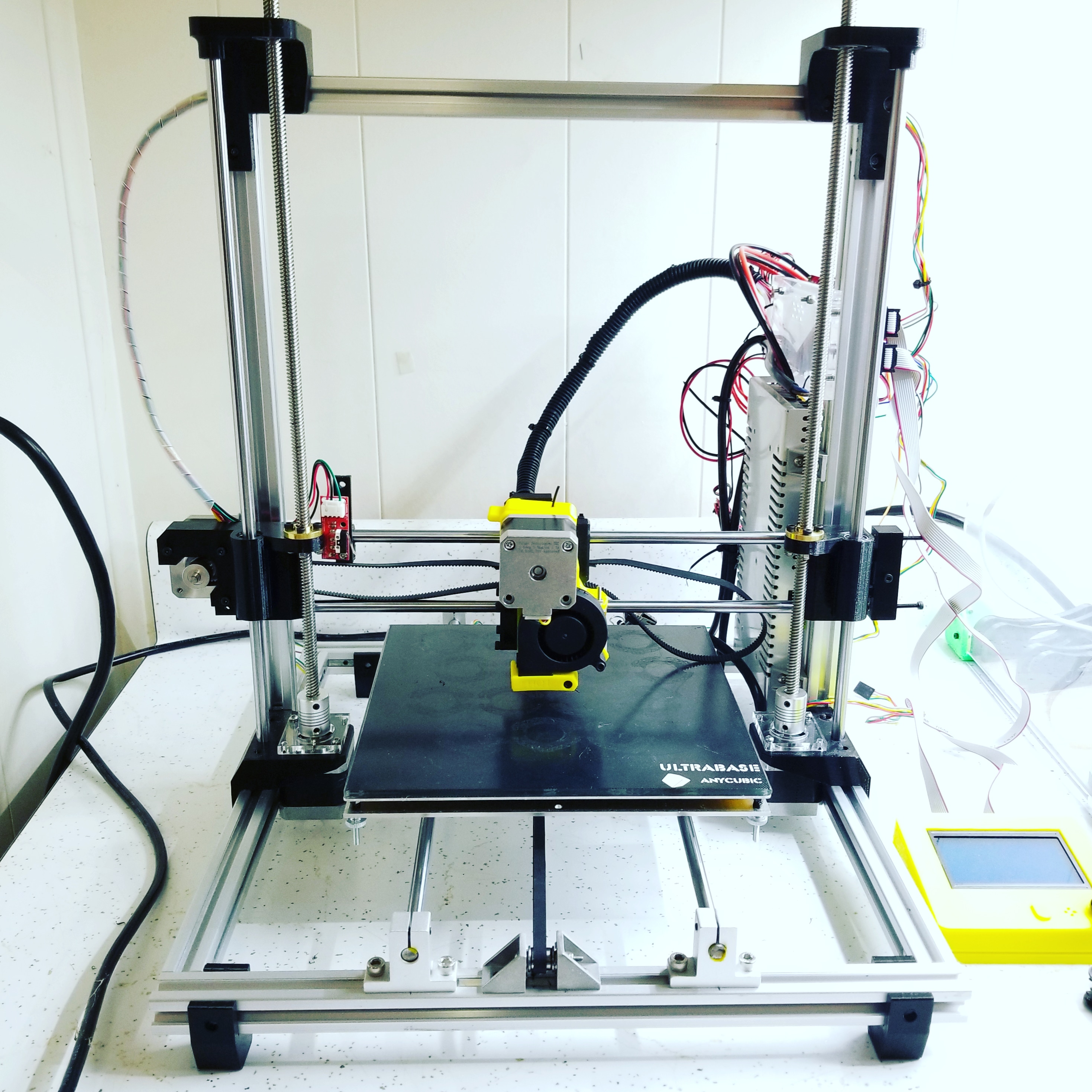

I went with a printer kit from Folgertech (folgertech.com) a couple of years ago for my first printer. I went with their 2020 i3 kit (https://folgertech.com/products/folger- ... rinter-kit). This kit probably isn't the most bang for your buck compared to more recent printers which have more features, but it always gave decent print quality in stock build form. I can't comment on the stock firmware, as I only ran that firmware for the initial test prints before updating to the latest marlin version at the time. They have a newer printer (FT-5) that offers as roughly a 12" cube print volume for about $500 dollars that seems to be a really good value.
My printer now is essentially a custom designed printer off of the original folgertech i3 2020 frame with elements from the Prusa i3 MK2 & MK3, and some custom components of my own design. Mesh bed leveling with a BL touch, Genuine e3D V6, increased z-height with motors moved to the bottom of the frame. It's current state is shown on the attached image.
My next printer is probably going to look similar to the CR10, but with genuine e3D and openbuilds components, and potentially use a prusa MK3 extruder assembly and drive gears. I'm currently designing it and will probably build it later this year.
