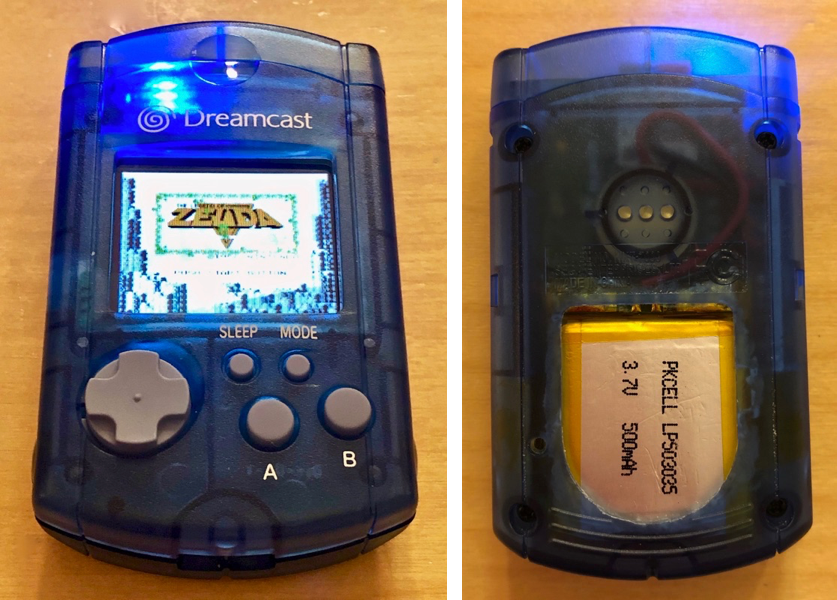

Dreamcast VMU Zero V2
This is an upgraded version of the Dreamcast VMU case mod for Raspberry Pi. Major improvements from the previous project are:
  • Supports Safe Shutdown
  • Supports Background Charging
  • Power Indicator
  • Easier Assembly
  • Reduced Cost
Details will be discussed in the following posts.

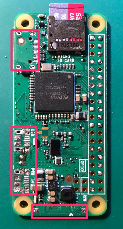

Remove Pi Connectors
Remove Camera, HDMI, OTG and USB connectors from the Pi. Remove bulk cap between the 2 USB ports. Use heat gun for cleaner results but soldering iron would also do the work. Cover the whole bottom side with the kapton tape for electrical isolation.

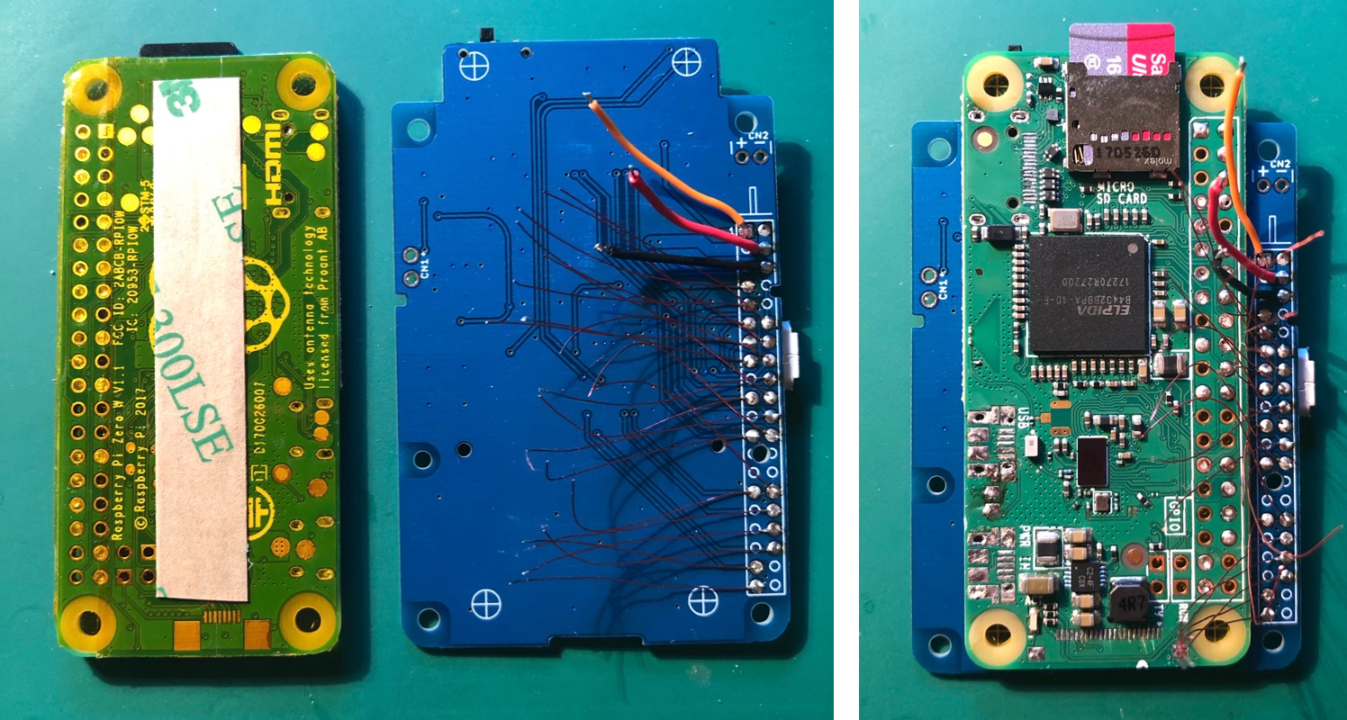

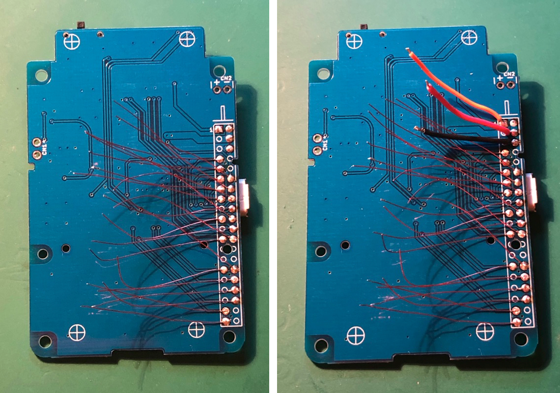

Wire PCB

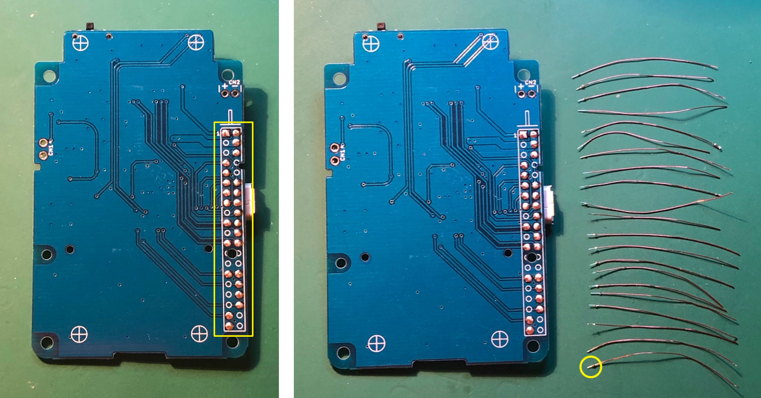

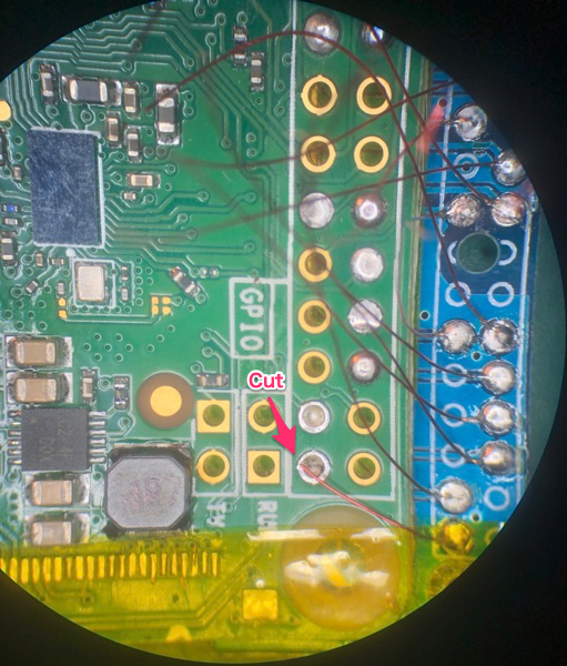

Pre-solder all of the GPIO pads on the backside of the PCB.
Prepare 2.5cm of 21x AWG34 enamel coated wires. Apply enough solder on the iron and dip the wire to strip the coating for 1mm.
Prepare another 2cm of 3x AWG28 wires for power supply.
Pre-solderingShow
Solder wires to the PCB.
WiringShow

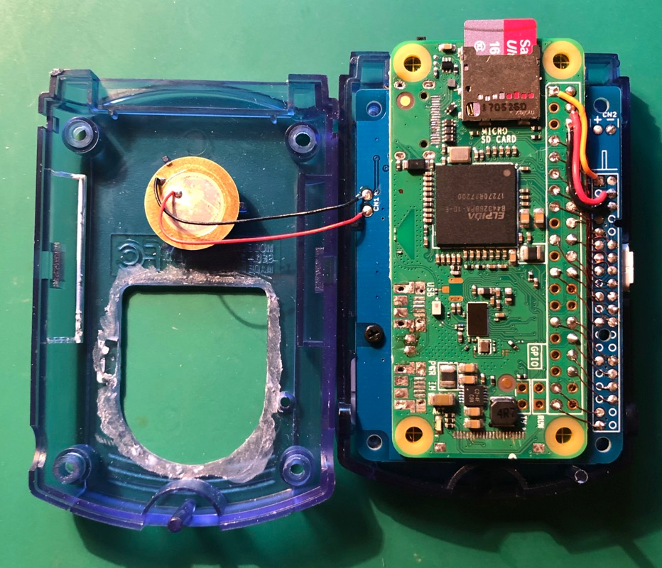

Tape PCB
Align the Pi on the PCB and tape it down.
TapingShow
Wire Pi
Cut the wire to adjust the length. Strip the enamel by dipping the tip then solder it to the corresponding GPIO pads of the Pi.
Solder power wires to the Pi. Use tester to check each connections.
BondingShow

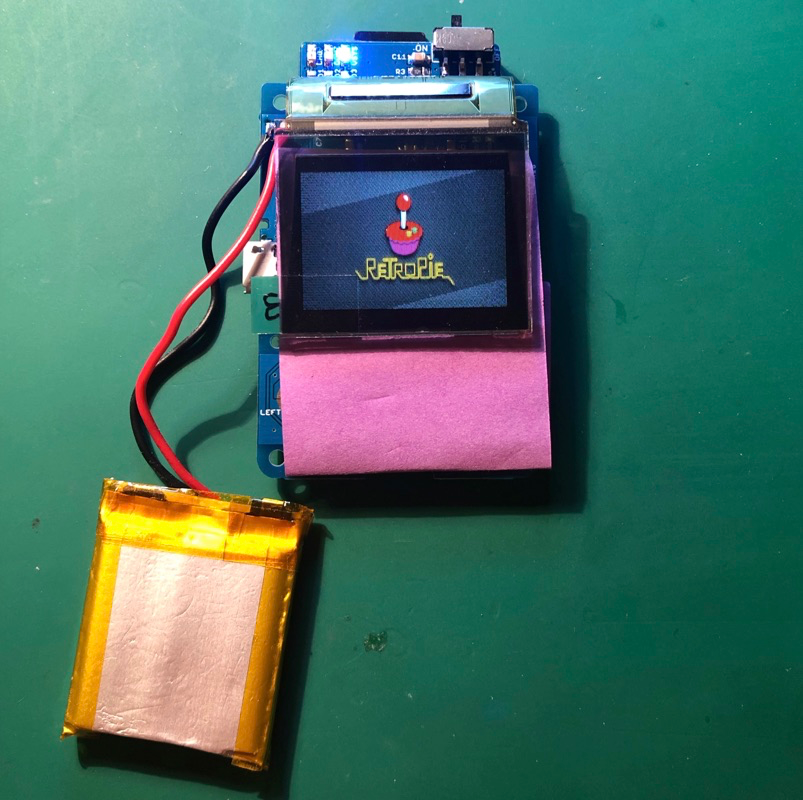

Pre-assembly Test
Solder the battery and attach the OLED display. Slide switch to the left to turn on the power. Check display showing the retropie splash screen.
Remove the battery and OLED after the test.

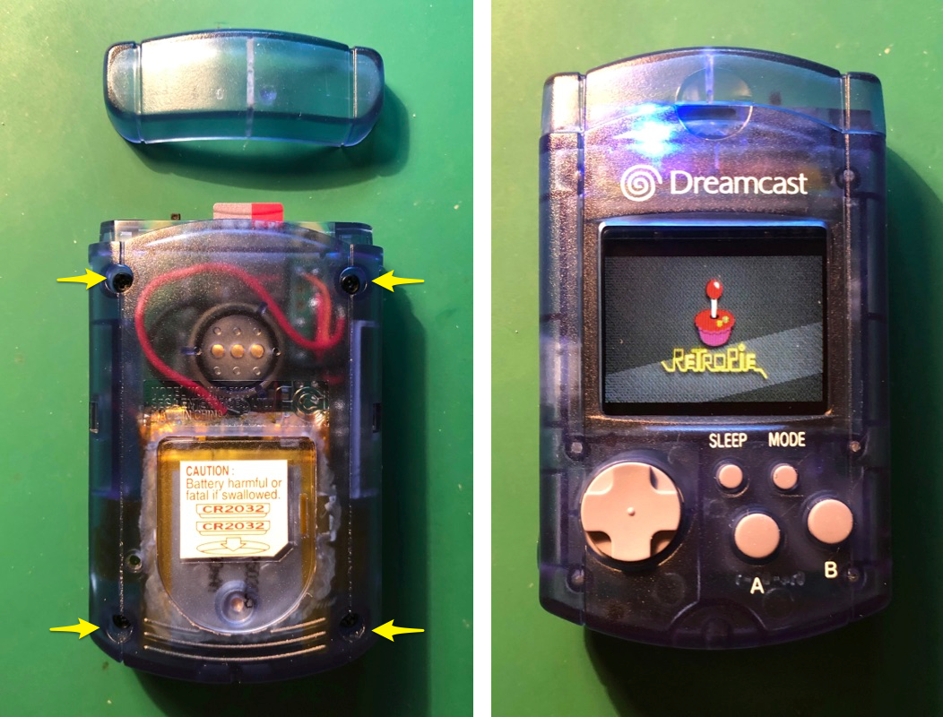

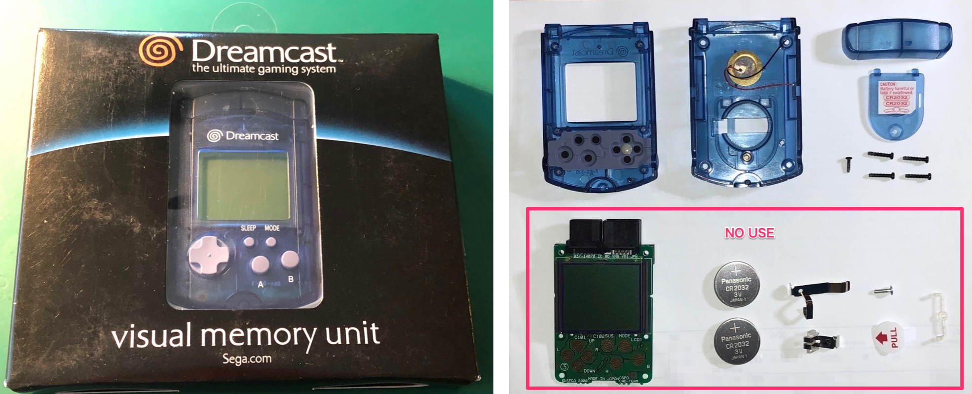

Disassemble VMU
Strip down the VMU and keep everything but the PCB, coin cell and display. De-solder speaker wires from the VMU PCB.
Try not to touch the piezo speaker to prevent fingerprints on the disc.
VMU Tear DownShow

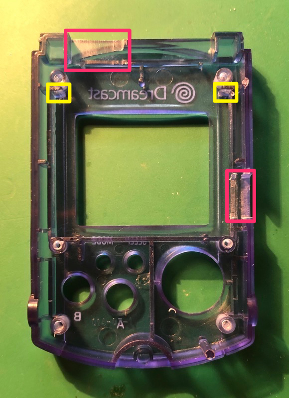

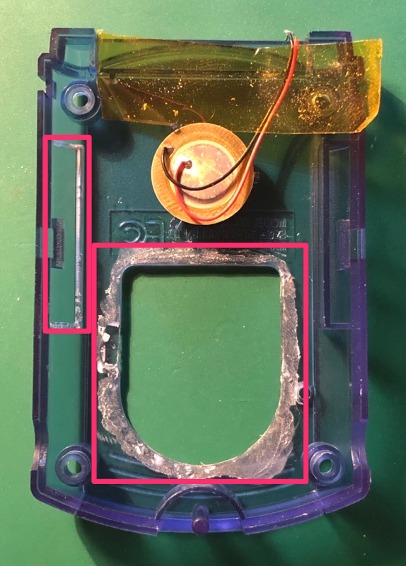

TopShow
Cut the inner plastic beam and post.
FrontShow
Use flat file to make enough room for the USB connector and the Switch.
Shave just a bit of each corners of the display housing if it is too tight to fit the OLED panel.
### Side Image to be added here ###

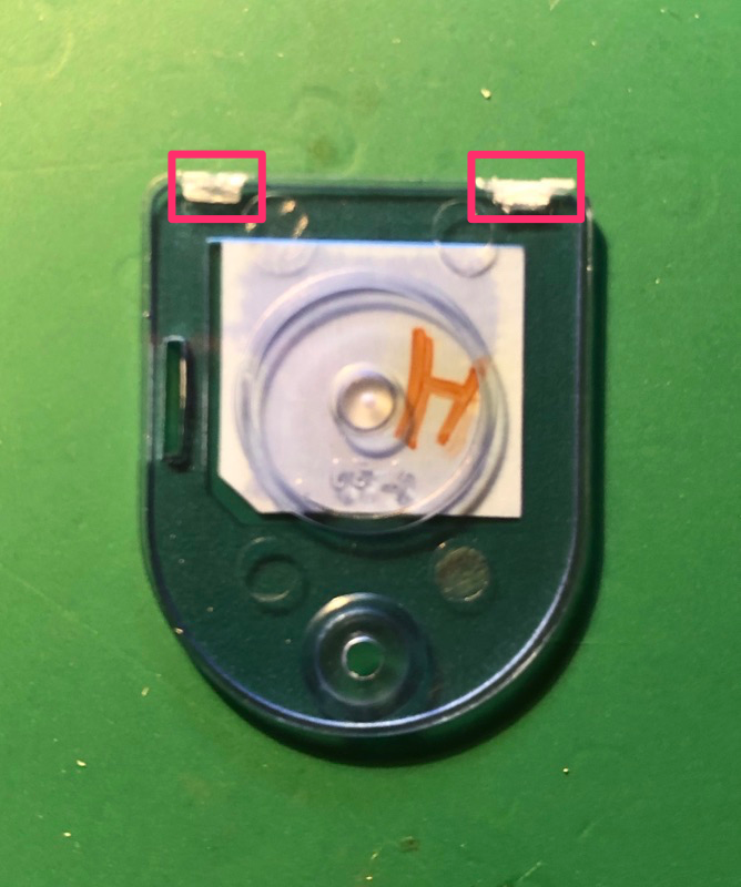

RearShow
Chop off the coin cell holder and grind down the edges.

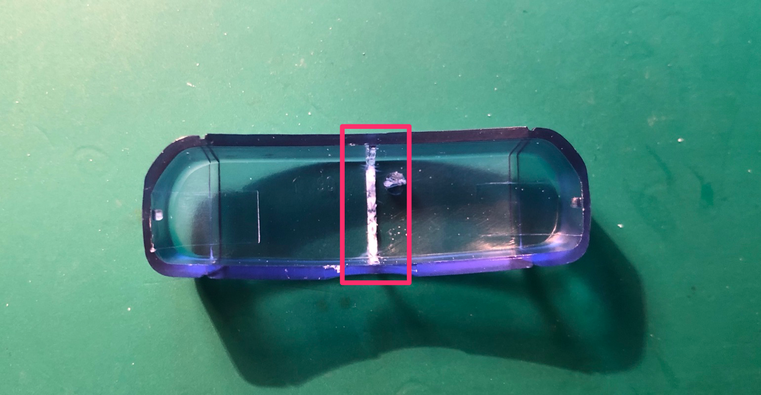

Battery CoverShow
Cut 2 tabs.

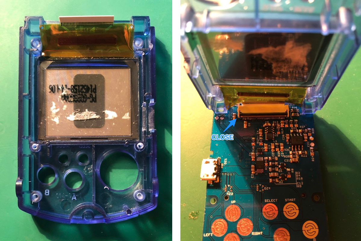

Display
Snap the display in to the housing. Glue it down if it is too loose.
Flip the case and attach the display FPC to the connector. Close the tab to lock.
Display InstallationShow

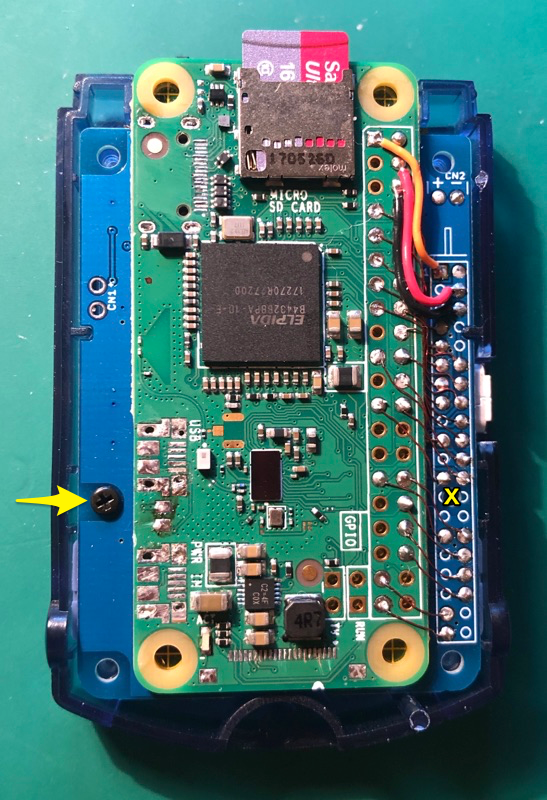

PCB
Screw down the PCB. Leave the right hole unconnected.
PCB InstallationShow
Speaker
Solder speaker wires to the PCB.
Speaker InstallationShow

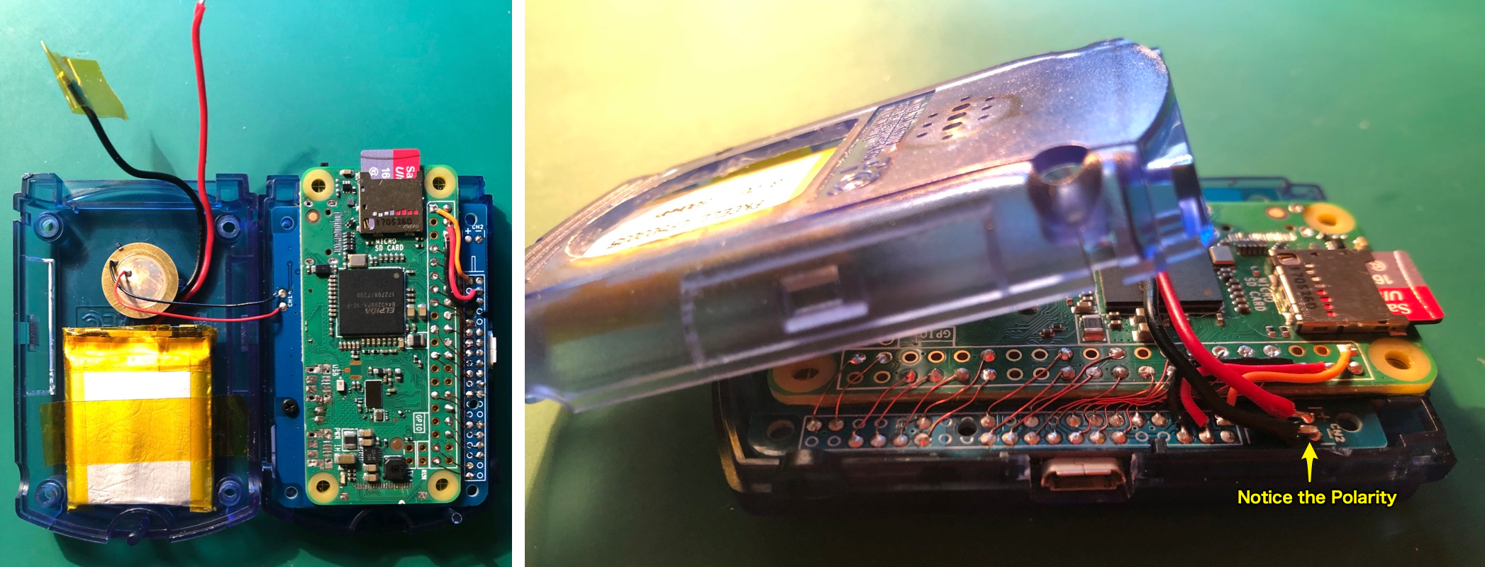

Battery
Tape the battery to the case and lay the wires to go around the speaker. Slightly close the case and solder the battery wires to the PCB. Pay attentions to the battery polarity. Negative is closer to the edge.
Battery InstallationShow
Rear Case
Screw all 4 corners of the case and close the top. Tape the battery cover.
Rear Case InstallationShow
This concludes the V2 build instructions. Enjoy your revived VMU!
