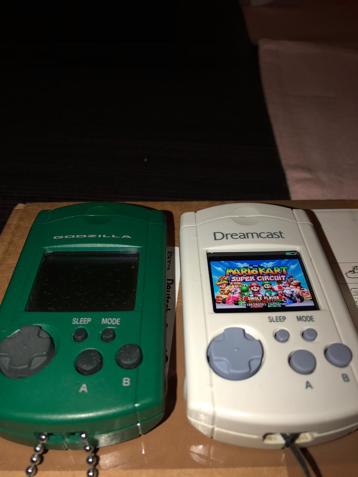

As its kinda hard to get good special edition VMUs, I settled on the Godzilla one for now. I would love to get the carbon or the 8bit design eventually though. The Godzilla one has nice dark gray buttons and when I get my hands on another I would like to put those into the original VMU as well instead of the purple ones. I do have one more spare gem if I ever get one of those.

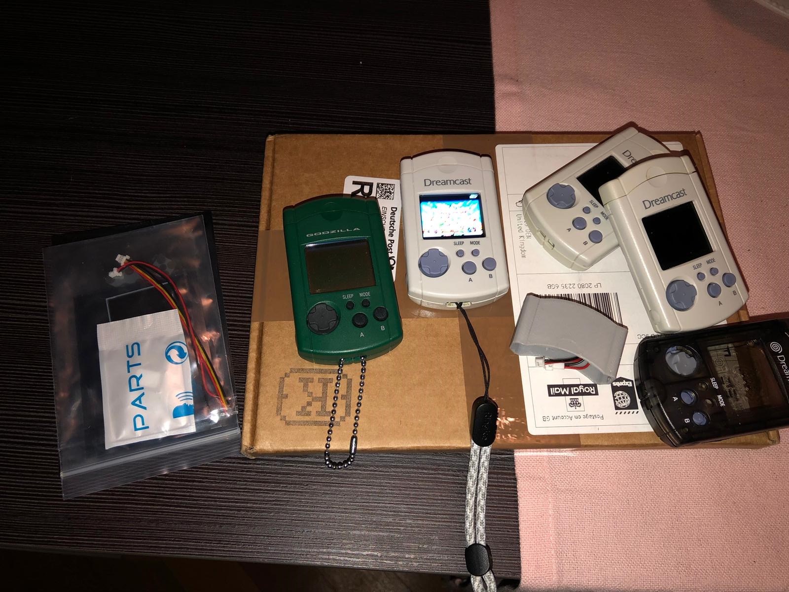

Parts:
- Circuit Gem, stocked up on those :)
- Ordered a few 482953 850mAh a while ago, should arrive soon
- Pi Zero with all ports removed, used up the last one for the other VMU
- 2 buttons for L/R that will go into the lid, ready
- Small magnet to keep lid closed, ready
All side by sideShow
Godzilla!Show
Any ideas what else I could do to change it up a bit?

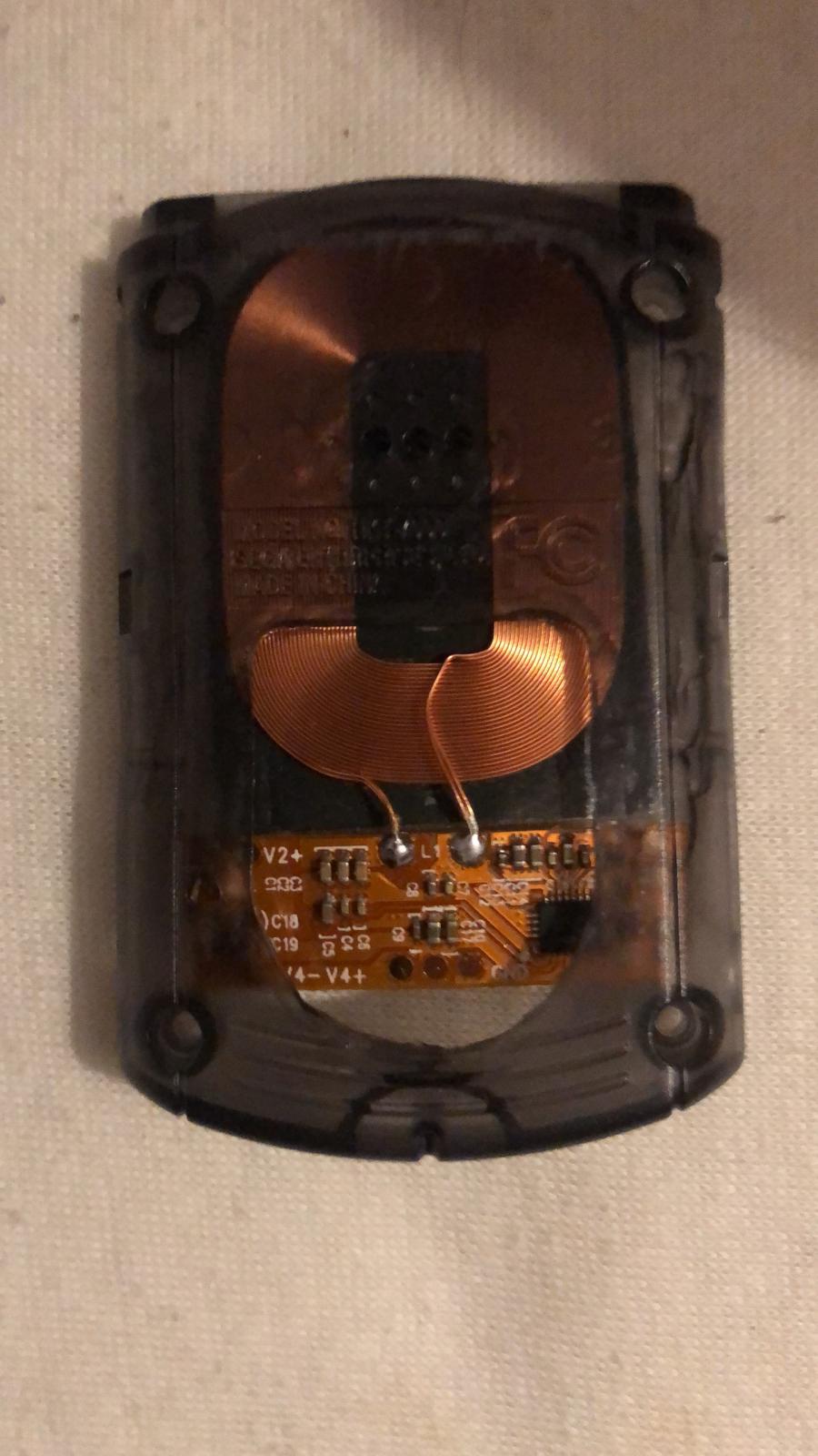

Thanks Kite - yes please let me know which switch would fit :) Would then love to control the switch from the menu. I did solder a few surface parts by now, so that should work :)

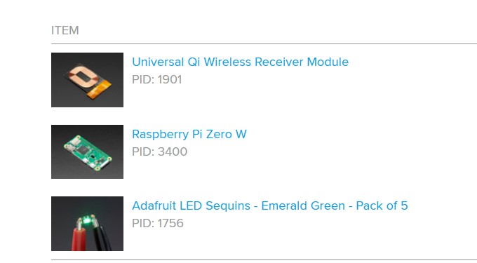

I love the QI idea, got me a module from adafruit which seems trivial to integrate. I have more batteries here to fit in if I cant get that in with the 850mAH one. Also got some simple green LEDs.
Only other thing I could think of would be an easier way to toggle the menu and/or toggle the X/Y switch. I will look into replacing it with a proximity switch. That would need some code changes though (or do you know of any that act like a toggle switch directly?) for the switch logic and to use a second one and use one of the i2c pins to toggle one option (X/Y for example).
EDIT:
Dimensions of the charger, seems like a perfect fit:
Back Panel: 48mm x 32mm x 0.5mm / 1.9" x 1.3" x 0.02"
Chip: 11.5mm x 36mm x 0.3mm / 0.5" x 1.4" x 0.01"
Copper Coil: 41mm x 29mm / 1.6" x 1.1"
Annotation 2019-03-06 114142.jpg (27.05 KiB) Viewed 18394 times

Parts arrived!
The Qi module is pretty much the perfect size, just needs a little extra plastic removed at the top of the VMU and it sits completely flat.
LEDs are nice too, small enough to put anywhere and big enough to solder still.

And still looking where to buy the surface mount parts, I made an order that was cancelled because the supplier doesnt ship to private persons :(
Parts!Show
