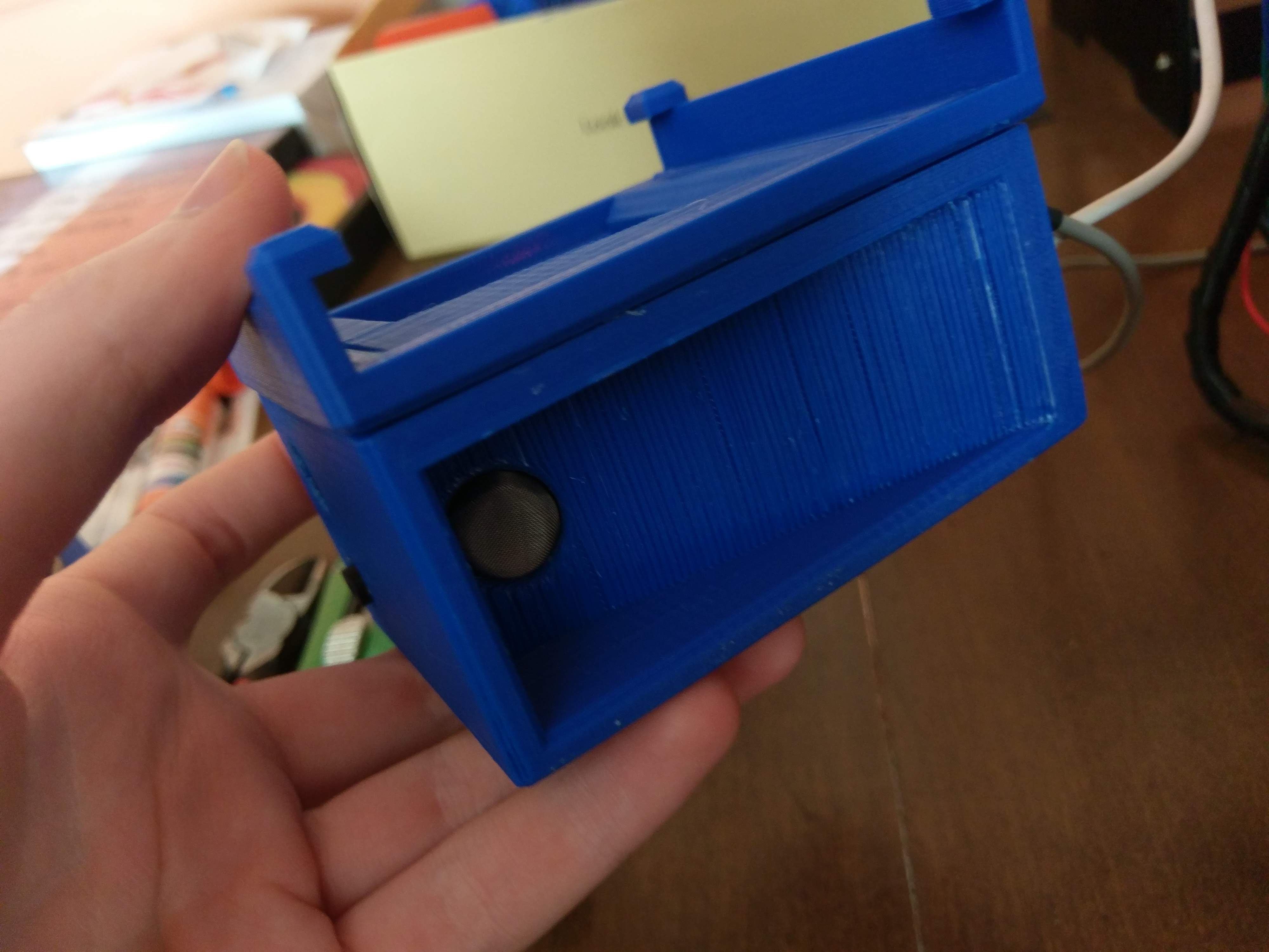

It's finally done! The last parts arrived just over a week before the deadline :shock:

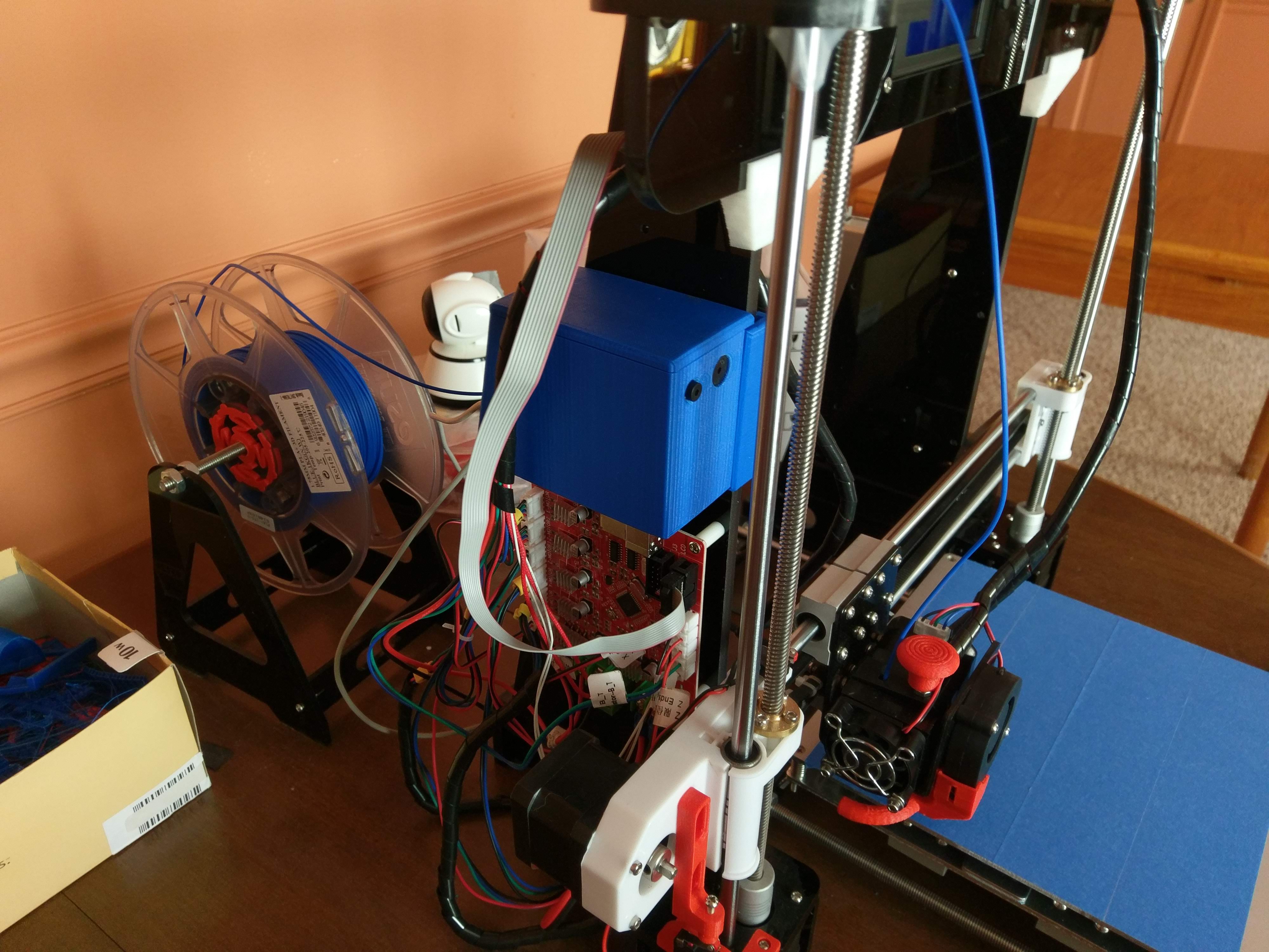

The result is an internet-enabled smoke detector module mounted on the side of my 3D printer. Now, in the event that the mainboard catches fire (not as unlikely on an Anet A8 as it should be), this snazzy box will start beeping incessantly, and I'll get a text message on my phone.

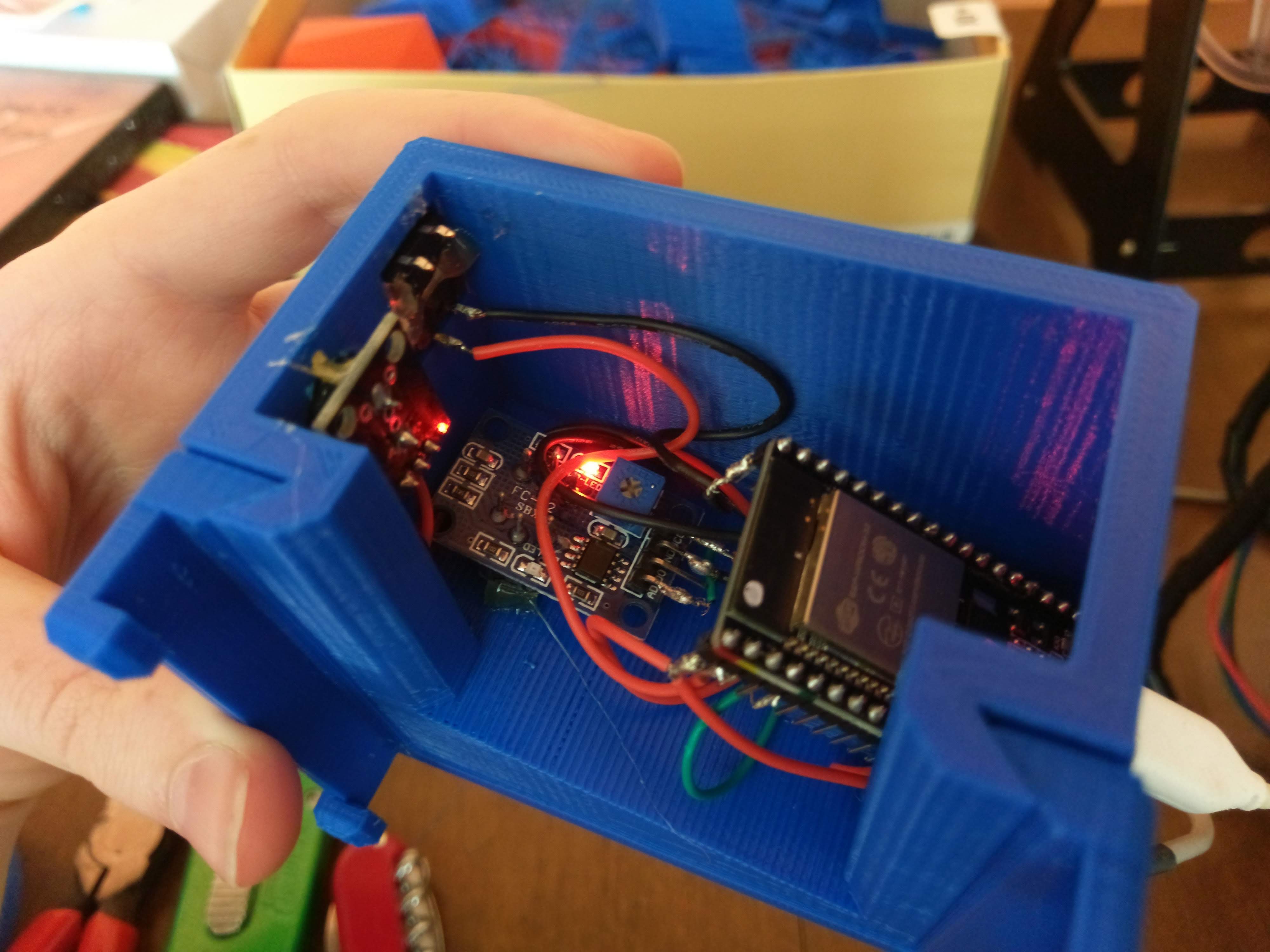

I had planned to wire up a relay so that I could cut the power to the printer too, and I got as far as wiring it to the system on the breadboard with no problems. But, when everything was soldered up, connecting the relay seemed to prevent the ESP32 from starting up at all. The red power light stayed on, but the program never started, and I couldn't connect it to a computer either. Removing the relay made it work perfectly again so I decided to just leave it off. (that's what the stray wire leading from the bottom left of the back of case is for, if anyone was wondering)
This was my first time doing anything with an arduino-type controller, so even though it doesn't do everything I'd wanted it to, I'm not too upset about it. I think I learned a lot (particularly about how bad I am at soldering :lol:), and I had a lot of fun doing it.

Side View
Underside with Smoke Sensor
InsideShow

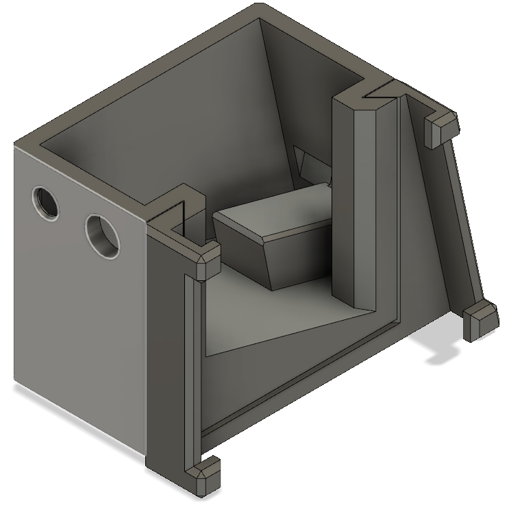

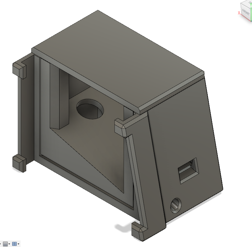

3D Model of CaseShow
