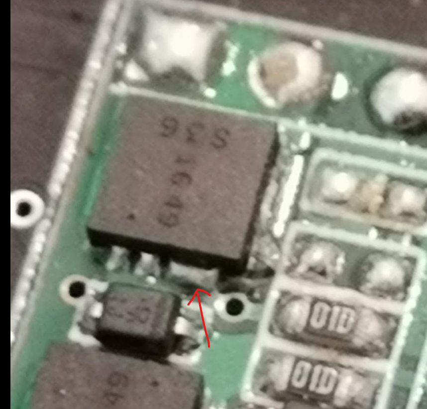

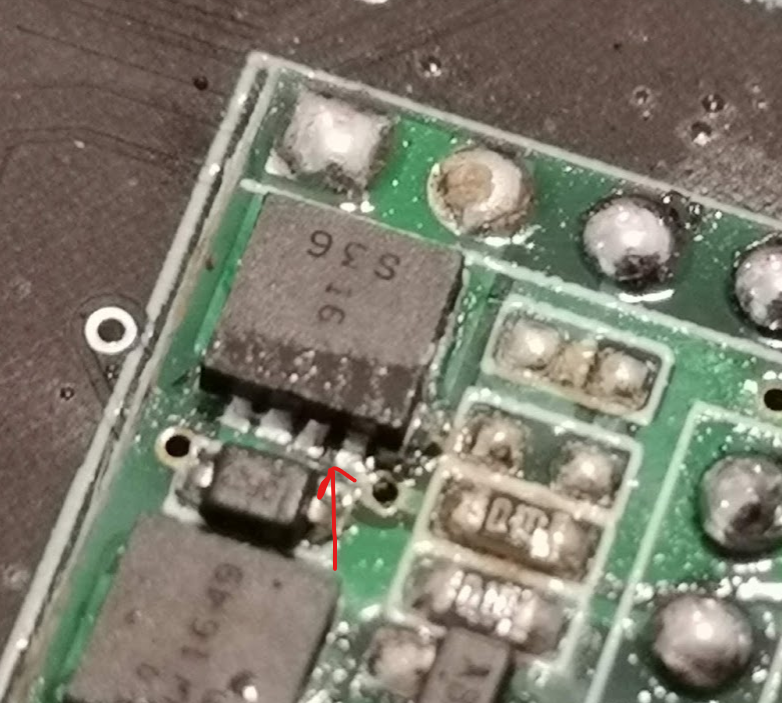

Robochris wrote:
Wed Aug 21, 2019 3:42 pm
I had a problem similar... check/reflow your soldering on the small green board on the front of the pcb (with the switch on it). this is what solved my power problem.
Turns out this was the issue, one of the chips had a bridged pin. I compared it with the board for sale on galaxygaming.co.uk and noticed they were different!
It's such a small area to work with, but using some solder wick I just went over it a view times with my iron until I could see (barely!!) the bridge pins were gone. Attached the battery and boom! It all booted up as it should of done.
Thanks everyone for your support and tips!
I have to say though, whilst these things can happen i'm not impressed by the level of QA that has taken place here. Testing the board is one thing, but you need to test everything together before you ship these things - I know, its not so easy when its a hobby project. But still...
That or share the circuit diagrams or similar. Anyway all good now.
Some pictures to illustrate the problem:
My board:
On gg:
Fixed:

Thank you so much! Me and a good friend have spent hours today with a multimeter trying to figure out why the PocketPi FE wouldn't boot from anything but power directly to the pi zero. I'm positive you've hit it on the head. Seems this might be a common production error.
Won't know for sure until we split these solder blobs apart but I think you've just saved my build :D Thank you!

Post by strdr » Sat Nov 09, 2019 12:57 am
Certainly looks like the same issue, good luck fixing it!!
