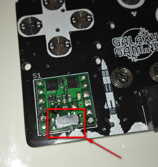

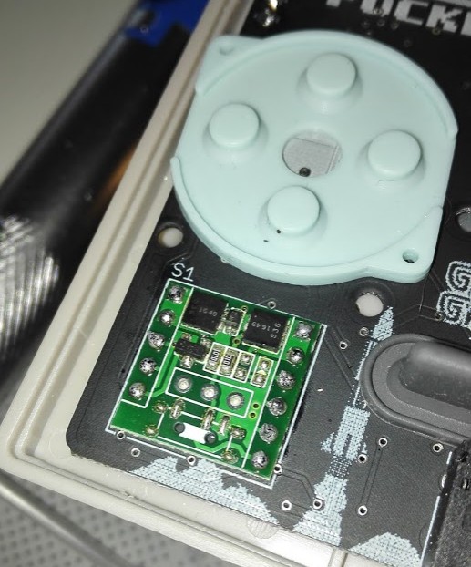

But anyways, this second kit is one of those that Galaxy Gaming soldered himself, mine was one of the ones that where factory soldered.
The chip I assume is the audio chip, looks different on both. The one that GG soldered himself has some sort of switch on it that mine doesn´t have.
I don´t know if this maybe is the reason for my missing audio. I don´t think so, I think it maybe should look that way, but maybe someone could bring some light into it. And could tell me if I´m right and if that´s the amp or soundcard or so.
I really don´t know what to do and how to get audio.
soldered from factory and additionally soldered by me:
soldered by GG:

That soldered on pcb is for the safe shutdown not audio. Audio comes from the very tiny ic near the lower right of the board.

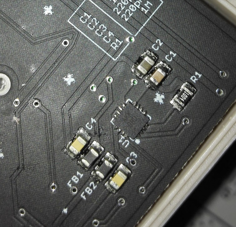

I think you are talking about this one?

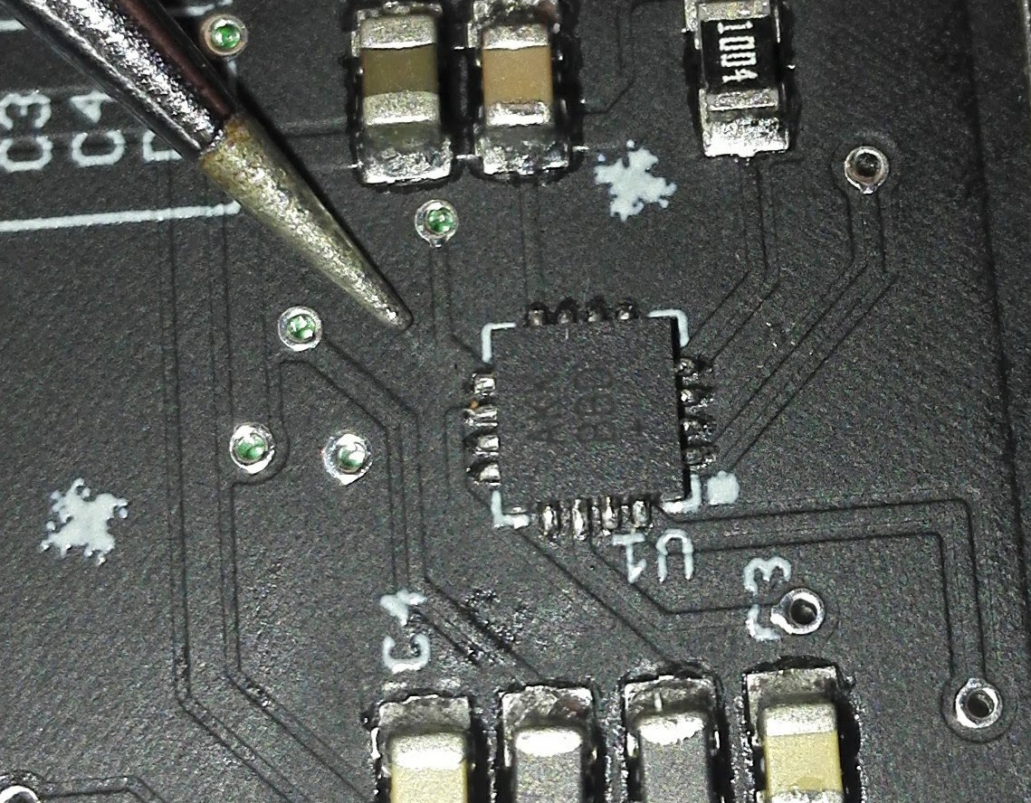

Yes, that’s it. It’s a delicate qfn package so perhaps it needs to be reflowed although it does look fine in your photo.

That's really tiny... I have not much experience with things that tiny.
I would do a little flux to the pins, put a little bit of solder to the solder tip (the really tiny one) and go from one side to another in a movement. Or should I better try to do on Pin after another?

ekilla wrote:
Sat May 11, 2019 10:34 am
HoolyHoo wrote:
Fri May 10, 2019 11:01 am
Your best bet is flux and hot air. I personally wouldn’t try it with an iron even with a fine tip although I suppose it’s possible if your good at it.

I think you´re right, I shouldn´t try that. I have nothing for hot air yet and even my very very tiny tip is looking huge compared to the solder points...
And of course, I´m not good at it. I have never soldered something this tiny.
