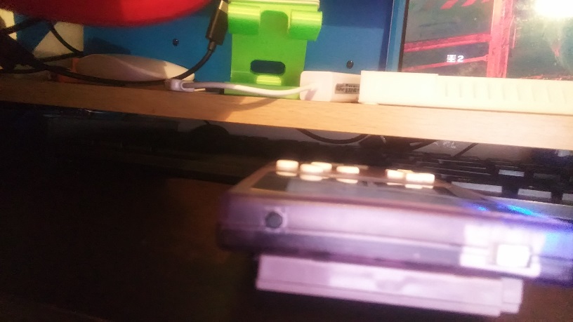

If you only wanted to remove the overlay reset your PocketPi and you are done.
To relocate the overlay I used a tactile switch and wired it up to GPIO pin 23 and ground.
