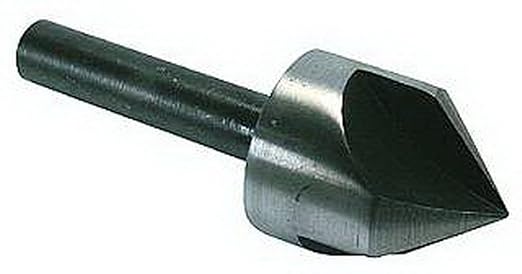

Wow Fleder I am so jealous of that dremel kit you have, looks sweet! Also how did you manage to get the inner dip on the X Y buttons? That looks really well made!

ktechelonbreak wrote:Wow Fleder I am so jealous of that dremel kit you have, looks sweet! Also how did you manage to get the inner dip on the X Y buttons? That looks really well made!
Haha, yeah, it was quite expensive but I wanted to have it for a long time now.
I think it's called a "countersink bit" in english. It looks like this:
