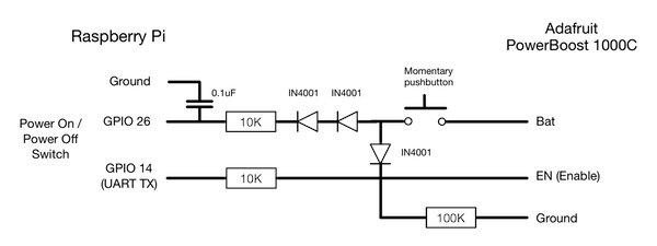

So that is only the on/off push button circuit from here?: https://github.com/craic/pi_power
What is the big black component? I don't see anything in that schematic that would look like that
It's not serving any purpose for the analog/digital converter that is listed as the 2nd hardware subsystem in the article? Do you even need that converter or are the LED's just wired directly to the charging board and powerboost?

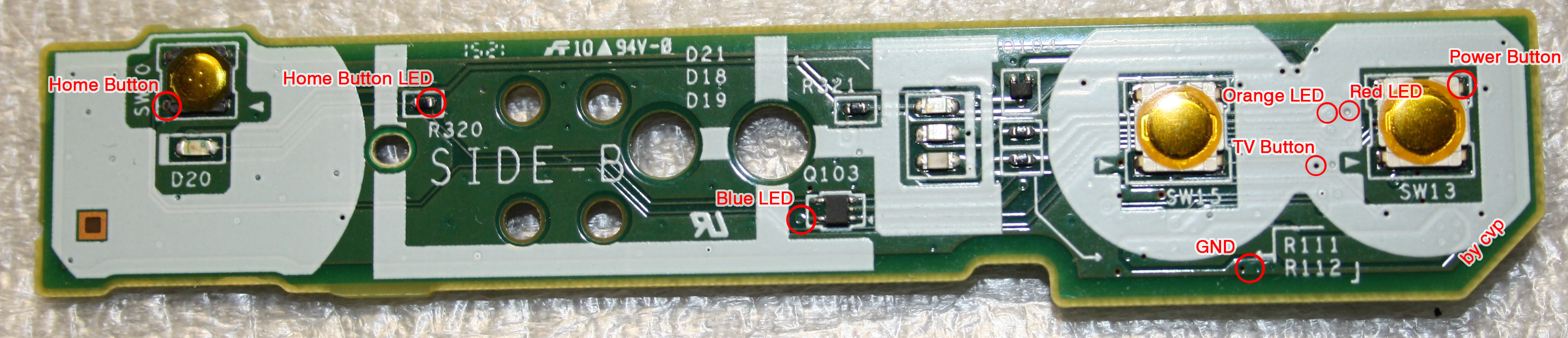

I'm still pretty confused about how all of the bottom buttons are working and how the battery status functions work. Can you confirm that the below pic from a previous post has the soldering points correctly identified on the bottom circuit? Or if not how you determined the solder points? What color LED's do you use for low battery, charging, charged, power on, etc.?

Nevermind I think I found the answers to my questions in the last post. All of the LEDs are working according to that pic I posted.

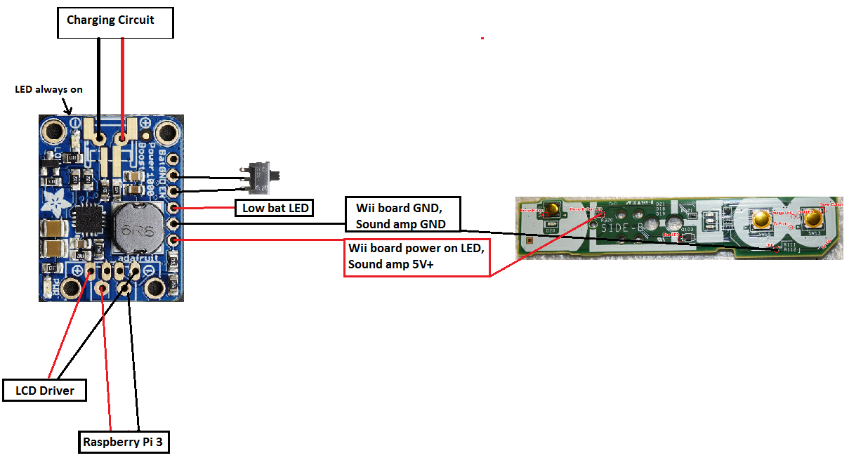

Ok I have two more questions. Everything is working except my LEDs. I have two issues I'm still having:
1. I decided to use a slide switch for the power on/off instead of the method you linked to. Not sure if that is related to my problem but currently the powerboost low battery LED is always on (both the LED I have wired to it and the onboard LED). Below is a pic of how I have it wired. Does anything stand out to you as an issue?

2. I'm not able to pinpoint where to solder the LEDs onto this charging circuit to turn on the charging (orange) and full charge (blue) LEDs on the wii. Would anyone know?
