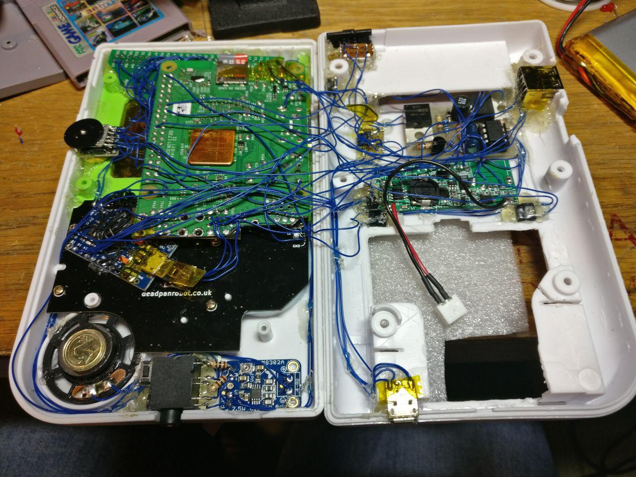

Finished!
These are the last internals:
I know, it looks like a mess but there are a LOT of connections (I also doubled the power wires, just to be safe)...
Believe me it could be worse :shock: :shock:
From left to right you can see:
- volume pot
- RTC module (under the pot)
- DPI screen (rewired and cleaned up, under the hood)
- Arduino micro which includes:
---- keys
---- battery meter
---- in charge/full control lines
---- brightness control
---- USB connection to the Pi
- Speaker
- Reset button
- Audio jack
- Audio AMP
- The Pi of course
On the right side:
- Switch with keep alive/shutdown pin
- MOD button on the left of the case
- Personal DIY graceful shutdown circuit
- Mosfet current measure switch
- L/R buttons
- Powerboost
- DIY Boost converter/Current limiter for backlight (dimmable using MOD + arrows)
- External LEDs
- External USB
- Charge USB
More pictures later :D
tinkerBOY
Posts: 710
Has thanked: 294 times
Been thanked: 206 times
Re: Gameboy Mk3 - RPi3 + DPI screen + RTC diy [WIP]
Post by tinkerBOY » Wed Dec 27, 2017 5:16 am
I like the creativity behind the brightness control. Is the shutdown circuit dependent on the powerboost?
razer.93
Posts: 56
Joined: Sun Apr 02, 2017 3:21 pm
Been thanked: 39 times
Post by razer.93 » Wed Dec 27, 2017 5:22 am
The shutdown circuit is that little spot near the powerboost and it's a separate thing, it actually controls the power flow from the powerboost to all the circuits. It's dependant on the powerboost in the sense that it's designed for it but the mechanism is quite standard

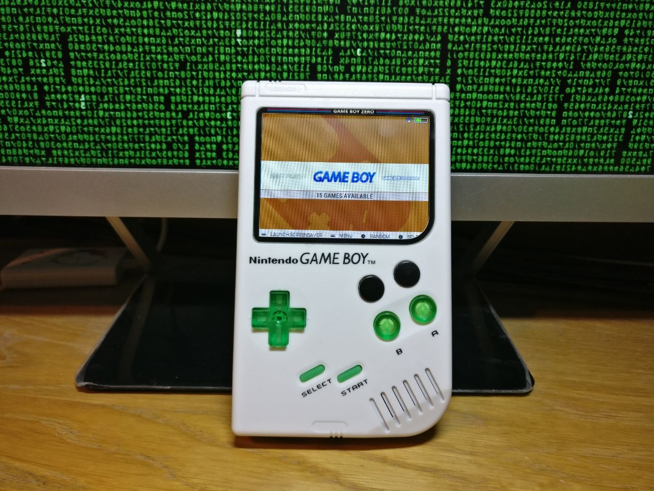

Here it is:
other picsShow
Completed with adapded/modified OSD, key shortcuts and automatic/hot-plug HDMI clone script (automatically detects when cabe is inserted).
Thank you all for the support!
