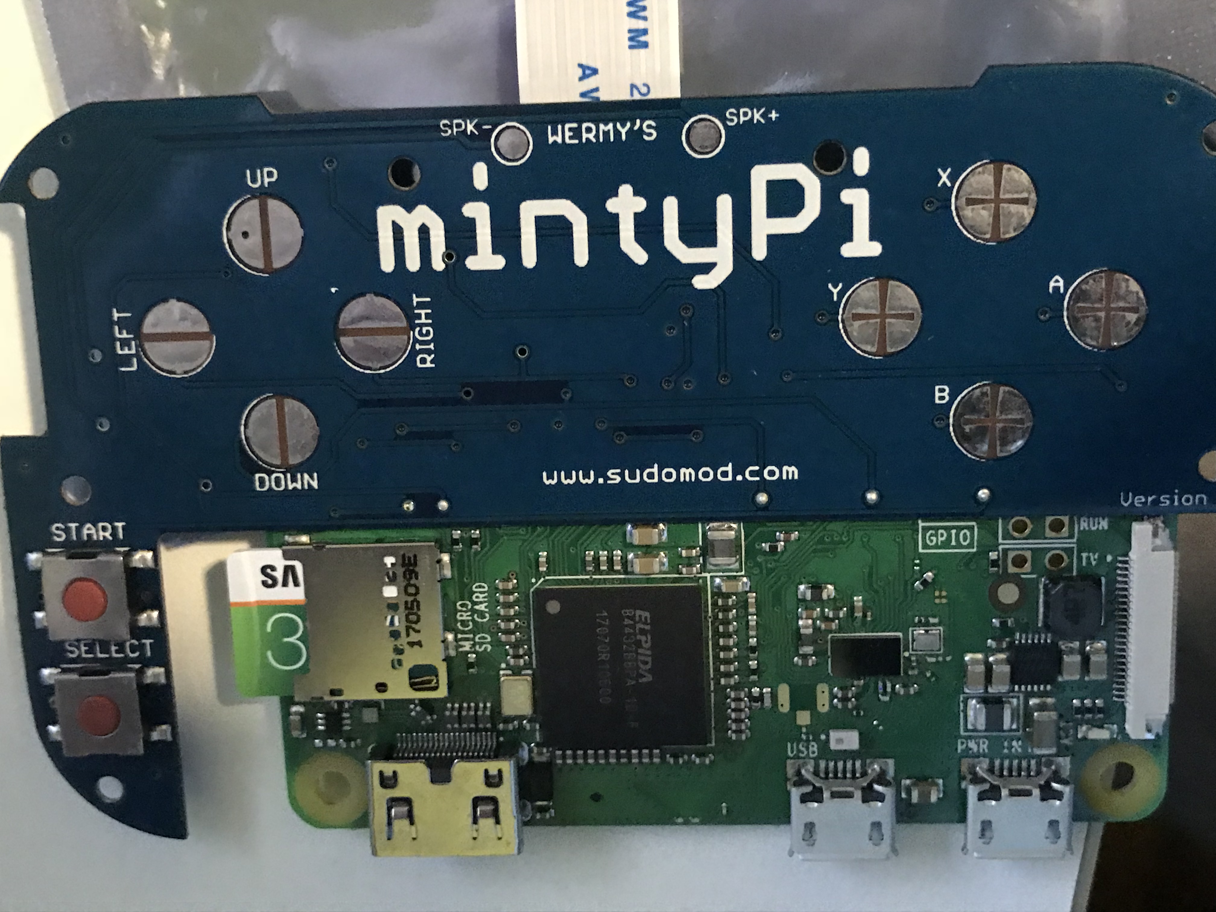

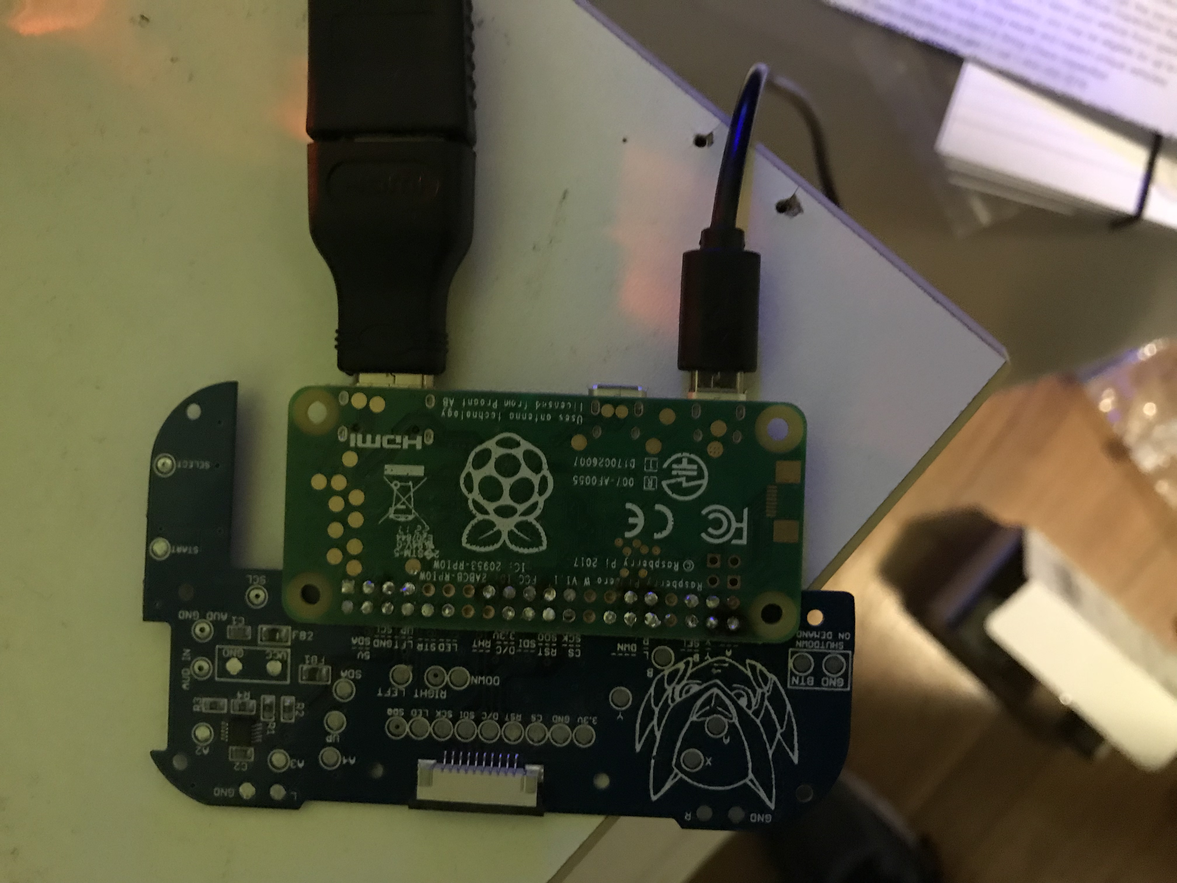

After soldering everything I tested all the connections and they were good, and inserted the sd card with the softwear, but nothings happening. the green light dosent turn on when i plug it in either. This is my first time doing anything like this and I dont know whats wrong.
I attached pictrues of the motherboard.
- Picture of my motherboard#1
- IMG_0100.JPG (2.54 MiB) Viewed 6975 times
- Picture of my motherboard#2
- IMG_0099.JPG (3.02 MiB) Viewed 6975 times

Plug the SD on the with a basic retropie and power it via its own micro usb while outputting video via its own hdmi just to see it the pi is not fried.
When i see your soldering, i’m afraid
Your iron was really too hot

I tried bypassing it with a hdmi but still nothing happened. The green light still wont turn on. Its dead. Is there a safe way to remove it from the board? Also the power supply is good. I used the same one I used to test the pies before i soldered.

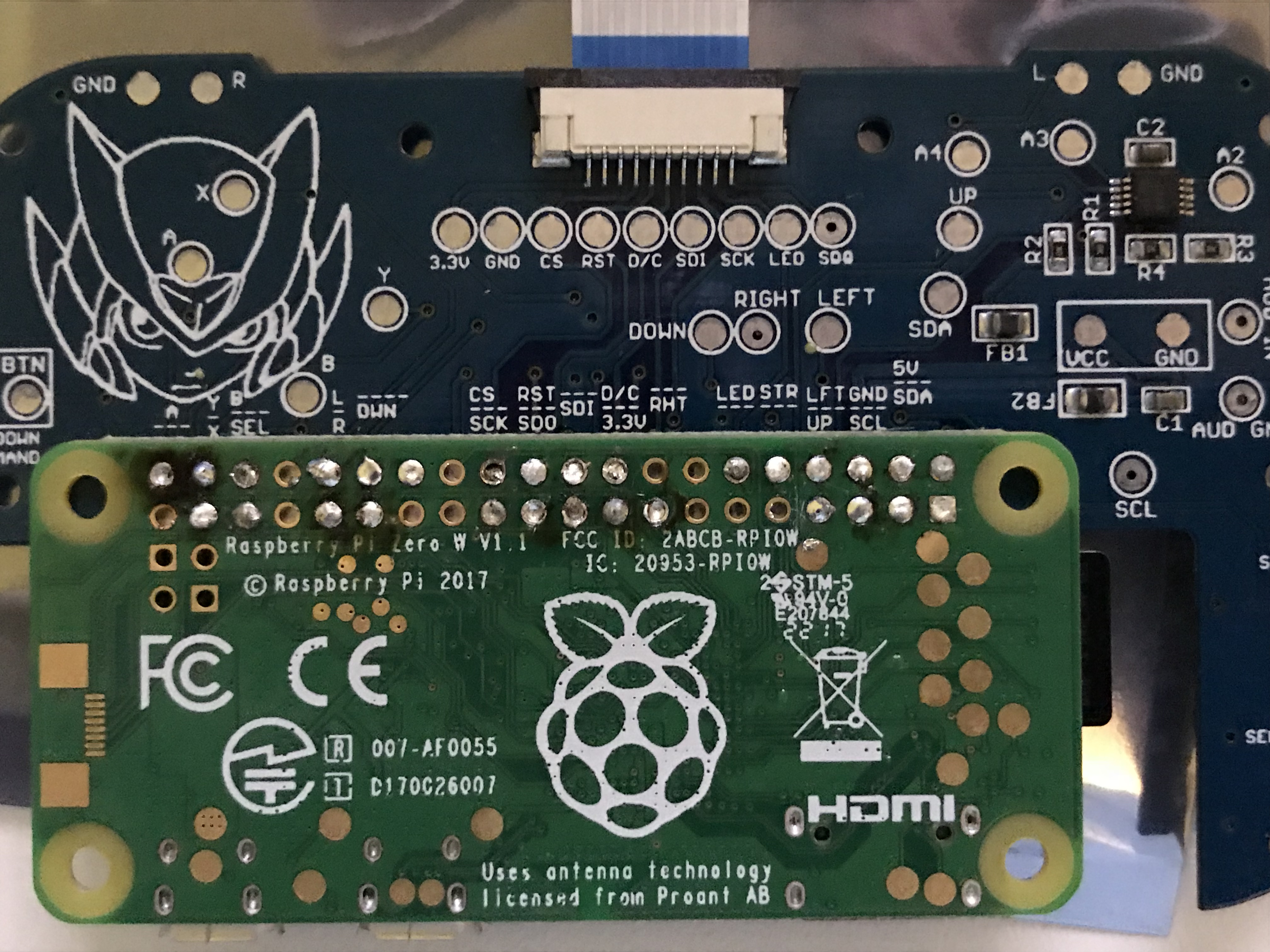

I'm pretty sure you have power grounded. Use a multimeter and test continuity from VCC to any GND pad, if there's continuity there is your problem.

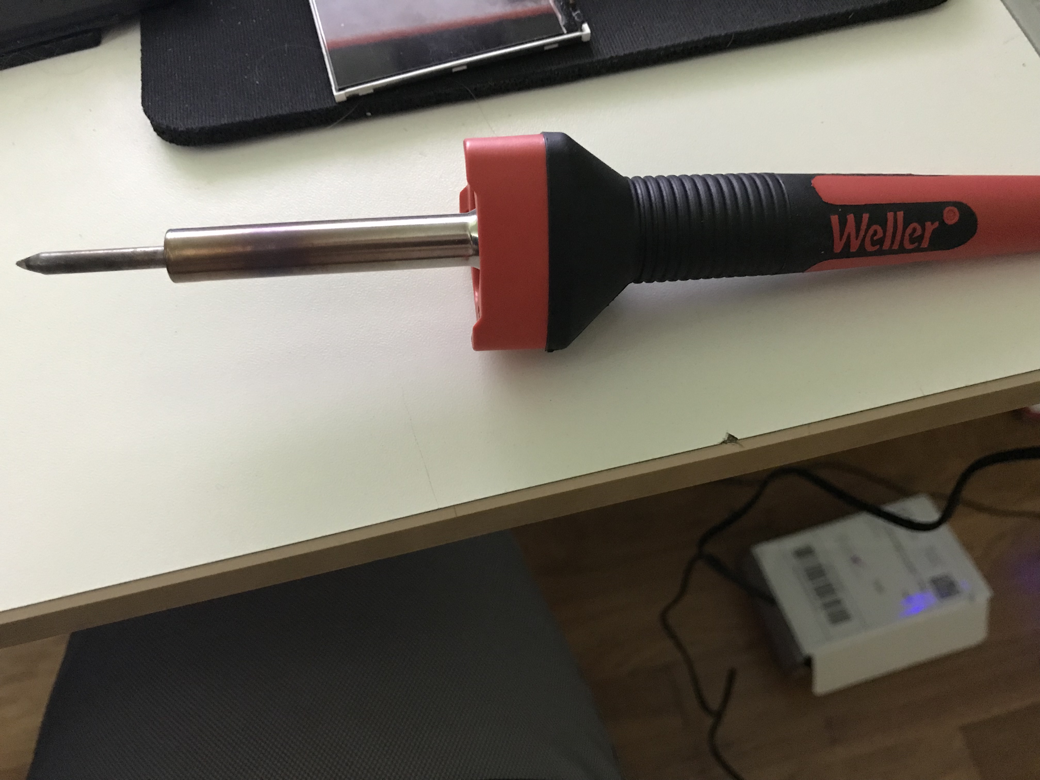

What kind of soldering iron tip are you using? You could've put too much solder on the 5v GPIO and it spread to the GND GPIO to the left of it.

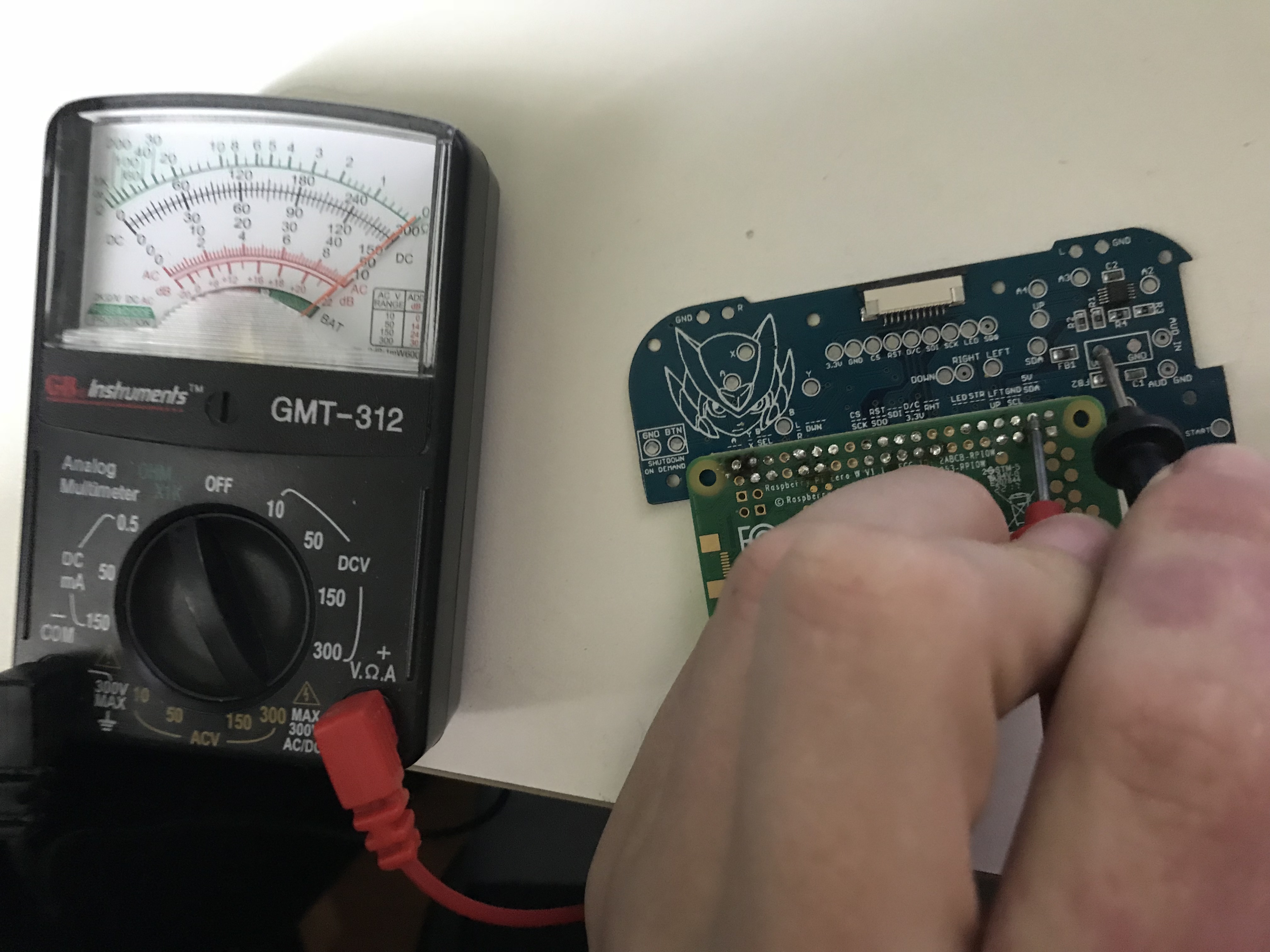

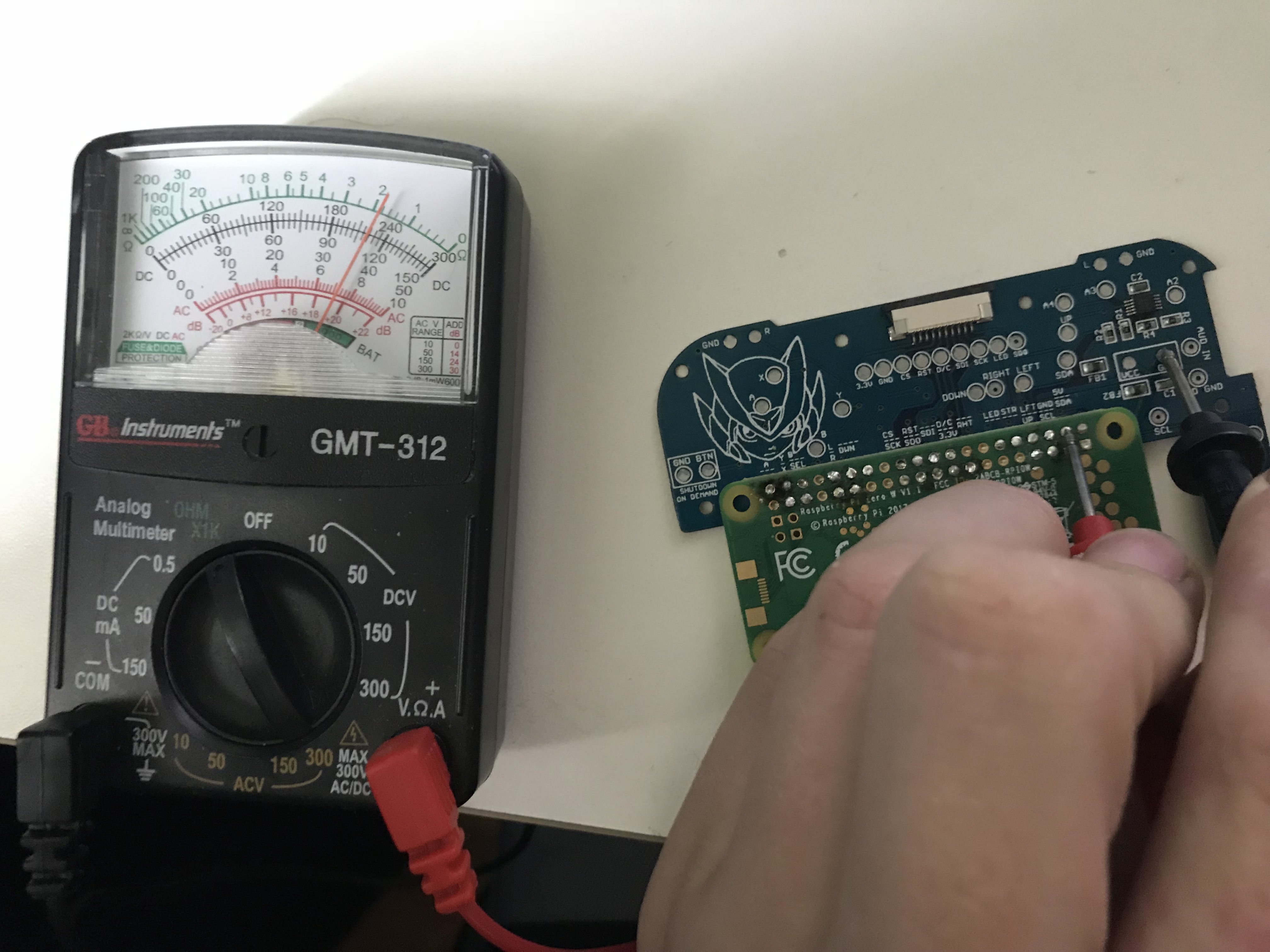

Here's what I've done. I don't have another rasberry pi to test the sd card on, but I did check the continuity between the VCC and GND and I belive theres no continuity between them. I posted pictures of what i did to make sure I tested everything correctly. Also the soldering iron I used is shown here.

It looks like there's some continuity between VCC and GND in that pic, using a digital multimeter is easier to determine this. Test VCC and GND on the controller pcb also, and that iron tip doesn't look like it'll do a good job soldering the Pi to the pcb so again a cheap digital multimeter is best to test these connections.
Harbor Freight has digital multimeters for like $6 have a look at one. And the picture above looks like there's no SD card inserted in the Pi.
