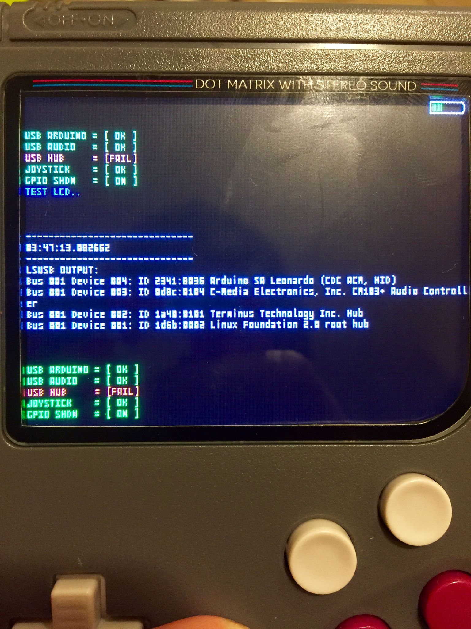

If you put it in TESTER mode (see wiki), what does it pass/fail on?

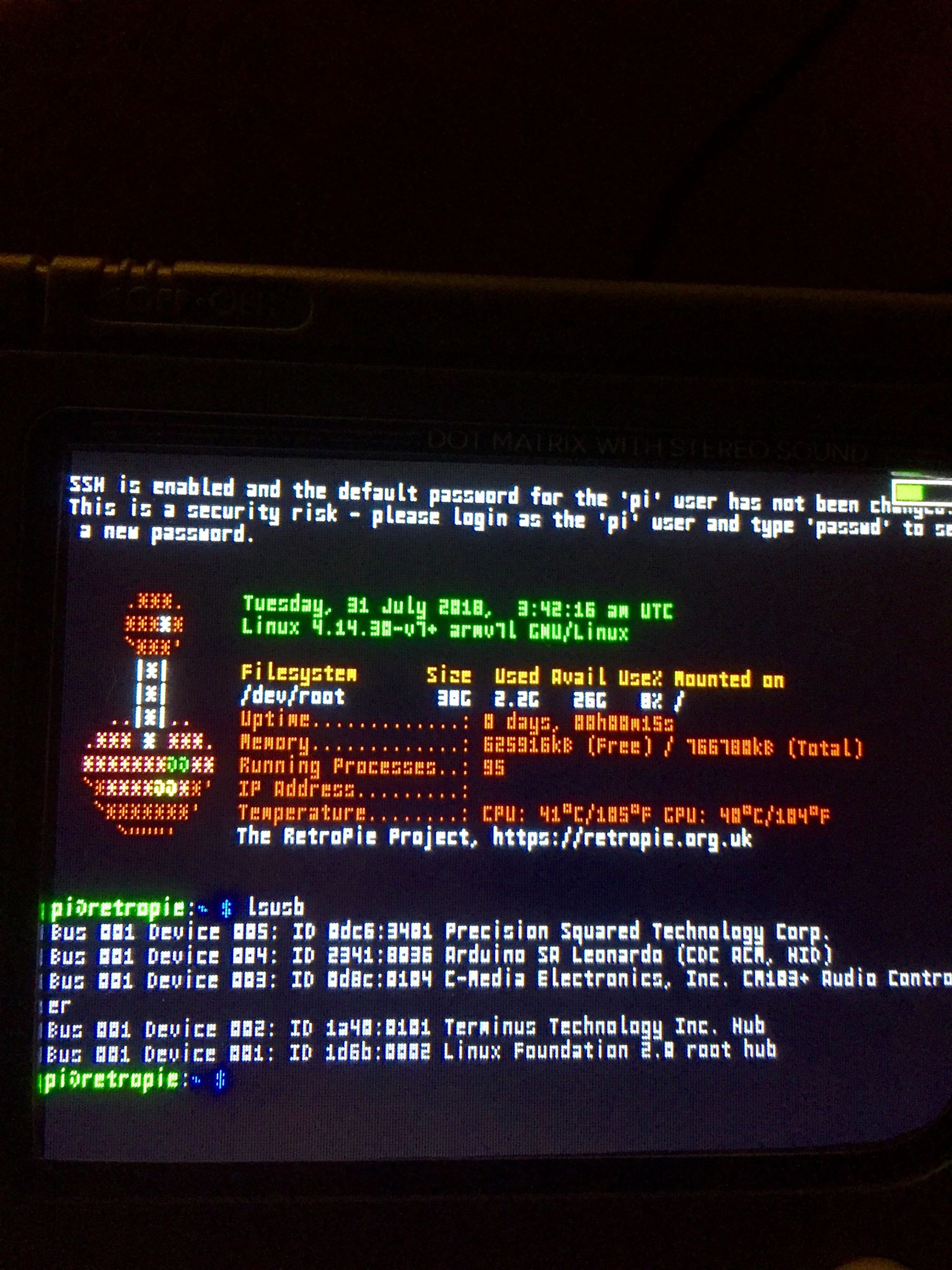

Or if you have SSH access you can run "lsusb" and show the output
Ran it in tester and this is what I got:
Also ran lsusb and this is the result:

Cool that's good (ignore that USB hub fail, i need to fix that..) .. have you tried updating the arduino from the script?

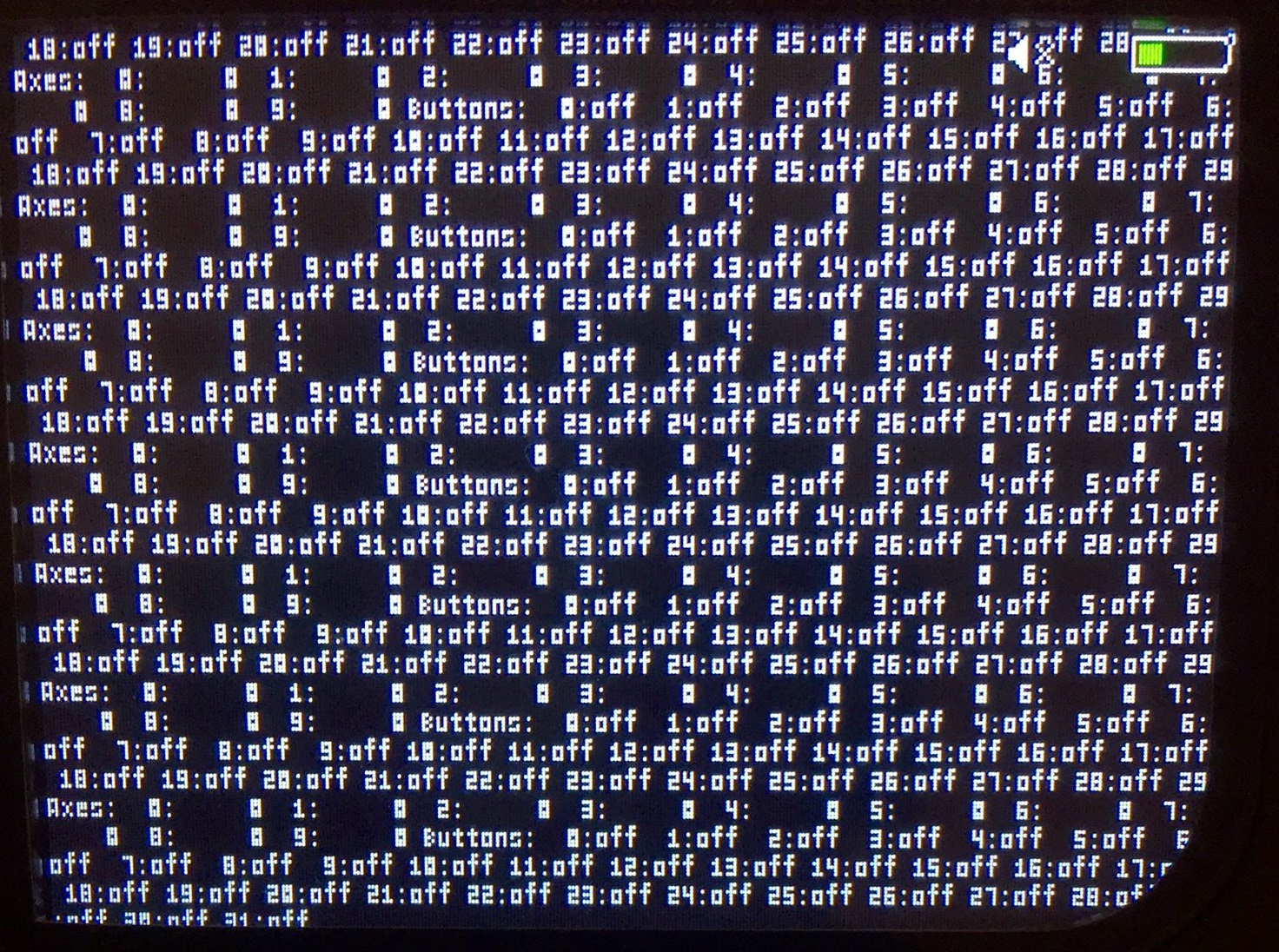

Can you do "ls /dev/input" and "ls /dev/tty*"?
Also "jstest /dev/input/js0" when you press buttons does text on the console appear?

Yeah, I tried updating the arduino via the script and it didnt seem to fix anything. Here's what happened when I the first commands:
and here's when I did the other command. Pressing the buttons didnt make text appear on the screen:

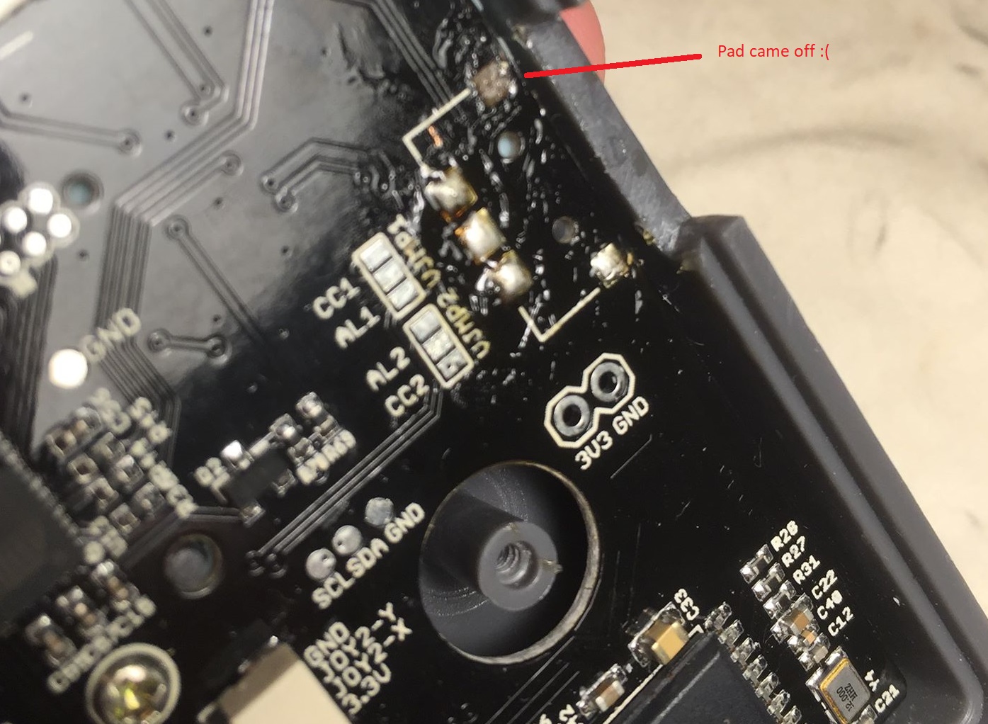

That was it! Thanks for taking your time to help, I really appreciate it :) Now to figure out why the volume rocker still isnt working...I'm going to try to solder on a different one.
EDIT: So during my attempt to remove the previous rocker one of the solder pads came off.....Is there an alternative pad I can solder to?

Ah volume rocker :) ok so luckily for you, that pad isn't connected to anything! It's just there to physically support the switch.. so you could scrape away a bit of the black stuff and solder to that to give a little support..
The reason the rocker isn't working is because you haven't soldered one of those solder jumpers! You should solder bridge the MIDDLE pad (of the three) to the one closest to "AL1" , and the same for the other one of three to "AL2" and it'll now work :)
