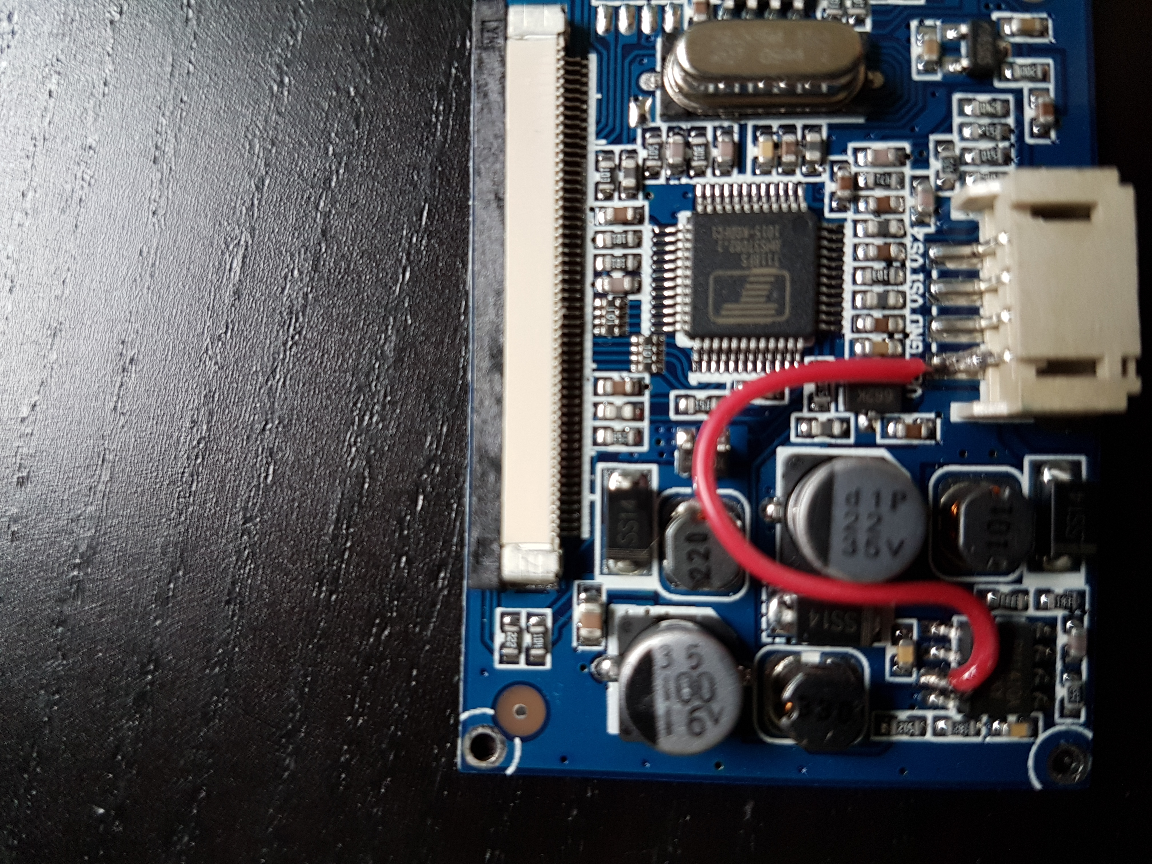

kylewismith wrote:If you purchase the screen in the link I posted I have a spare board for it I will mod it and send it to you free of charge at the weekend
Hey Could i ask if you detail that mod here for folk to attempt at home? Is its to short two points with one wire?
kylewismith
Posts: 34
Joined: Tue Jun 28, 2016 12:44 pm
Re: Wanted: working 3.5" LCD pre-modded to 5V - UK/EU only
Post by kylewismith » Fri Jul 22, 2016 10:38 am
It's the second pin on the left of the black chip to the first pin on the white connector. I used 28 awg wire

Post by kylewismith » Fri Jul 22, 2016 10:41 am
Like this
