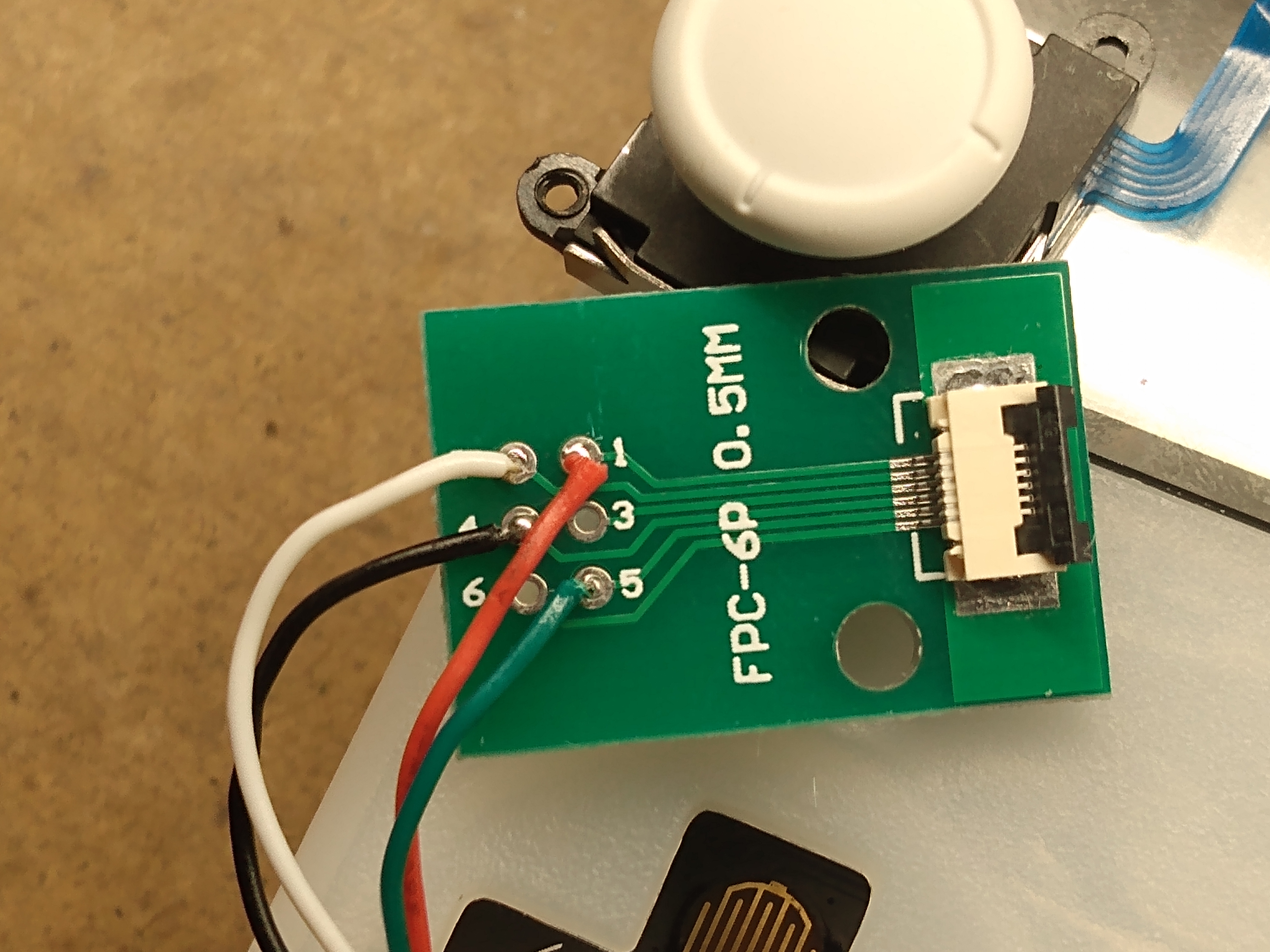

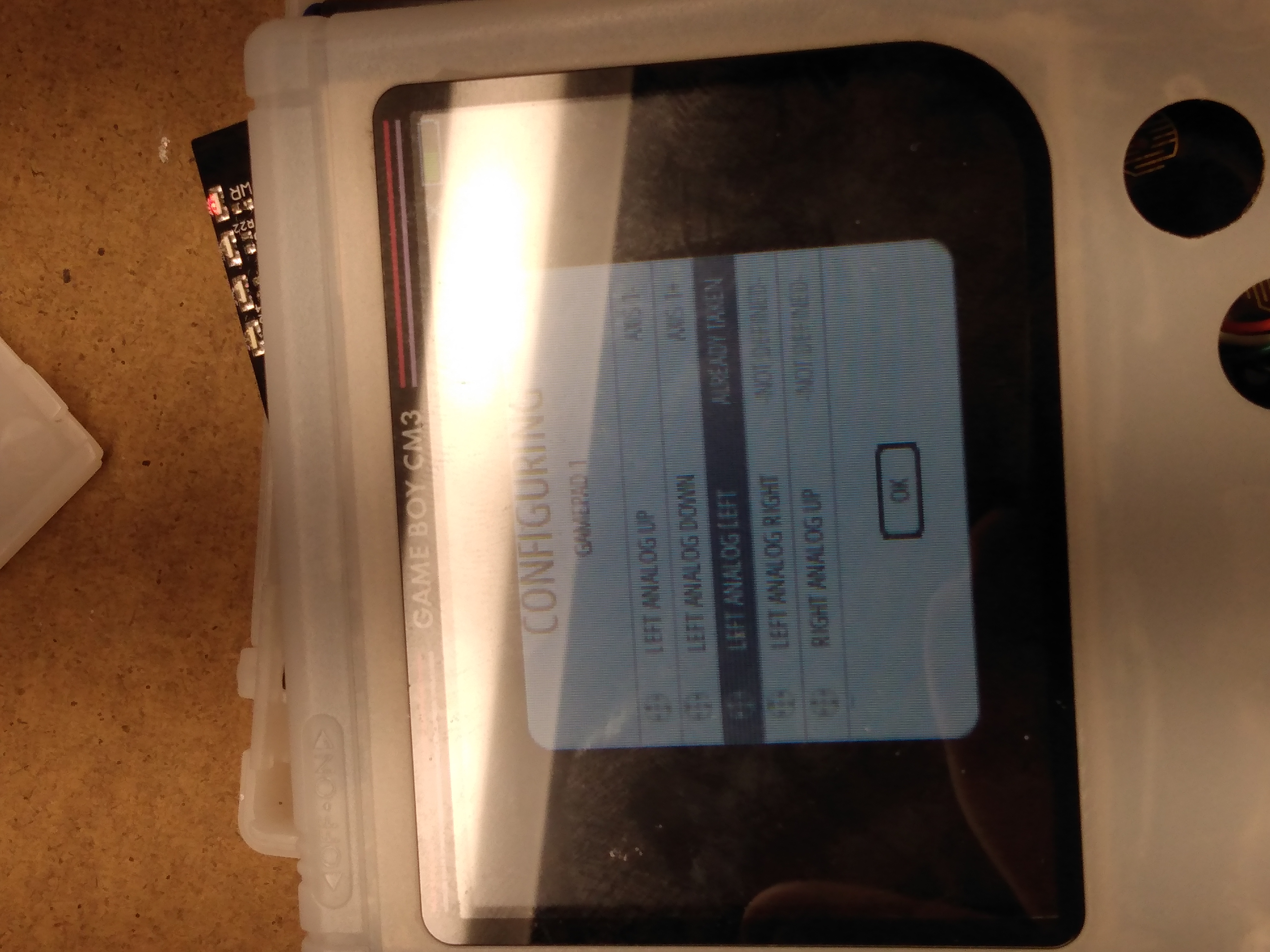

No dice. Still only recognizes 1 & not 0.

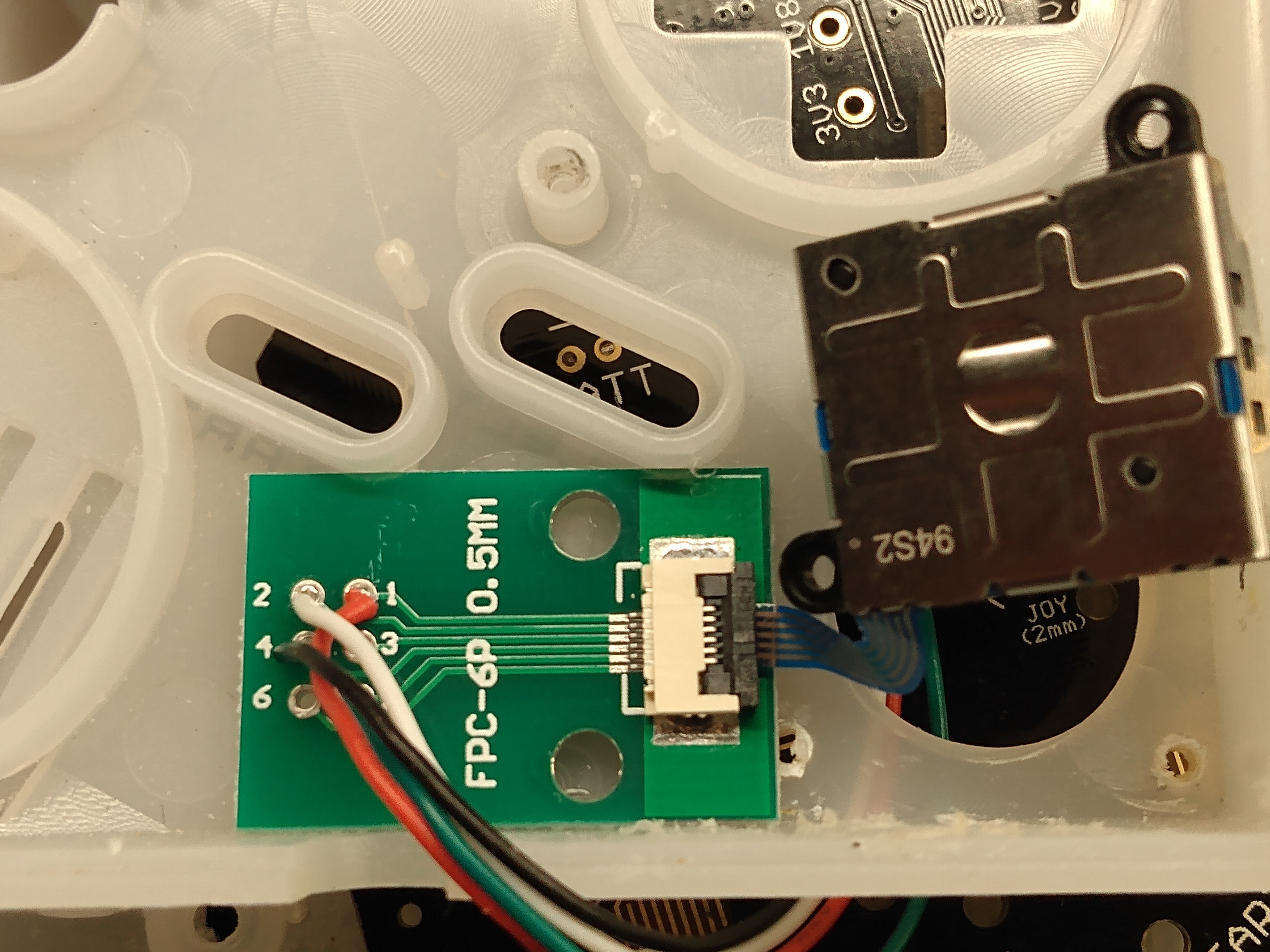

Are you SURE I've got everything wired up correctly?
Should the green be wired to 3?

Yes, green to 5 not 3. 3 is for the joystick button (clicking the stick in). You could wire it as an extra button if you wanted to but it’s not part of kite’s cs wiring and there aren’t any games that need or use it really.
The only thing I can think looking at your pictures is the ribbon cable may be centred in the adapter - it should be pushed all the way to one side, so that the lines in the ribbon align with the 1,2,3,4,5 but not 6 connectors on the adapter. In the photo above the ribbon looks like it needs to go up a little.
I did have some trouble with mine after fitting and refitting it multiple times - I had twisted and eventually damaged the ribbon cable from all the abuse I gave it, might be worth checking it though it looks fine in your pics.
