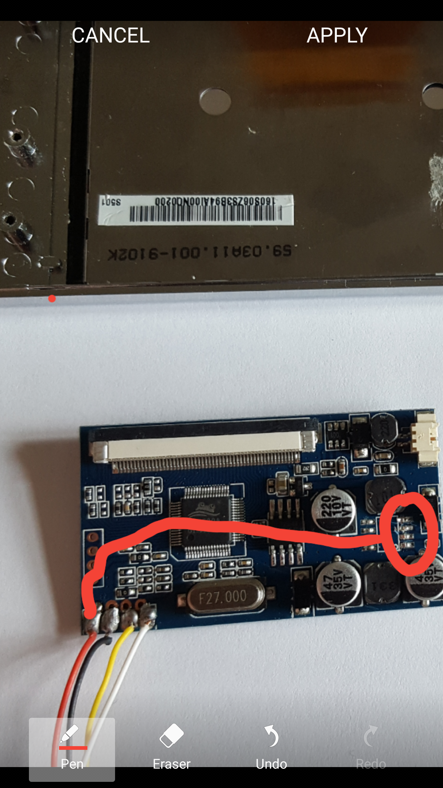

I finally got the regulator chip off and then tried to solder to the 5v pad on the back and apparently melted to pad off. Did I ruin any hopes of using this board?

Jpayne30 wrote:I finally got the regulator chip off and then tried to solder to the 5v pad on the back and apparently melted to pad off. Did I ruin any hopes of using this board?
How hot did you have the soldering iron on. Don't worry I think there's two way round you can hopefully scratch off the area just before the pad and solder to that which will be abit hard to do or the pad is linked to one of the pinouts on the regulator I think it's pin 2 I can't remember it was a long time since I tested the board. But you can solder to that instead which by the sounds of it that's what i would Do in this case. The only reason I use the pad on the back was it was easier to do. It's the same pin out as before.
Hopefully you not damaged anything else please let me know how u get on and keep the temperature low.

From memory it's one of these pins going to the input 5v I can't be sure which pin cuz I can't find any good pictures from before this.

Post by Jpayne30 » Mon Oct 10, 2016 3:04 pm
Thank you a billion times over.. Screen is in working order. For anyone else wondering it was the second pin from the tip on the right side where he circled. Thank you Soooooo much
