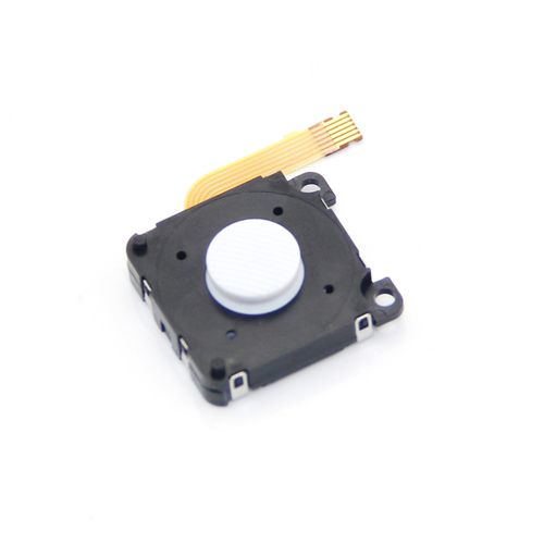

the psp Go has an even smaller and thinner stick (i think). the psvita as well http://www.dx.com/p/replacement-analog- ... 3no4fkkq70

skrapps914 wrote:the psp Go has an even smaller and thinner stick (i think). the psvita as well http://www.dx.com/p/replacement-analog- ... 3no4fkkq70
the arduino im using only has a certain number of pins so the psp-1000 one is ideal since it only uses 2 as far as actual data so if there is a psp thumbstick whatever the version that matches this:
then it would probably be possible for it to also work.

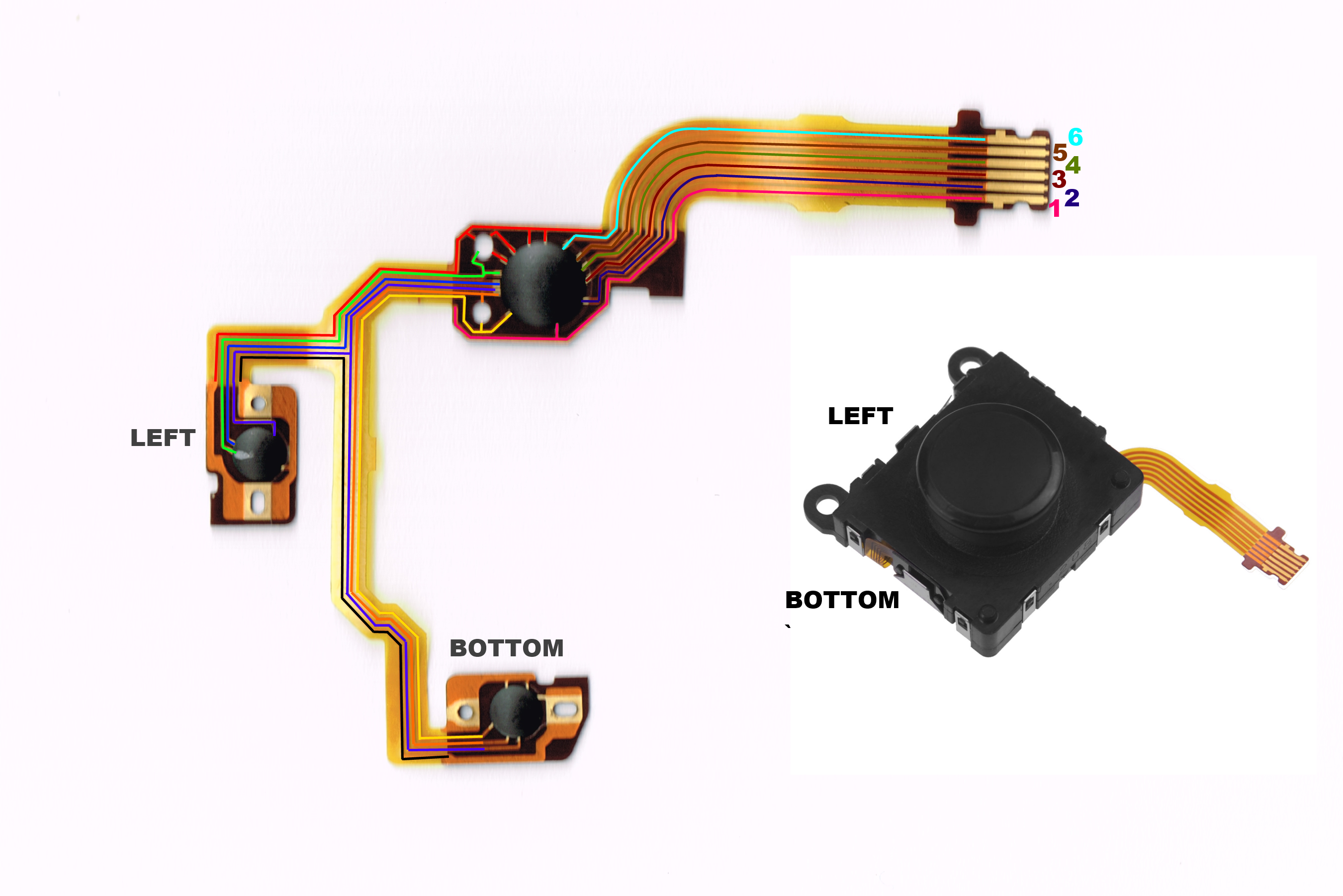

i think the others are the same way, just extended through the ribbon

skrapps914 wrote:i think the others are the same way, just extended through the ribbon
Count the traces on the ribbon cable.
sometimes traces can be misleading. heres a diagram it appears that 2 wires are bridges of some sort. and could possibly be directly connected from point to point, leaving you with 4 wires to solder to the pad

skrapps914 wrote:
Fair enough and thanks for the clarification :)
But you still have to find out which 2 traces to ignore, so the 4 pad one would be easier.
Also, ribbon cables are not that sturdy and easy to solder on. But still you are right about it likely only having 4 real traces.
