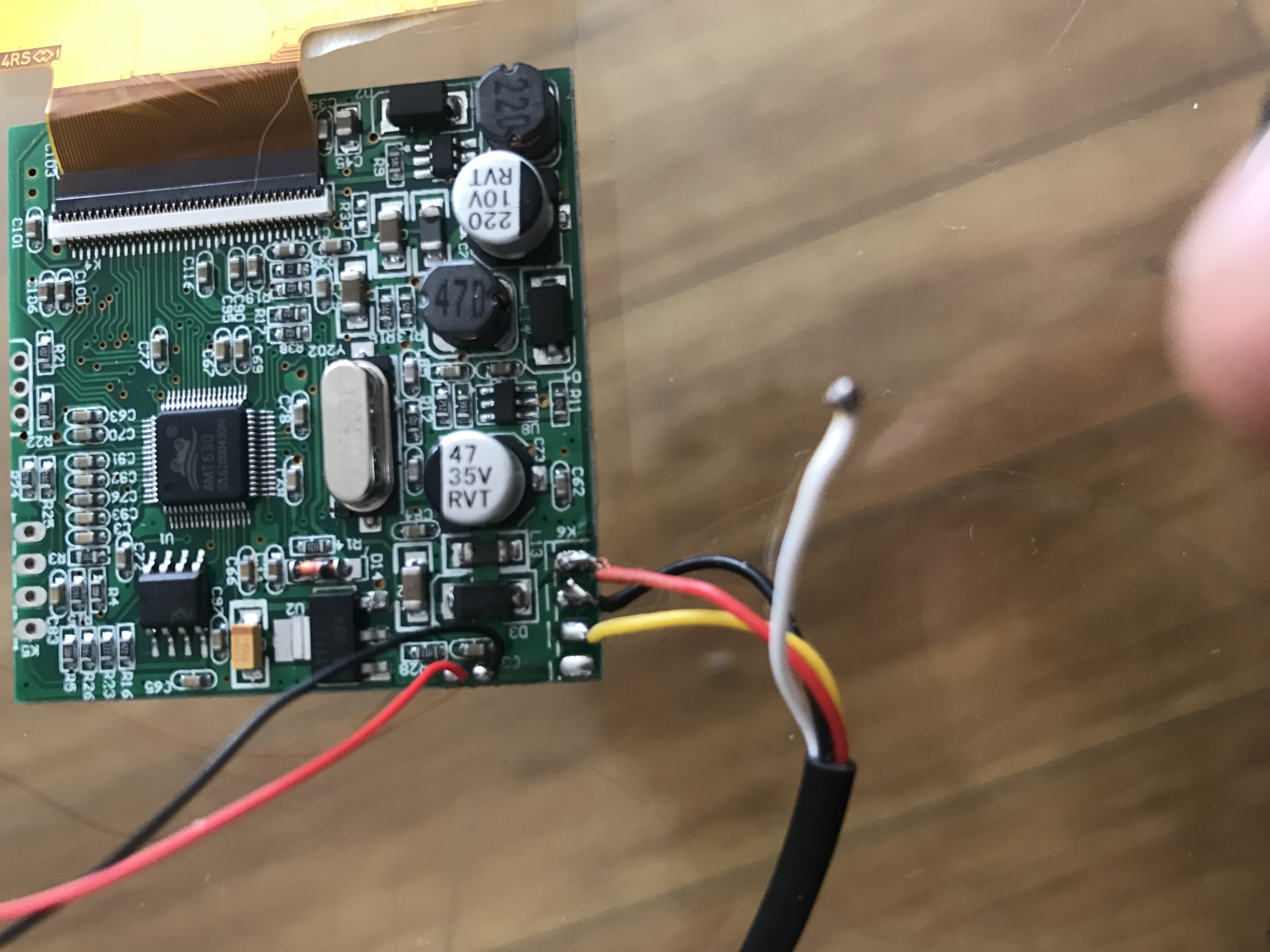

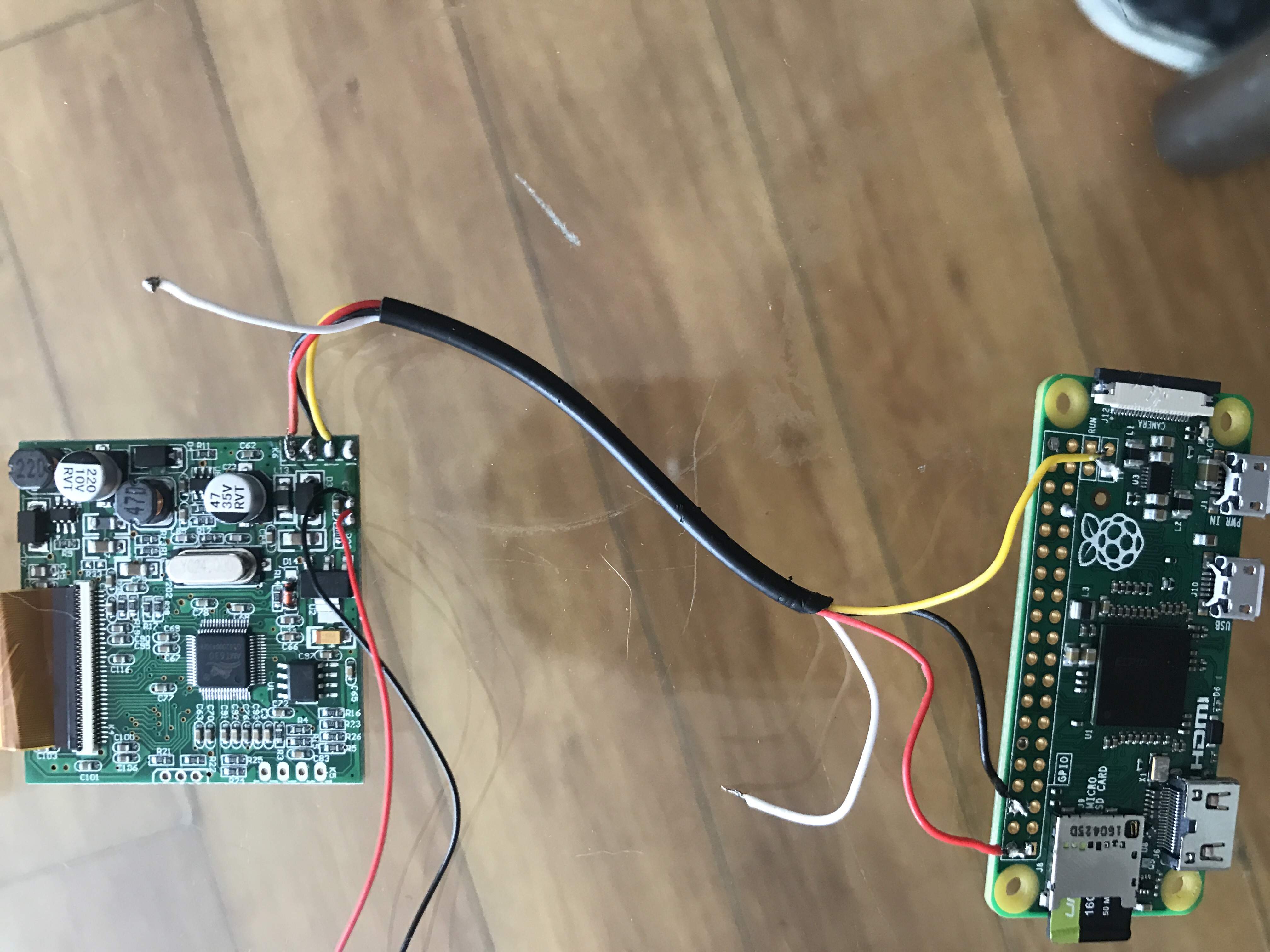

fcib wrote:Not sure if the yellow and white cable are for the yellow and white wire, but you only need one when soldering to the pi.
It might be switching between av1/av2 constantly? Try just using one.
As in just unplug one, or desolder? Not sure it matters. I'll try this later, thank you!

Well I cut the composite plugs off right away and tested with my pi.
You only need the yellow OR white wire when it's soldered.
If both composite plugs are used (and assuming they each match one of the wires) then you have both channels plugged in at once.

Not exactly yet, but this may be onto something. It makes sense since the screen flickers so slowly, as if it is changing aux channels.
I plugged it all in and noticed that the white doesn't do anything. When the yellow is plugged in, I get the flicker, so it's definitely using only the yellow cable. That narrows it, but I still can't get it stable.
When I was going to turn it all off, I noticed that the soldering on the other cables was really weak, and they actually came off when I grazed over them to check them out. Perhaps the flicker is from weak connections?
It's 1am where I'm at, so I'll re solder the connections when I get up and update. Thanks for sticking with me to solve this! Sorry your screen isn't working :/

I finally got it to work without flickering. Thanks to user TimBer, I found out that instead of using a jumper wire, wiring the red line directly to the 5v regulator was the way to go. Just wanted to update for closure and in case you ever come across this screen again ;P

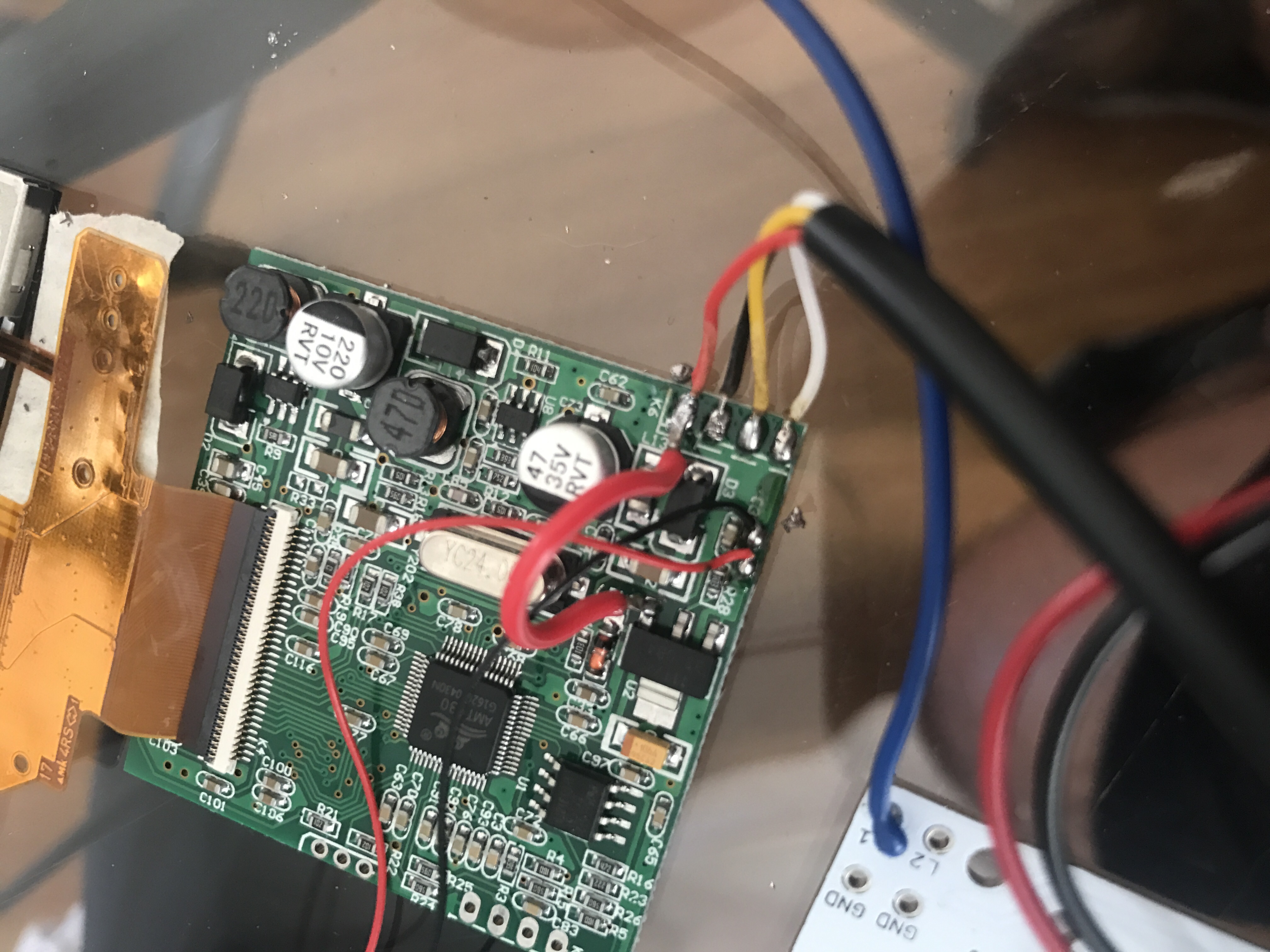

Thi la is what you mean ? I'm still not getting anything

Post by mike_louisxvi » Mon Mar 13, 2017 5:39 pm
Brandonmel wrote:Thi la is what you mean ? I'm still not getting anything
Not quite
You can have a look at this thread: http://www.sudomod.com/forum/viewtopic. ... &start=430
Scroll down to the second post (mine, check the username) if you want to see what I mean.
Basically you have to take the red wire running from the cable and solder it onto the regulator leg as shown there. Mine didnt come with the buttons like yours seems to have, but I don't think (or know, really) if that would have anything to do with your issues.
